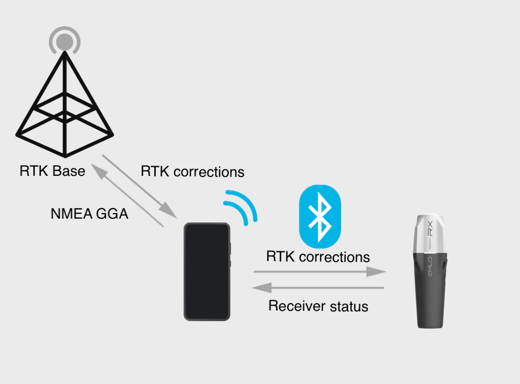

When working with Reach RX2, mobile apps and data collectors act as an NTRIP clients, passing the correction feed to the receiver via Bluetooth. The apps act as a bridge that passes corrections from a network connection to a Bluetooth connection.
NMEA feedback​
In many cases, NTRIP casters require the approximate position of the rover to function. They may need the position to automatically determine the appropriate base station or for VRS operation. This is achieved by sending the approximate position of your rover (usually the SINGLE solution) as an NMEA GGA string to the caster after the connection is established. In the case of Reach RX2, this is done by the mobile application as well.
NMEA GGA messages can be formed by using the receiver's status information that includes the position coordinates.

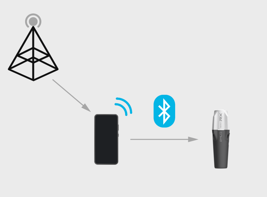

Emlid Flow for iOS supports sending corrections in the background. The user can configure corrections in Emlid Flow and proceed working in your app. Using Emlid Flow for corrections is free and available to all integrators.
