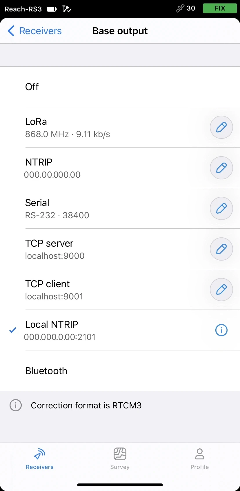

  3. Tap Base output and select the Local NTRIP option.
  4. Tap the Information button to access the page with the rover credentials.

  5. On the Receivers screen, tap Base output and select the NTRIP option.
  6. Tap the Edit button and insert the NTRIP credentials for the base:
