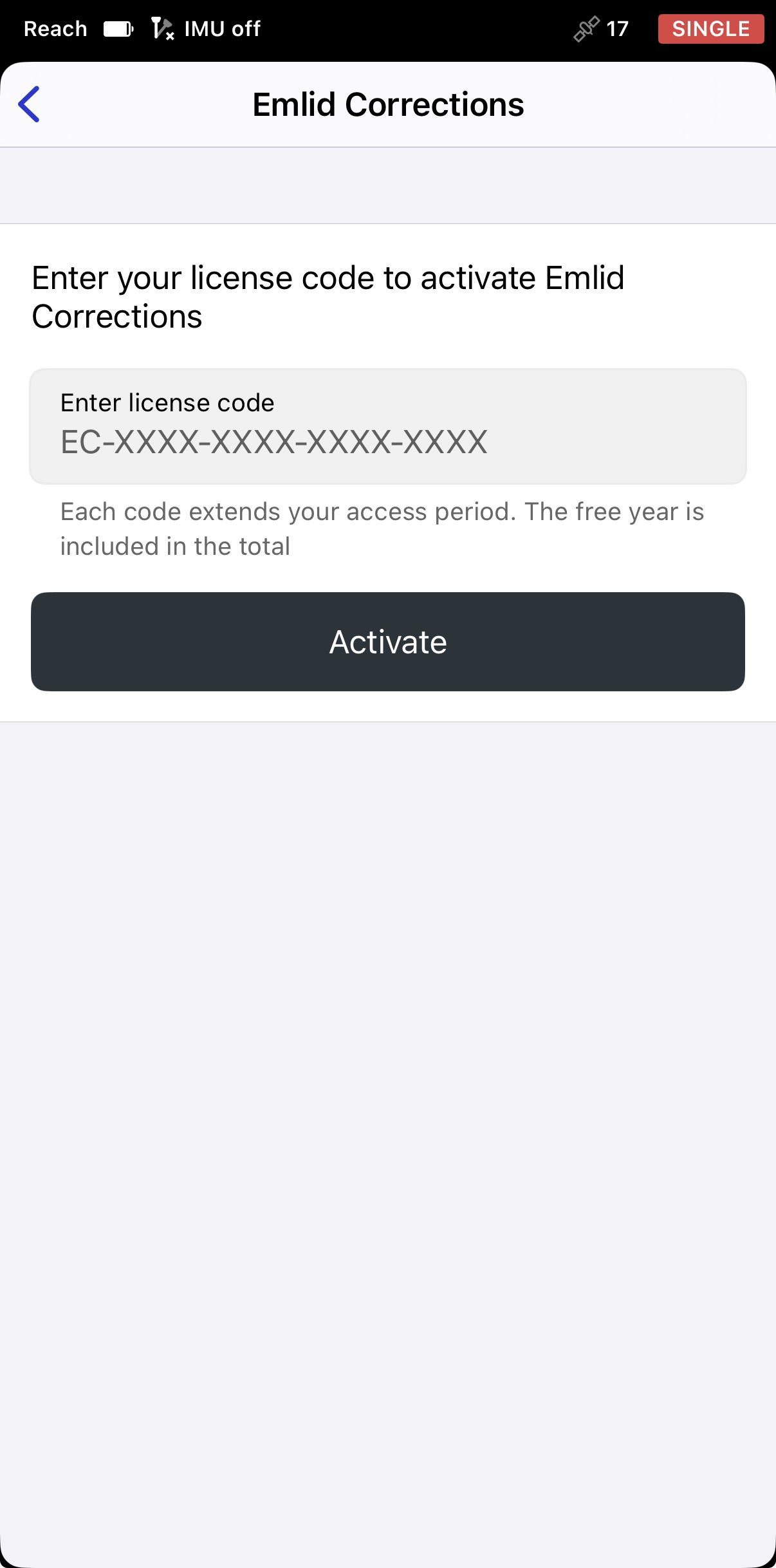

If you purchased a Reach receiver bundled with Emlid Corrections, you'll receive a license code. Activating the license also automatically applies the included free one-year subscription to the same receiver. To activate the license code, do as follows:
  1. Open Emlid Flow and connect to your Reach receiver via BLE.

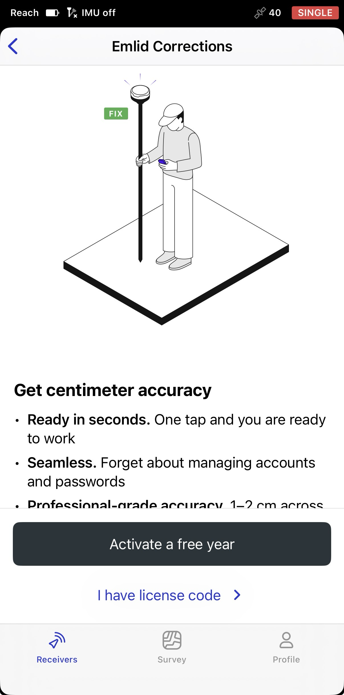

  2. On the screen that opens after connecting, tap Activate now to start using Emlid Corrections.

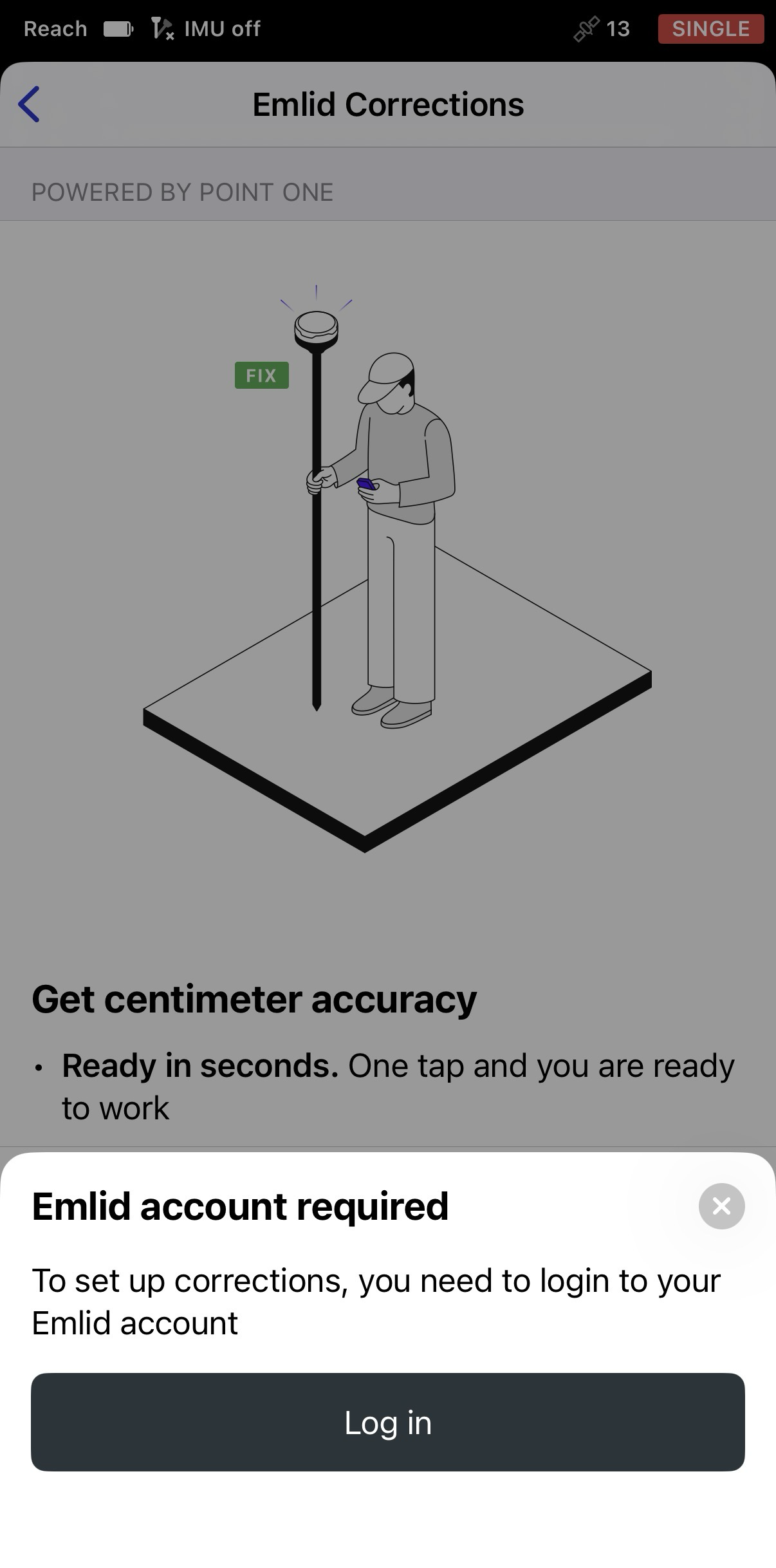

  3. If you haven’t signed in to your Emlid account, sign in now.
  4. After that, tap I have a license code.

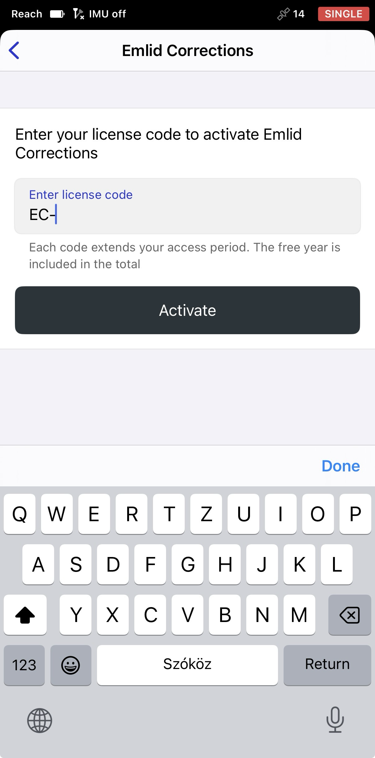

  5. Tap Enter license code.

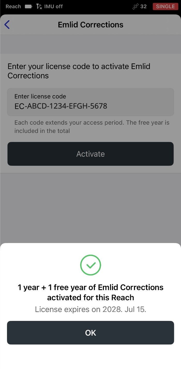

  6. Enter the license code and then tap Activate.
    Once activation is complete, you'll see the subscription expiration date. The included free one-year subscription is automatically combined with the subscription from your license code.
  7. Tap OK. The Emlid Corrections screen will now show you the information on your license details.

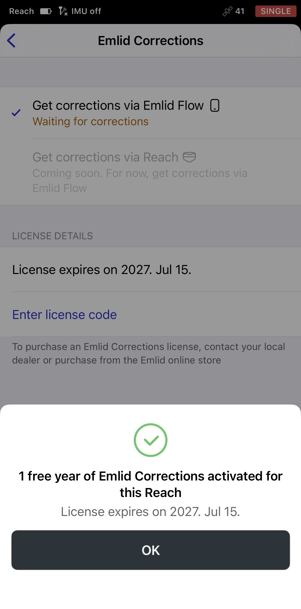

Every compatible Reach receiver includes a free one-year subscription to Emlid Corrections. Activate it in Emlid Flow to start using the service:
  1. Open Emlid Flow and connect to your Reach receiver via Bluetooth (BLE).
  2. On the screen that opens after connecting, tap Activate now to start using Emlid Corrections. If you didn’t log in to your Emlid account, do it now.
  4. After that, tap Activate a free year to start using Emlid Corrections.
  5. Tap Activate a free year. The free one-year subscription is tied to the receiver on which it is activated and cannot be transferred to another Reach receiver. Once activation is complete, you'll see the subscription expiration date.
  6. Tap OK, and you’ll see the Emlid Corrections screen.

If you purchase an Emlid Corrections license code from the Emlid Store or your local dealer after activating the free period, enter the code in Emlid Flow as follows:

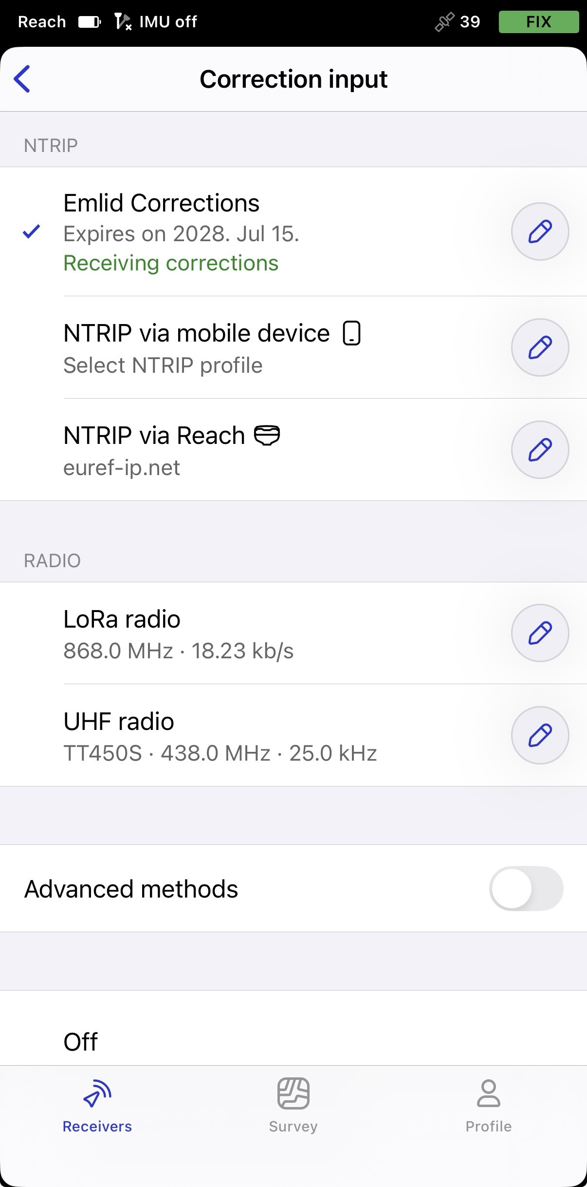

  1. In Settings, tap Correction input, and then Emlid corrections.
  2. Near the Emlid corrections cell, tap the pencil icon.

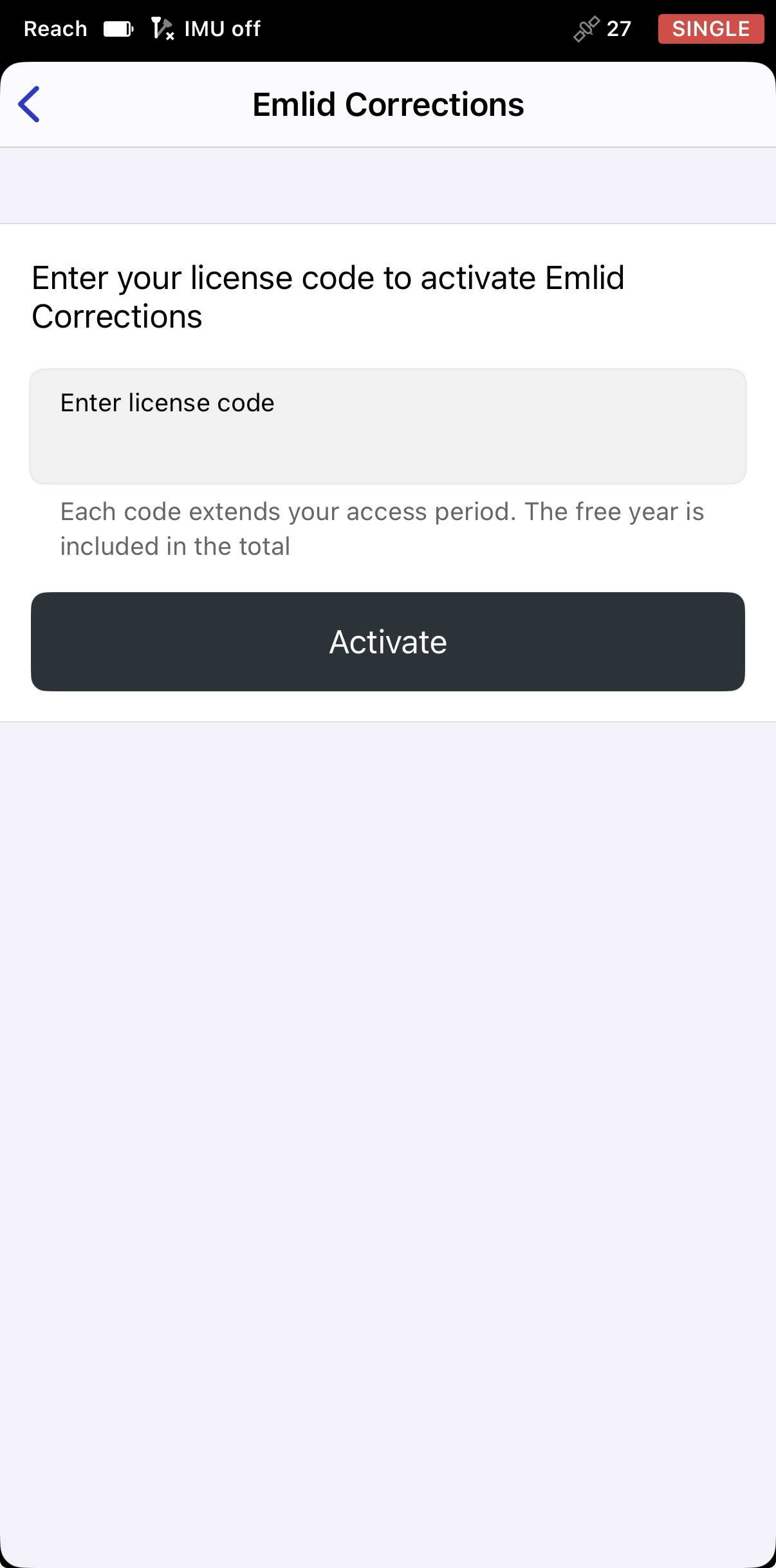

  3. On the opened screen, tap Enter license code section.
  4. Enter the obtained code. The purchased subscription will be added to the remaining free period, and the updated expiration date is displayed.
The license code is now applied, and the purchased license period is added to your existing Emlid Corrections period.

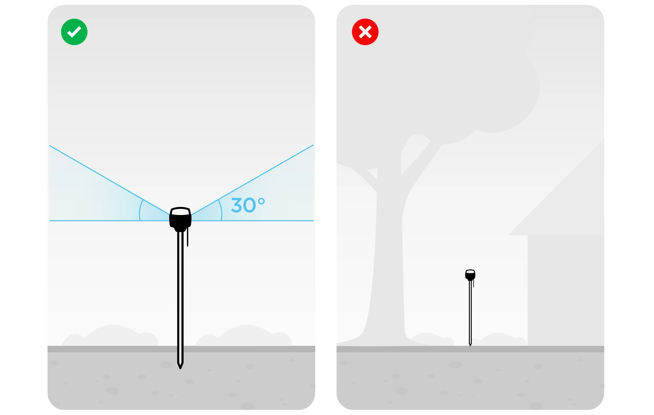

Provide Reach RS3 with clear sky view​
Before surveying, make sure your Reach has a clear sky view of at least 30 degrees above the horizon. There should be no obstacles that could block the view like buildings, trees, cars, people, laptops, etc.
Learn more about Reach setup in the Placement guide.
Once the receiver has a clear sky view and satellite visibility, corrections will start within a few seconds.

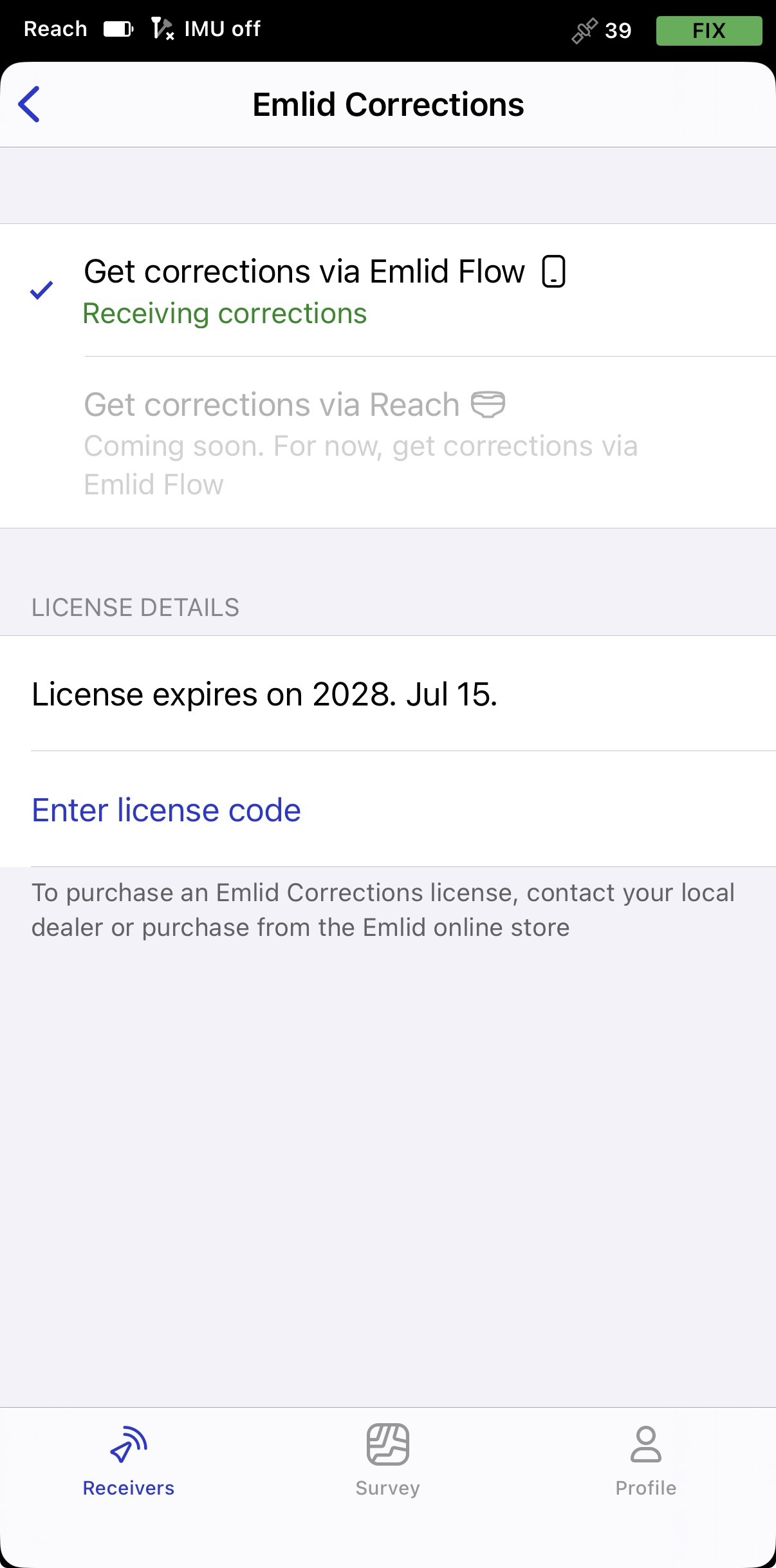

View results​
When you have completed your RTK setup over Emlid Corrections, you can see the current solution status in the top right corner of the Emlid Flow app:
  • SINGLE means that the rover has found a solution relying on its own receiver and base corrections are not applied. Precision in standalone mode is usually at the several-meter level.
  • FLOAT means that the rover receives the base station's observation data and position but cannot resolve ambiguities needed to calculate its position with centimeter-level accuracy. In this case, the positioning accuracy can vary from a few centimeters to about 1 meter.
  • FIX means that the rover using corrections from the base resolved the ambiguities in its positional calculation and achieved the solution with the centimeter-level precision.
After a short period of time, the rover gets a fixed solution. In good environments, it will take a few seconds to get a fixed solution. In tough conditions, it may take a little longer. Once the rover gets FIX, you are all set for surveying.
