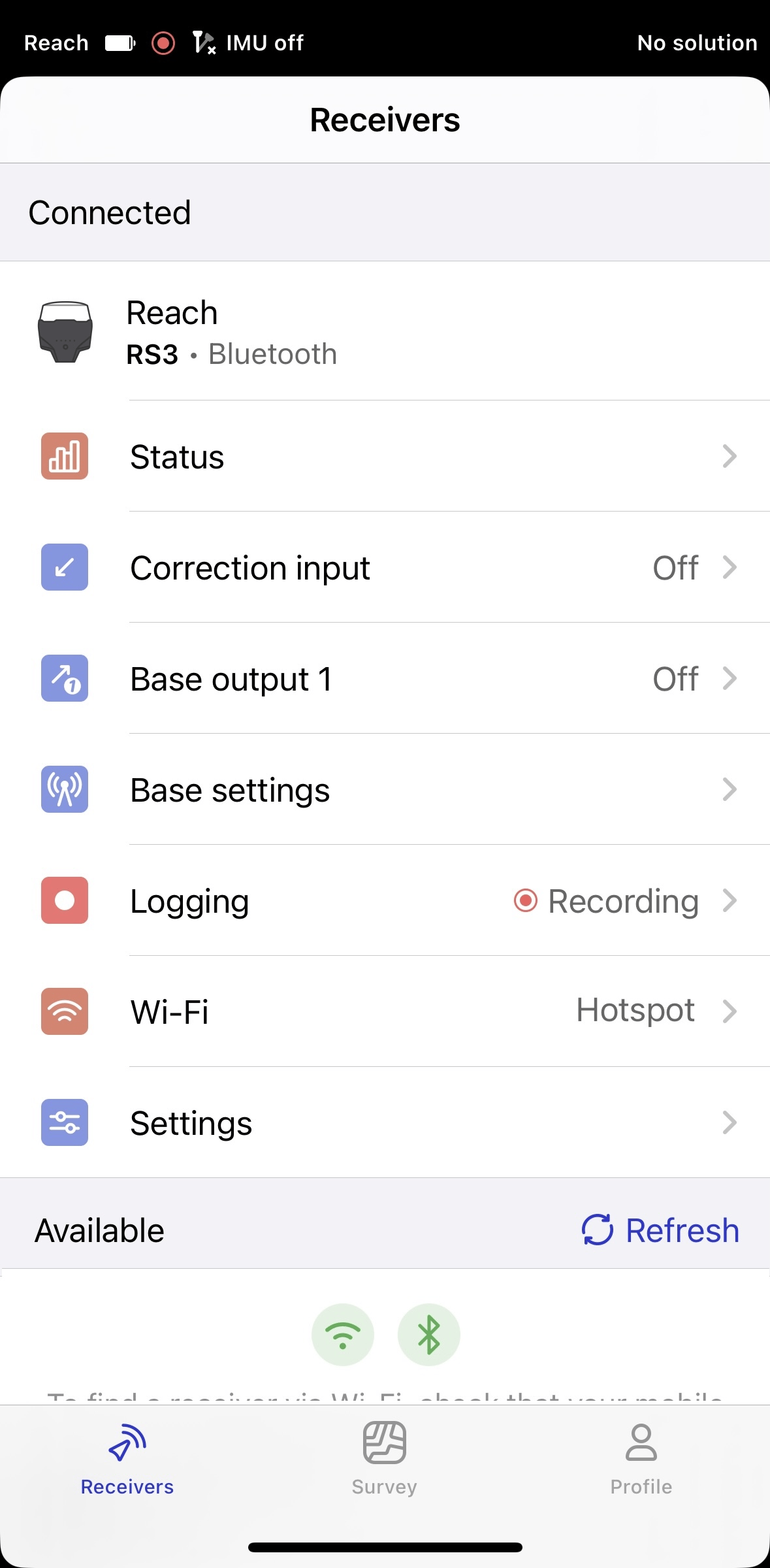

After granting permissions, your receiver will appear in the list. The app will connect to it automatically.
If you have multiple Reach receivers, tap the one you want to connect to and wait for the connection to complete.

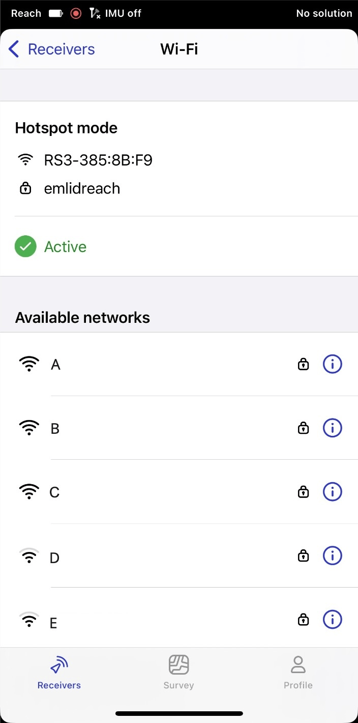

On the Receivers screen, tap Wi-Fi.
Choose your Wi-Fi network from the list.

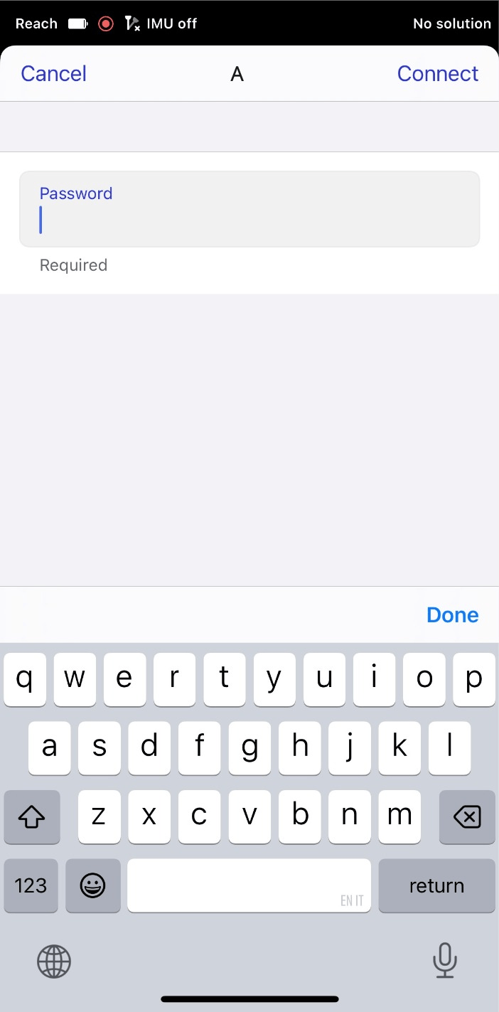

Fill in the password for the selected network.
noteDouble-check if you entered the password correctly.
Tap the Connect button. The Network LED will start blinking blue. It means that Reach is trying to connect to your network.

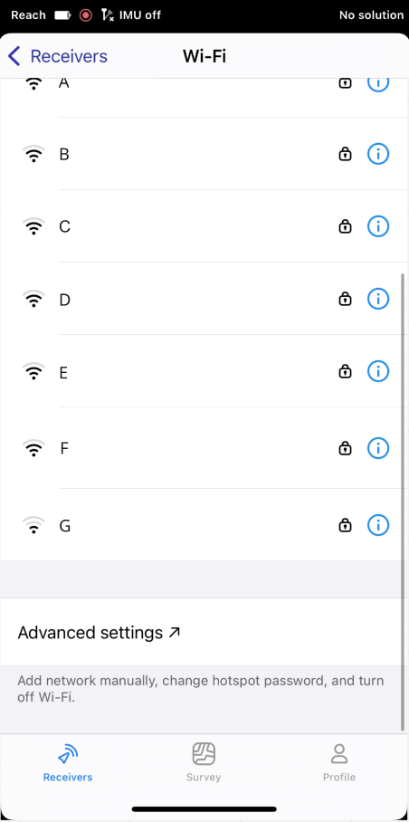

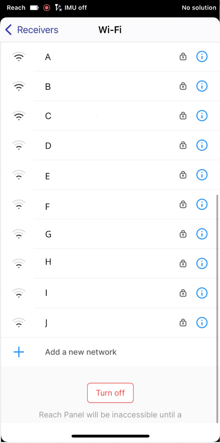

On the Receivers screen, tap Wi-Fi, then Advanced settings.
Tap Add a new network. As your device's mobile hotspot has been temporarily disabled, its network is not visible.
