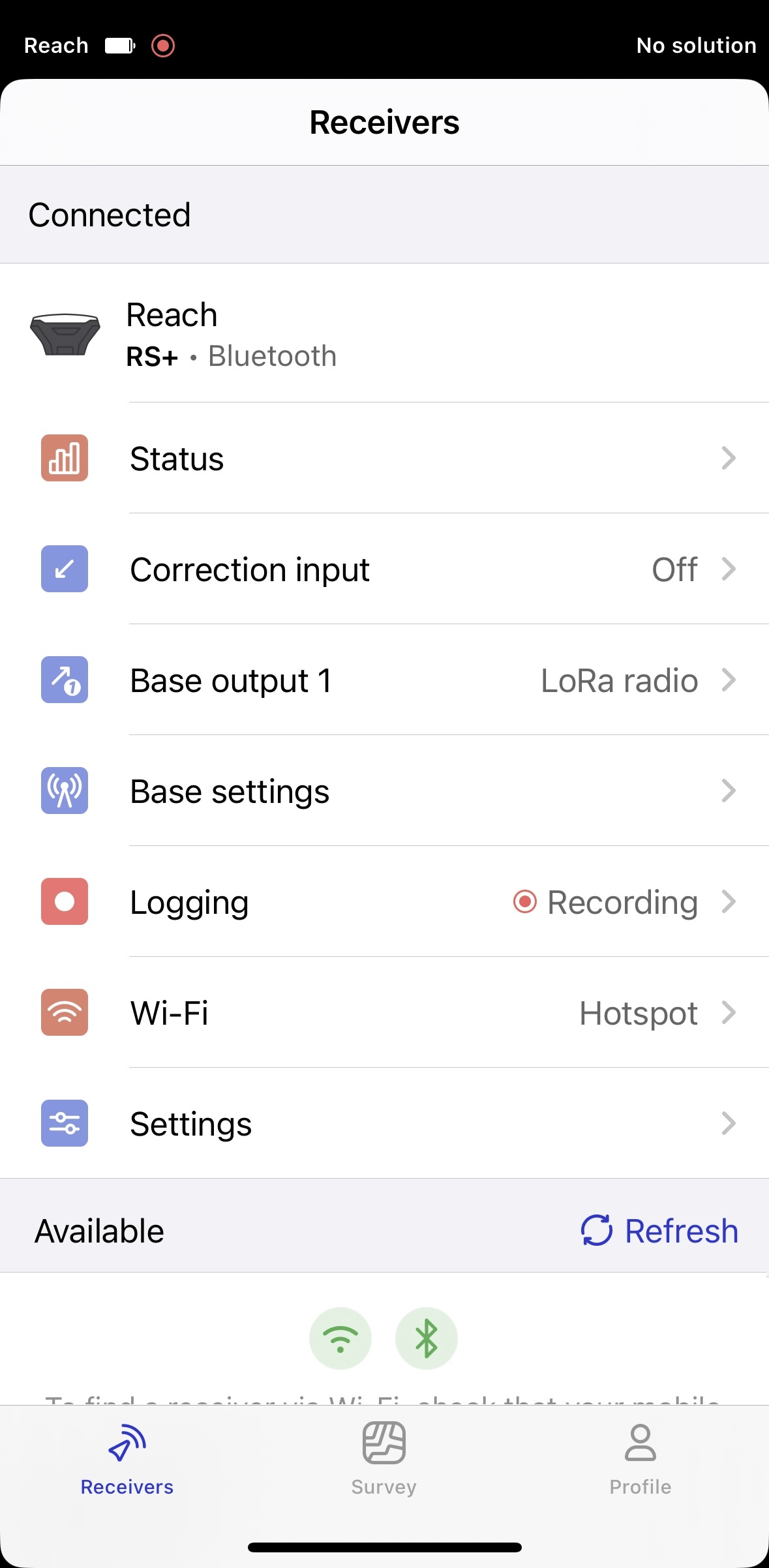

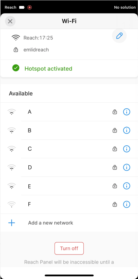

On the Receivers screen, tap Wi-Fi.
Choose your Wi-Fi network from the list.

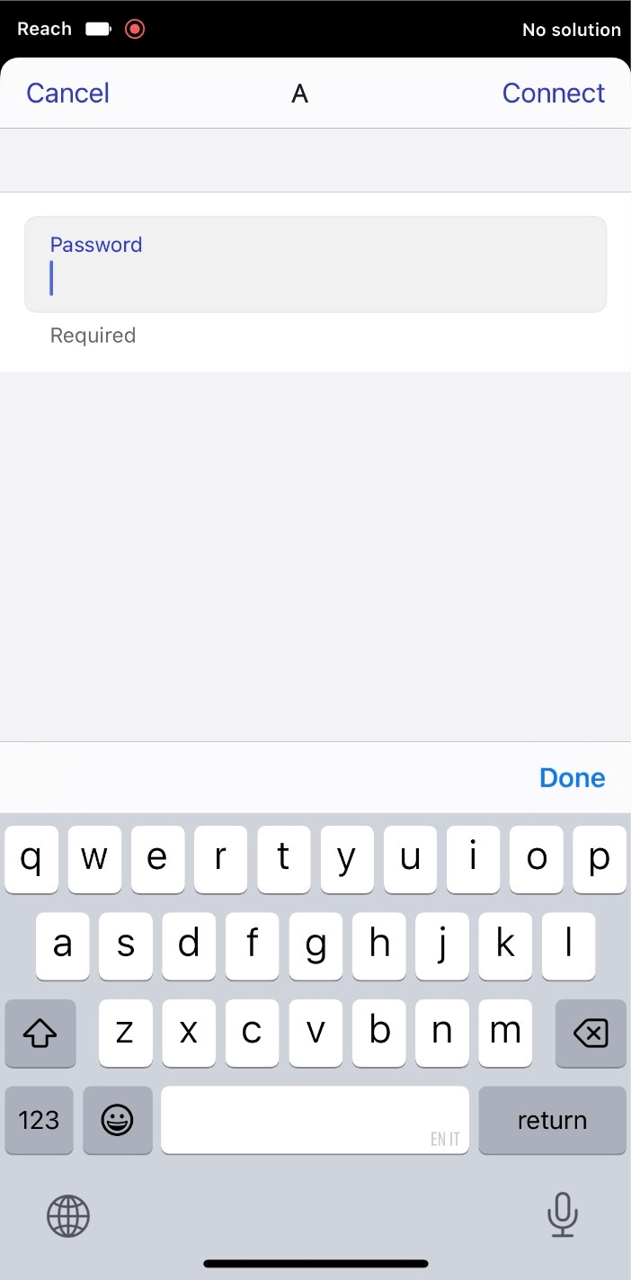

Fill in the password for the selected network.
noteDouble-check if you entered the password correctly.
Tap the Connect button. The Network LED will start blinking blue. It means that Reach is trying to connect to your network.

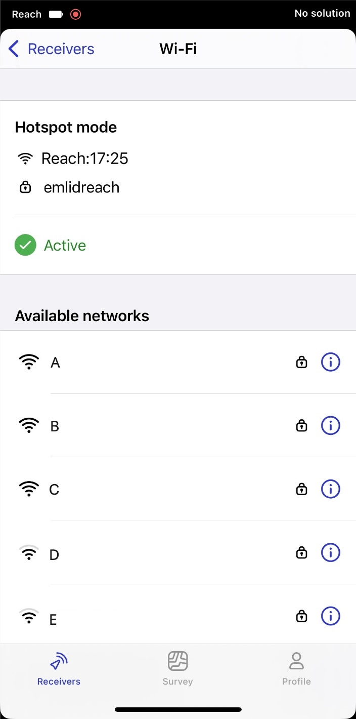

Go to Wi-Fi settings on your device.
Connect to the Reach hotspot. It appears as reach:XX:XX.
Enter the network password. The default password is emlidreach. If you changed it previously, enter your custom password instead.

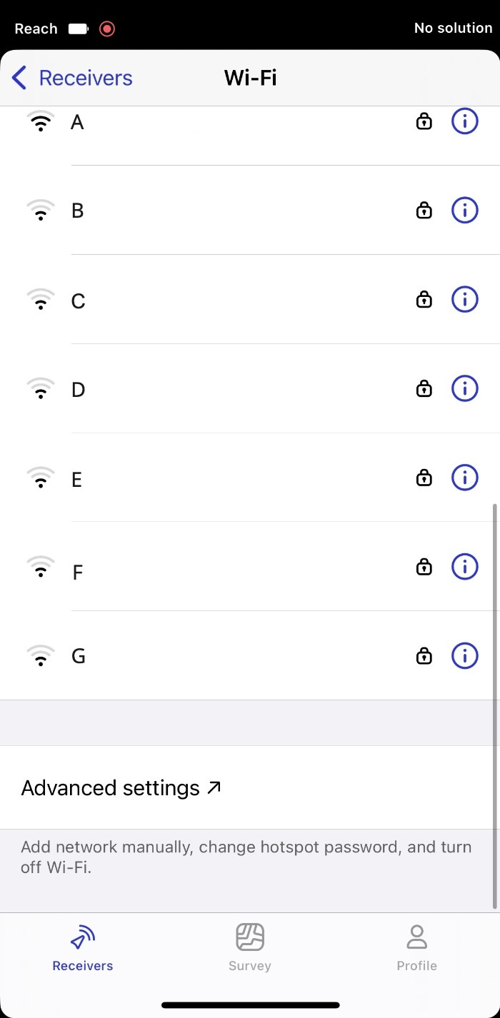

On the Receivers screen, tap Wi-Fi, then Advanced settings.
Tap Add a new network. As your device's mobile hotspot has been temporarily disabled, its network is not visible.
