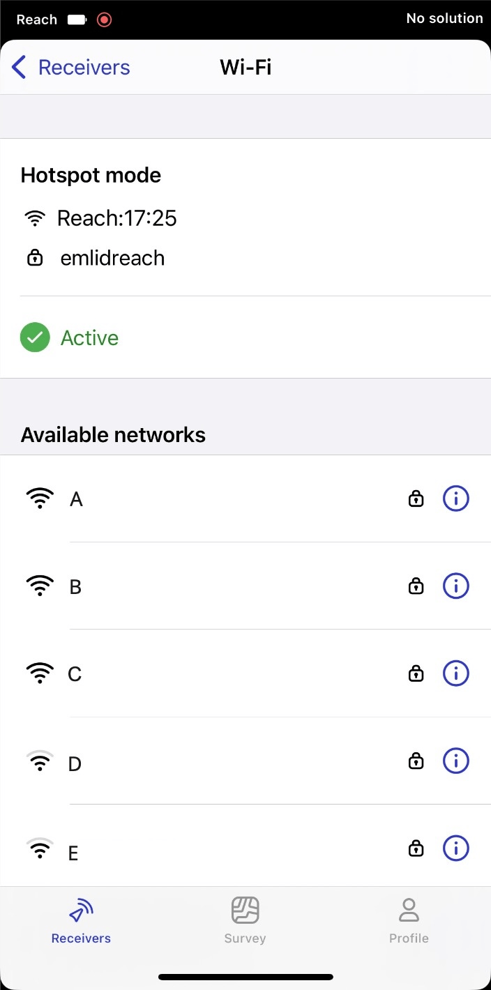

On the Receivers screen, tap Wi-Fi.
Choose your Wi-Fi network from the list.

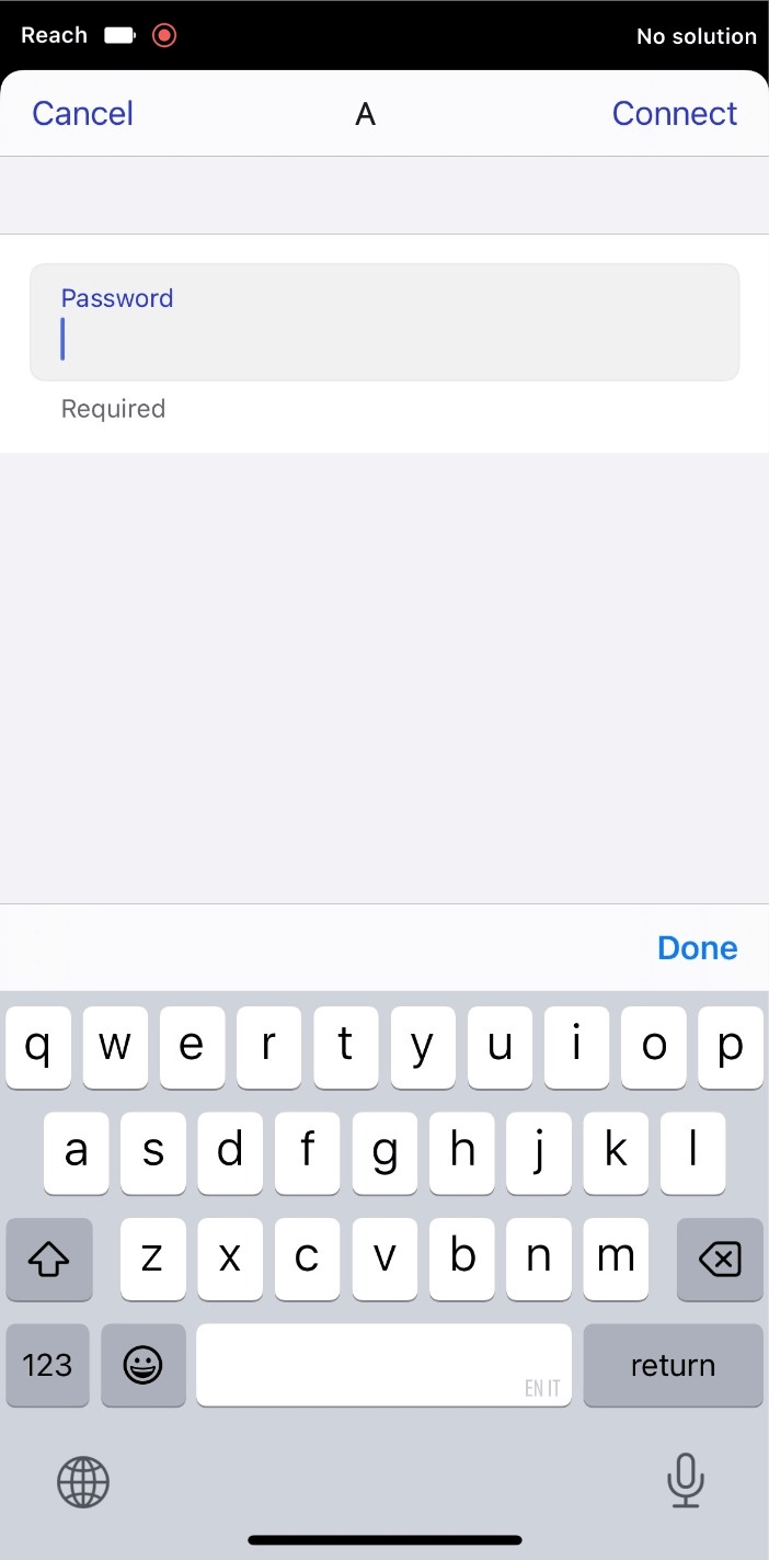

Fill in the password for the selected network.
noteDouble-check if you entered the password correctly.
Tap the Connect button. The Network LED will start blinking. It means that Reach is trying to connect to your network.
