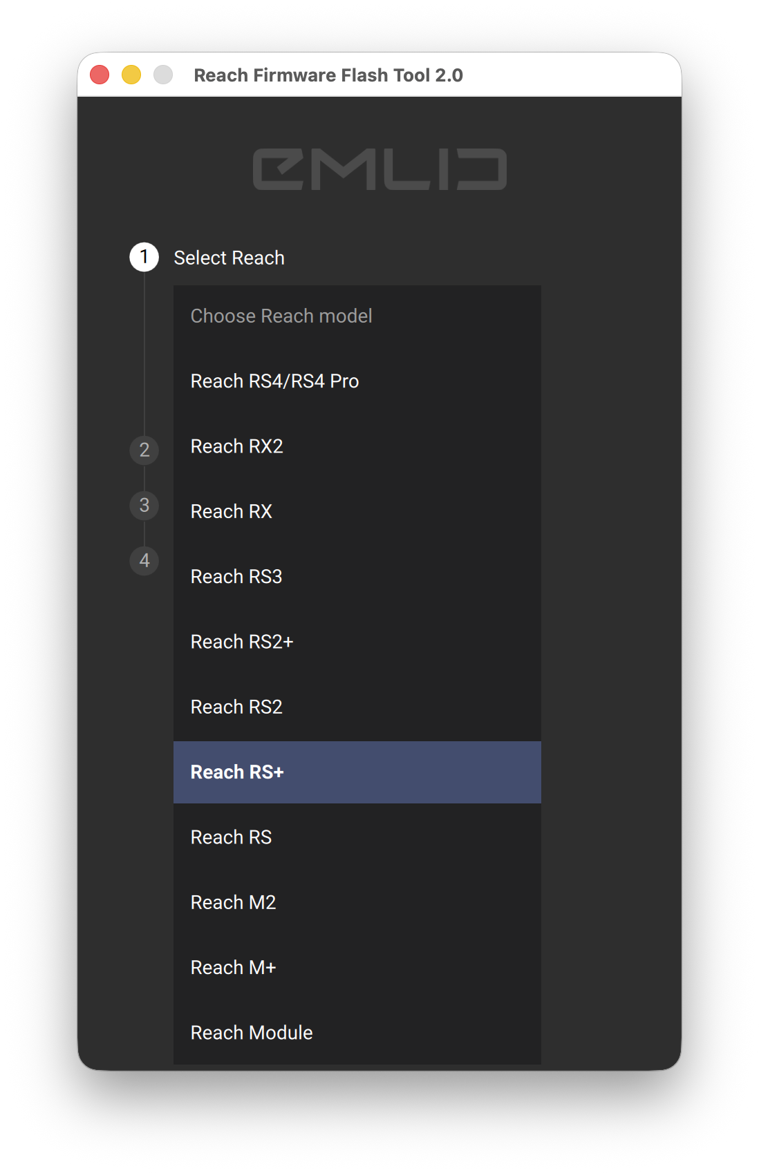

Open Reach Firmware Flash Tool and choose Reach RS+ or Reach RS.
tipYou can also press the Return/Enter button to proceed to the next step.

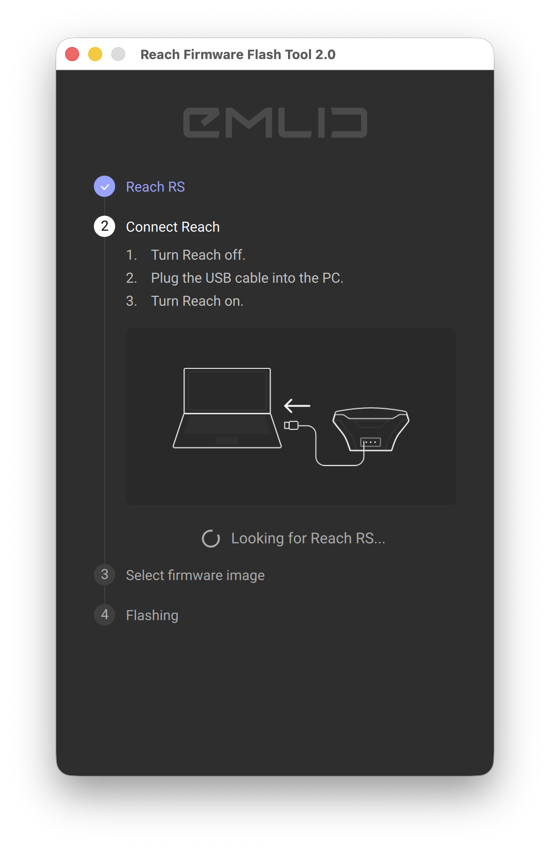

How to switch your Reach to Firmware modePerform the steps below:
- Connect Reach RS.
- Follow the instructions.

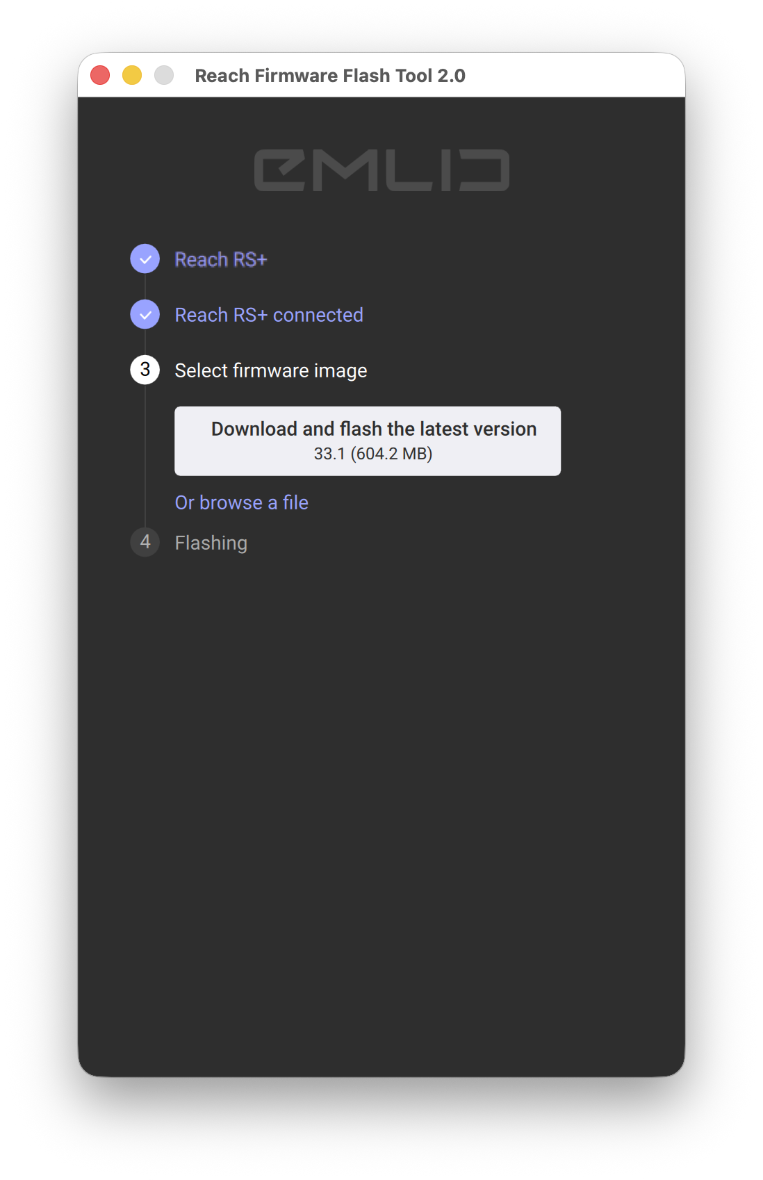

Download the proposed Reach Firmware .zip file.
noteMake sure you have enough disk space. Reach Firmware Flash Tool creates 2 folders: one to download the image and another one to unpack it. Once you close the Flasher tool, the folder with the unpacked image will be deleted.

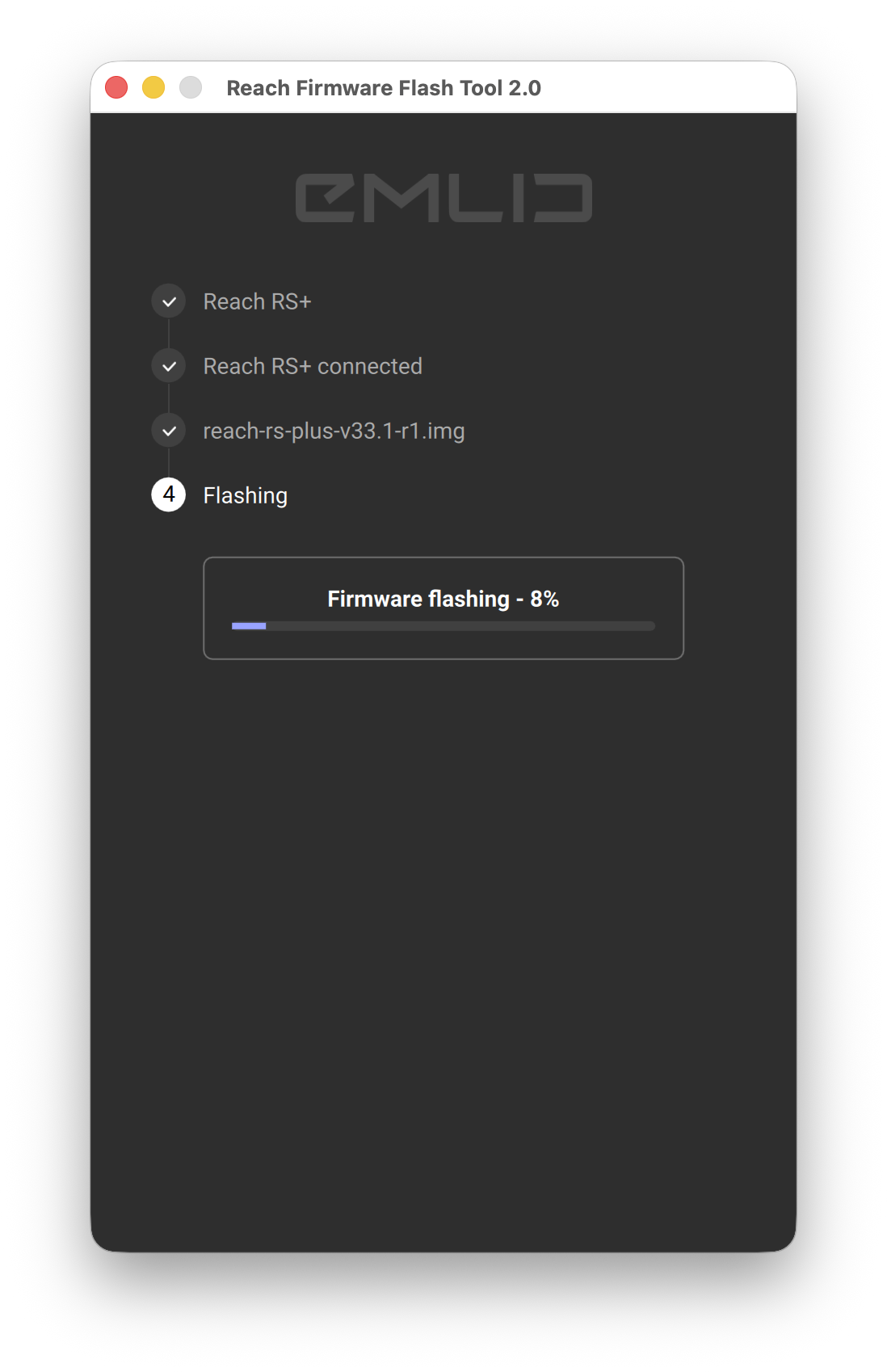

Click Flash.
Wait until the end of the flashing process.

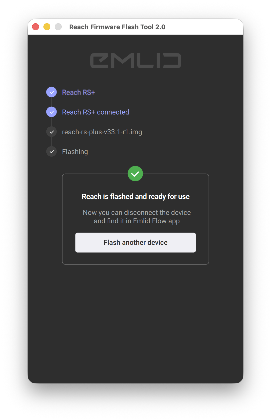

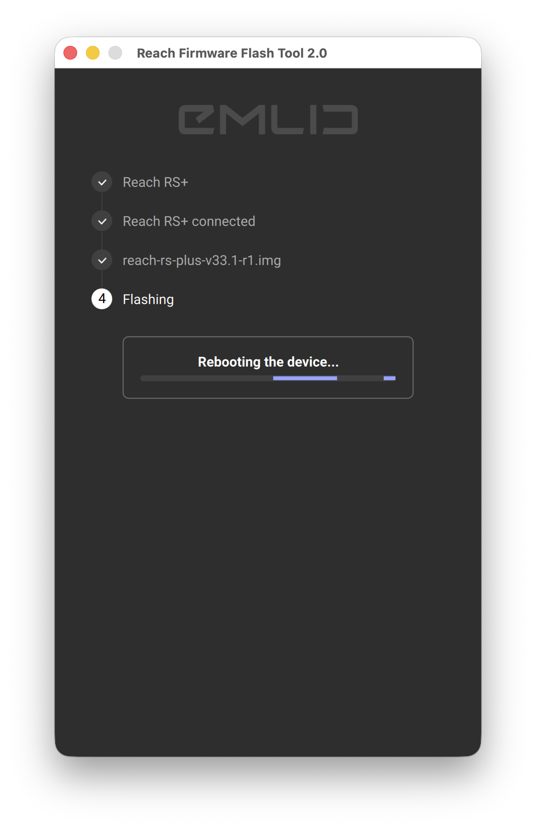

Wait until Reach reboots after reflashing. When Reach successfully reboots, you will see "Reach is flashed and ready to use" message.
cautionDo not unplug your unit on this step.
