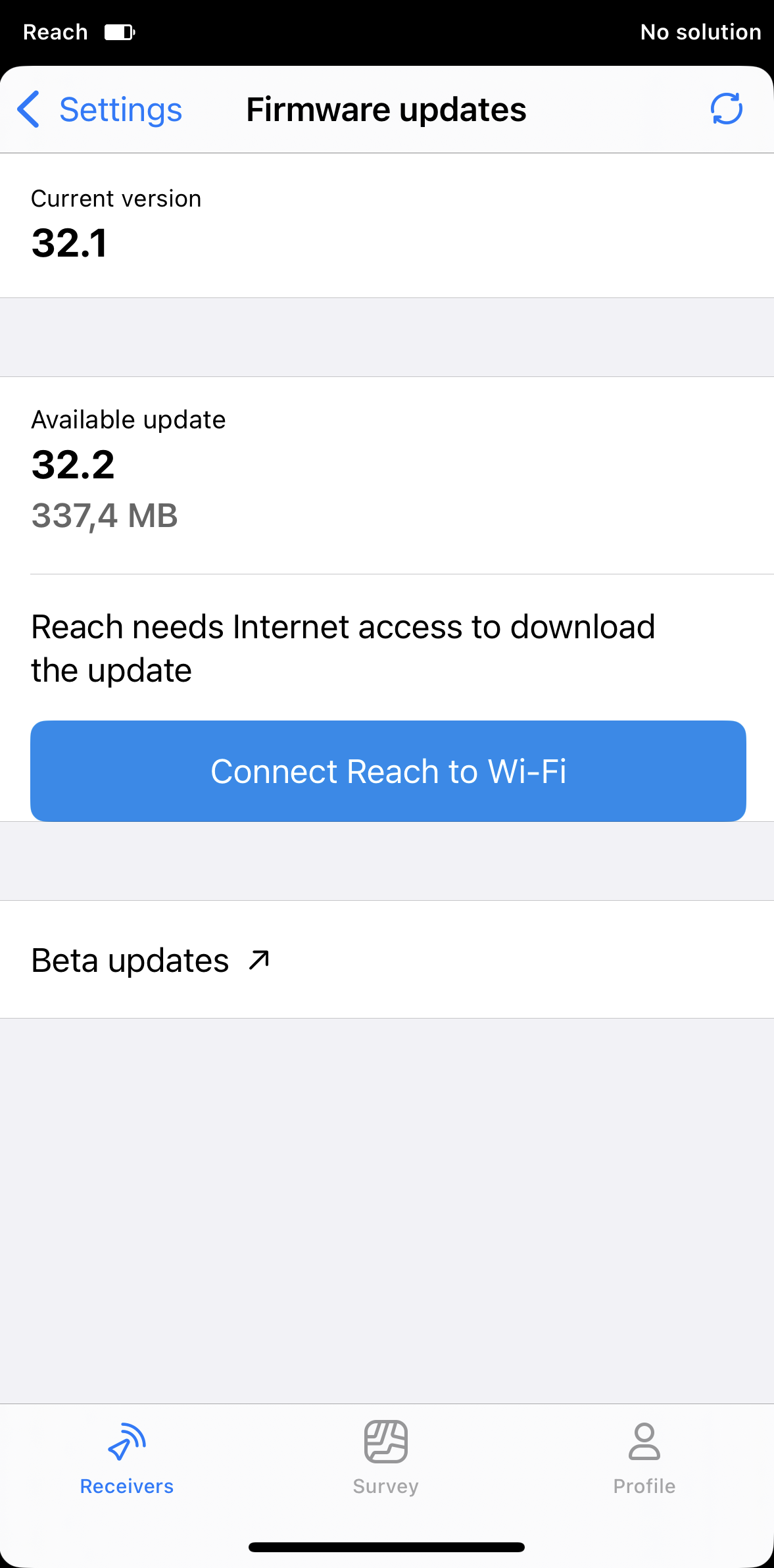

Once connected to your Reach, tap Settings.
Tap the update notification plate or Firmware updates to access Updater.

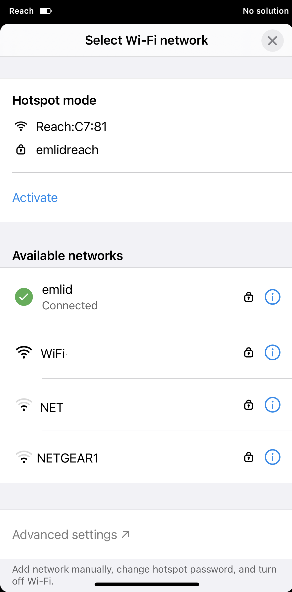

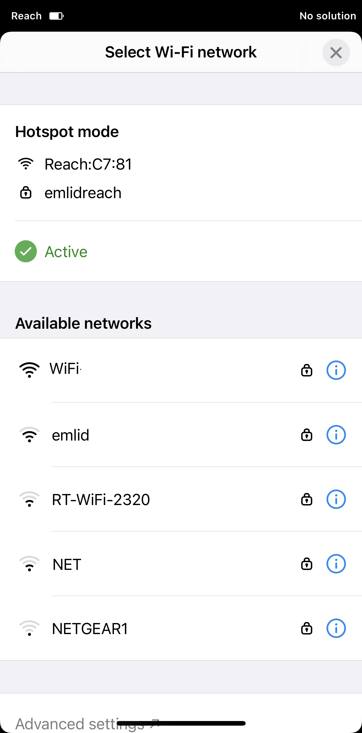

Tap Connect Reach to Wi-Fi to connect your receiver to the internet.

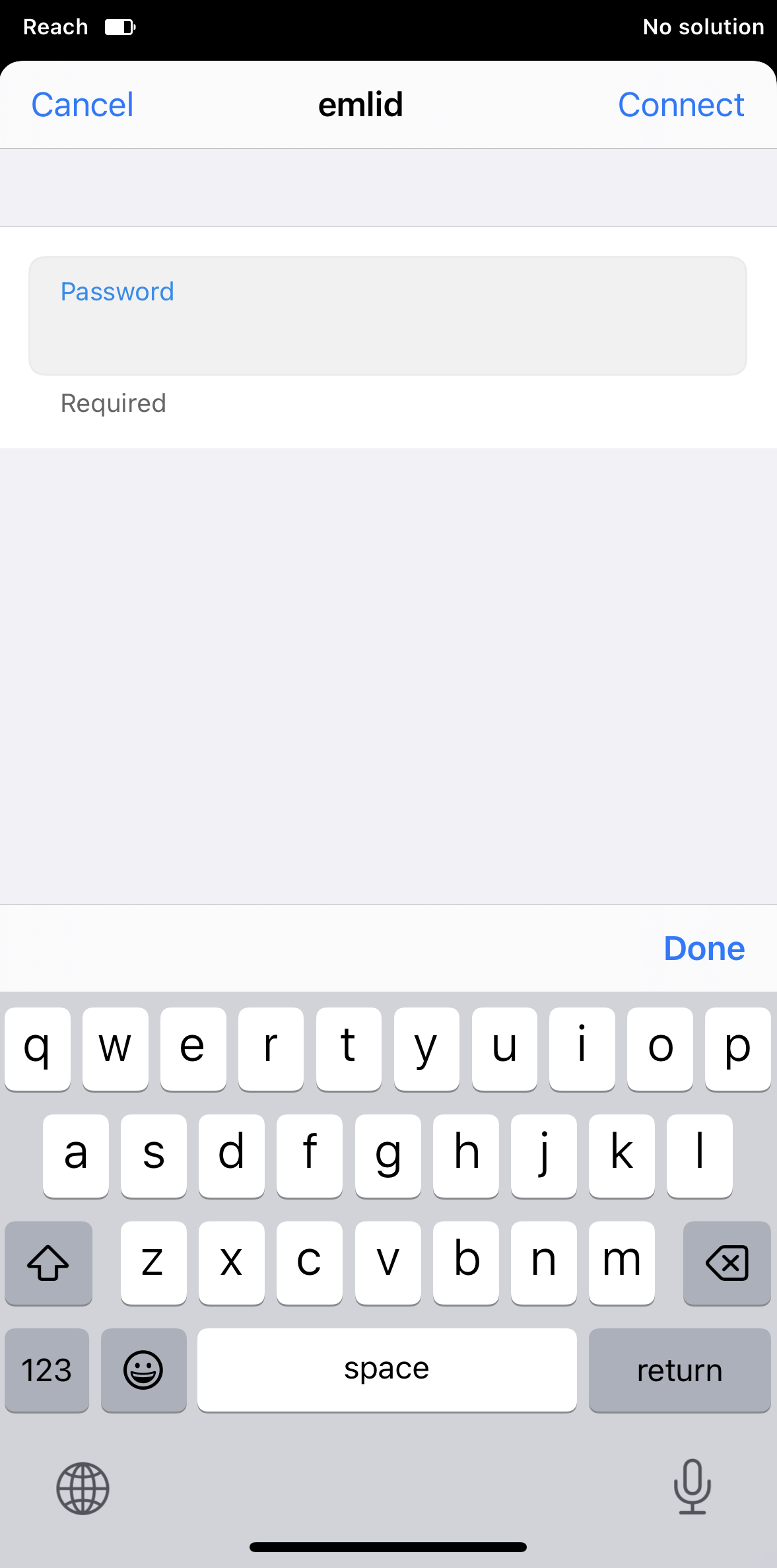

Select a Wi-Fi network you want to connect to and enter the password. Tap Connect.
Wait for the successful connection and close this screen.

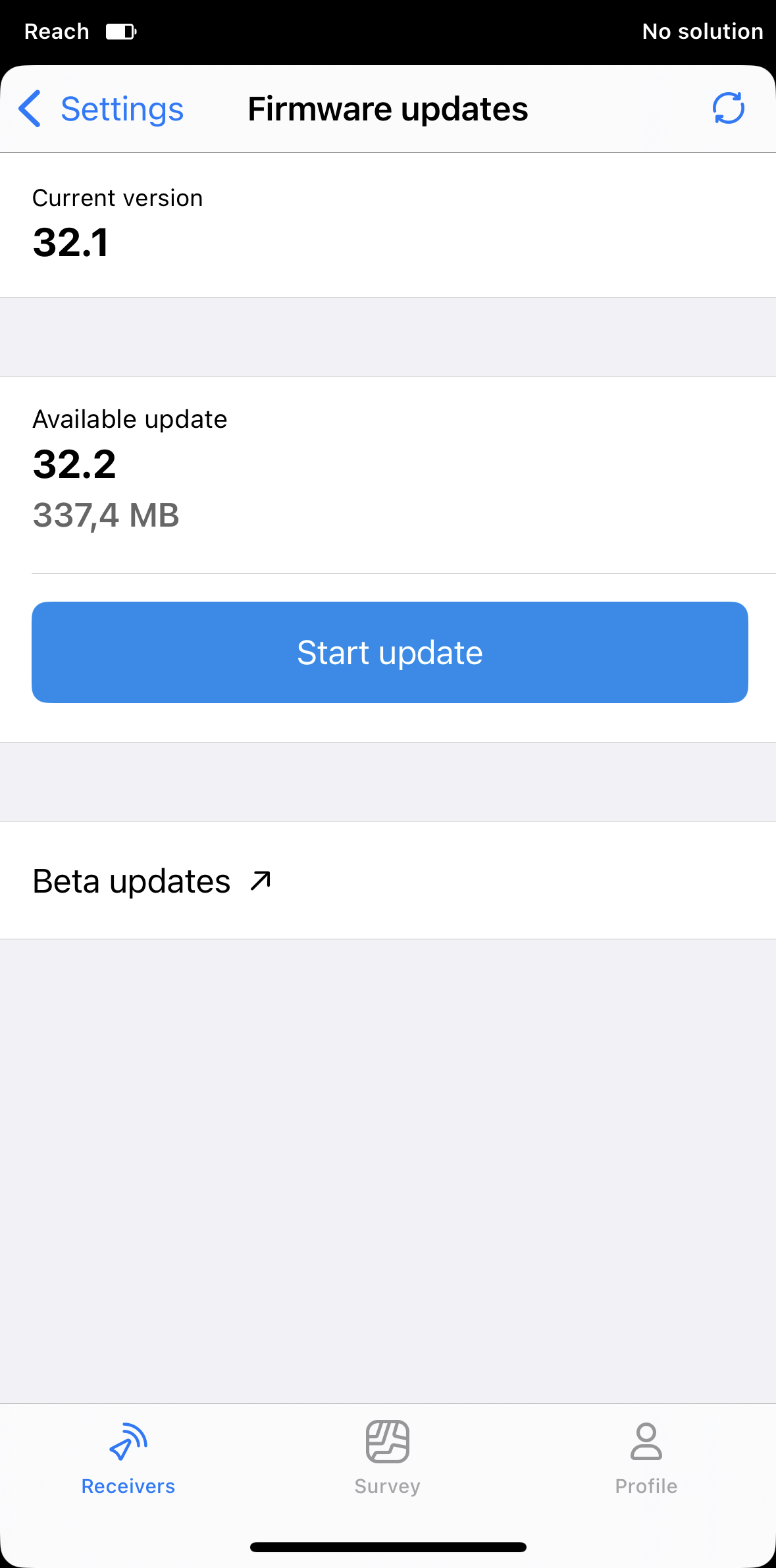

Tap the Start update button.

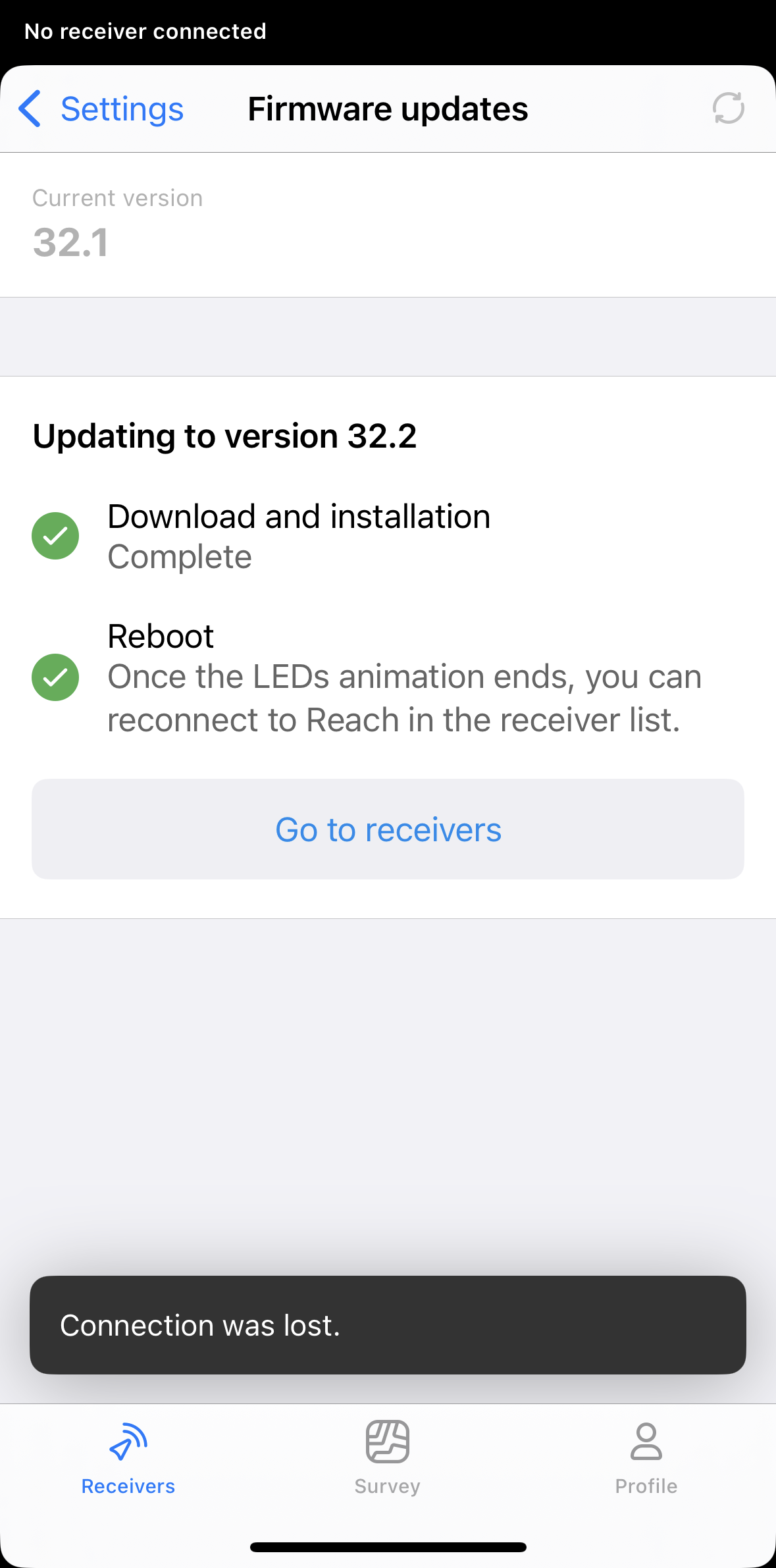

Keep the Updater screen open and wait for the receiver firmware to update. The update process includes two steps:
The app downloads and installs the new firmware version.
Reach automatically reboots after the firmware installation is complete.
Wait until your Reach reboots and reconnect to it in the Receivers tab.
