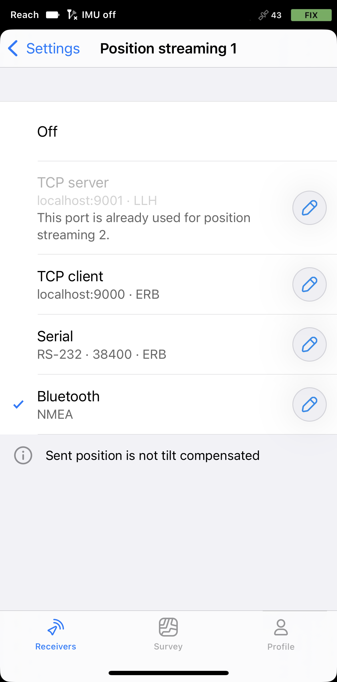

To send position data to external applications, configure position streaming in NMEA format as follows:
In Emlid Flow, go to Settings.
Tap Position streaming 1 and select Bluetooth.
To configure position streaming, tap the Edit button in the Bluetooth cell.
noteWhen connected to your Reach via Bluetooth, Emlid Flow will prompt you to connect to the Reach hotspot to access the streaming configuration settings.

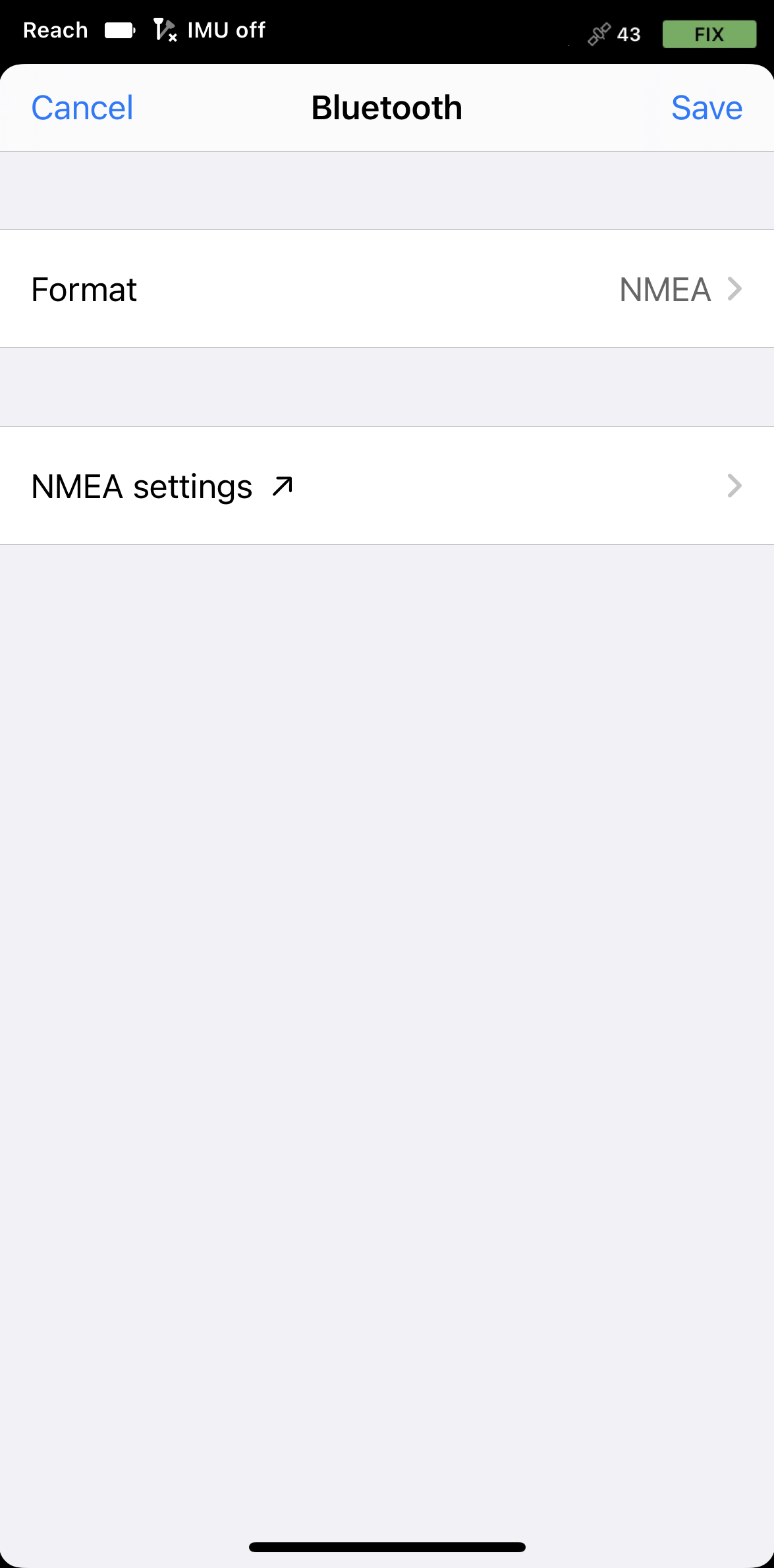

Tap Format and choose NMEA.
Apply the necessary changes.

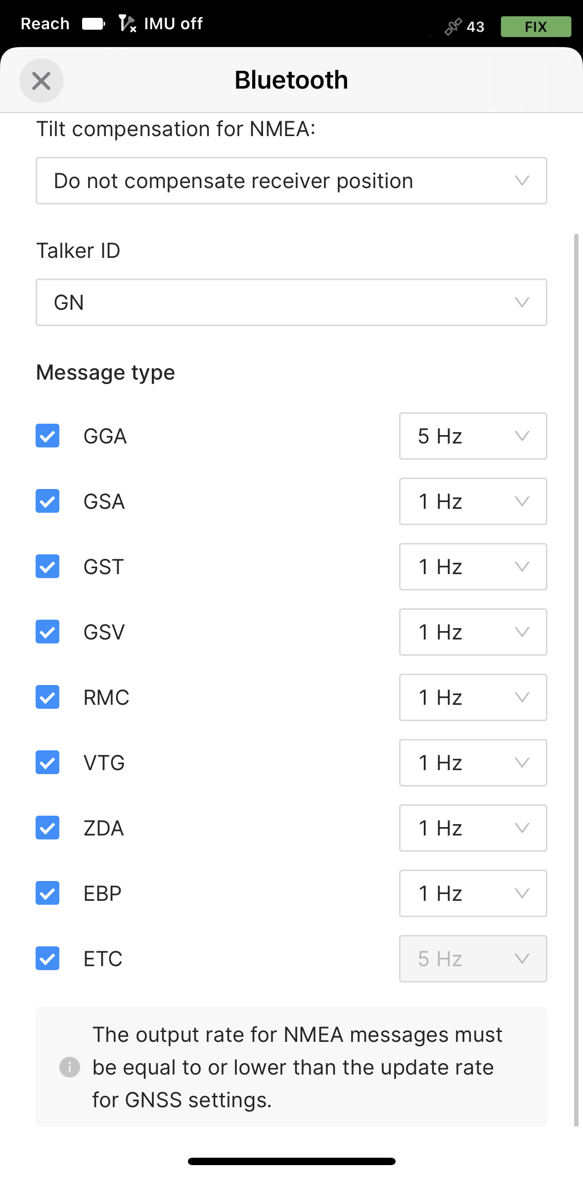

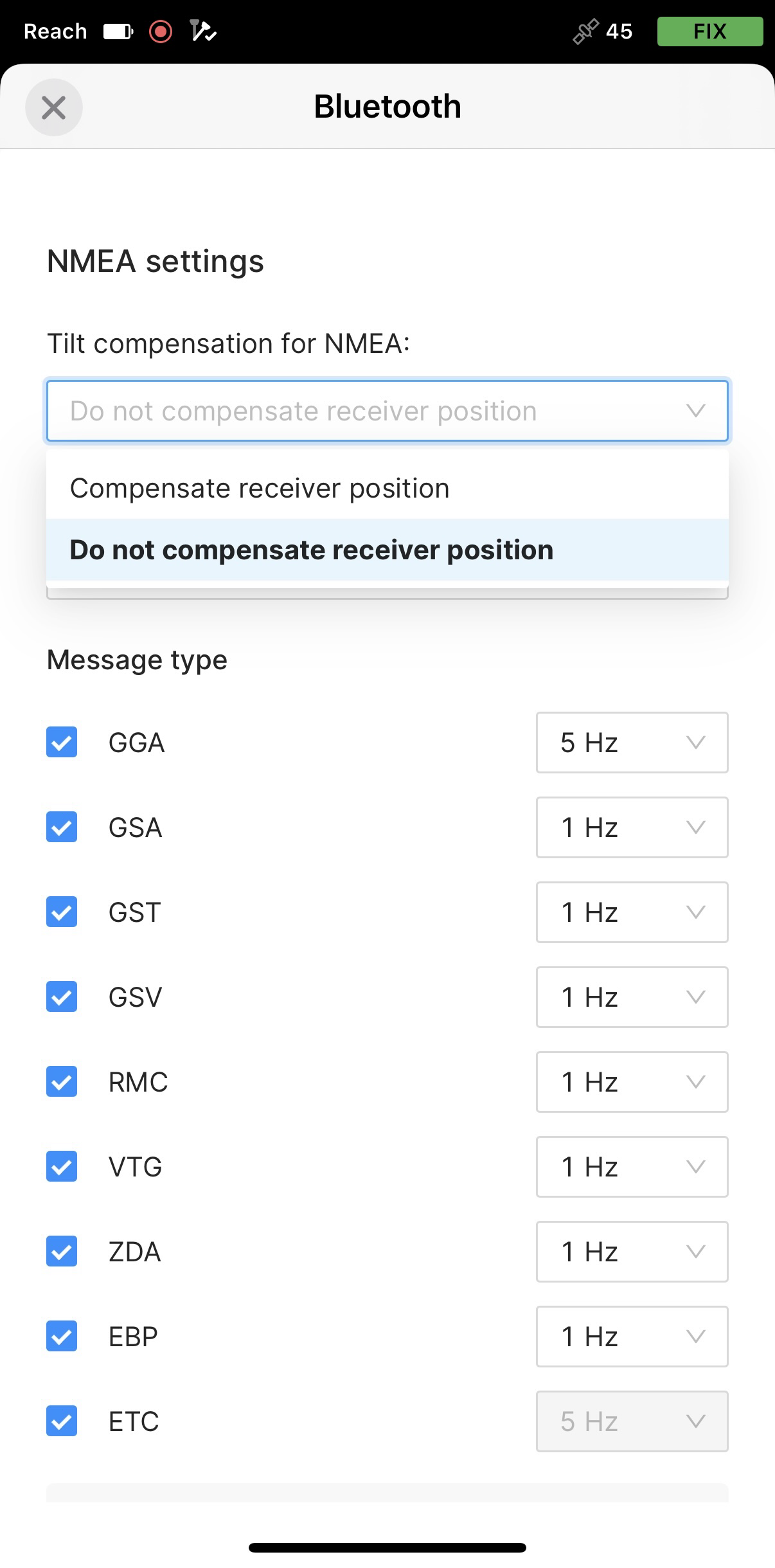

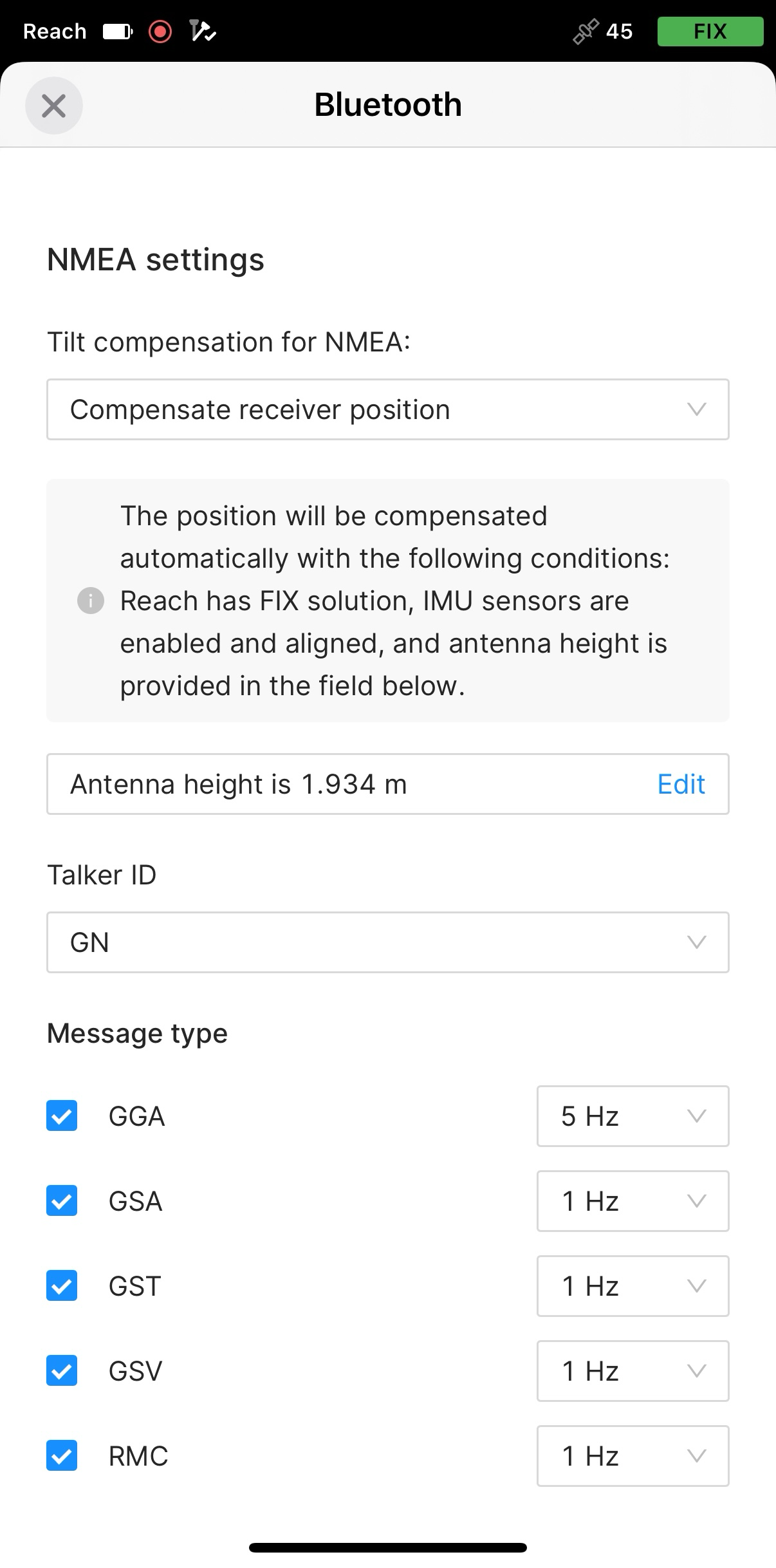

To send compensated NMEA messages, you need to enable it in Emlid Flow.

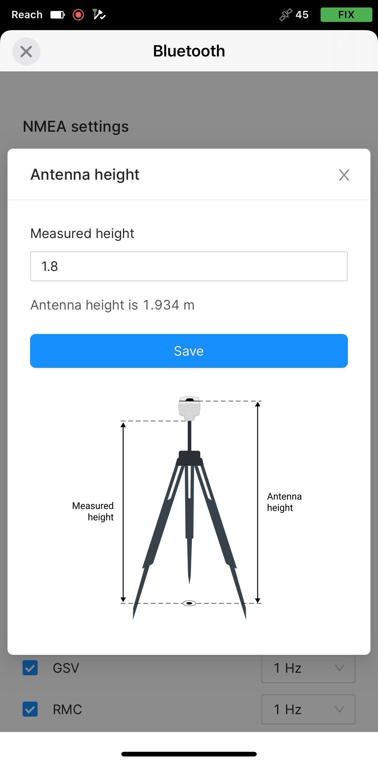

Set the antenna height. You only need to enter the pole height. Emlid Flow automatically applies the antenna phase center offset and adjusts the measurements accordingly.
cautionWhen sending compensated NMEA messages, set the antenna height only in Emlid Flow. Setting it in third-party apps as well may cause discrepancies.
