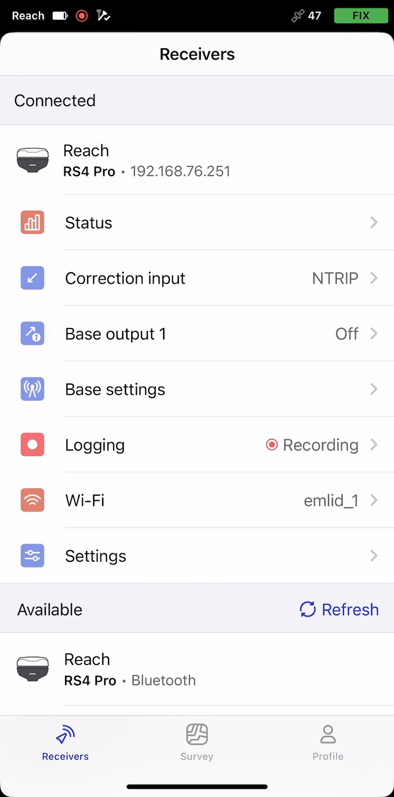

Access Reach using Emlid Flow
You can connect to your Reach in two ways:
- Using the BLE connection option. This is the recommended connection method. It is especially useful when working with corrections from an NTRIP provider. In this setup, the receiver uses your mobile device’s internet connection, so you only need to select the NTRIP over BLE option when configuring the receiver’s correction input.
- Using the Wi-Fi connection option. In this case, your device and Reach must be in the same Wi-Fi network.
To connect to your Reach, follow the steps below:
- Bluetooth connection
- Hotspot connection
Open Emlid Flow. When prompted, tap Configure access and allow location permissions. This is required for full receiver functionality.
Reach prioritizes the current connection when using BLE, regardless of type:
- If Reach is connected via Bluetooth Classic to third-party software, disconnect it before using BLE in Emlid Flow.
- If another device is connected to Reach, disconnect it before reconnecting using BLE in Emlid Flow.
After granting permissions, your receiver will appear in the list. The app will connect to it automatically.

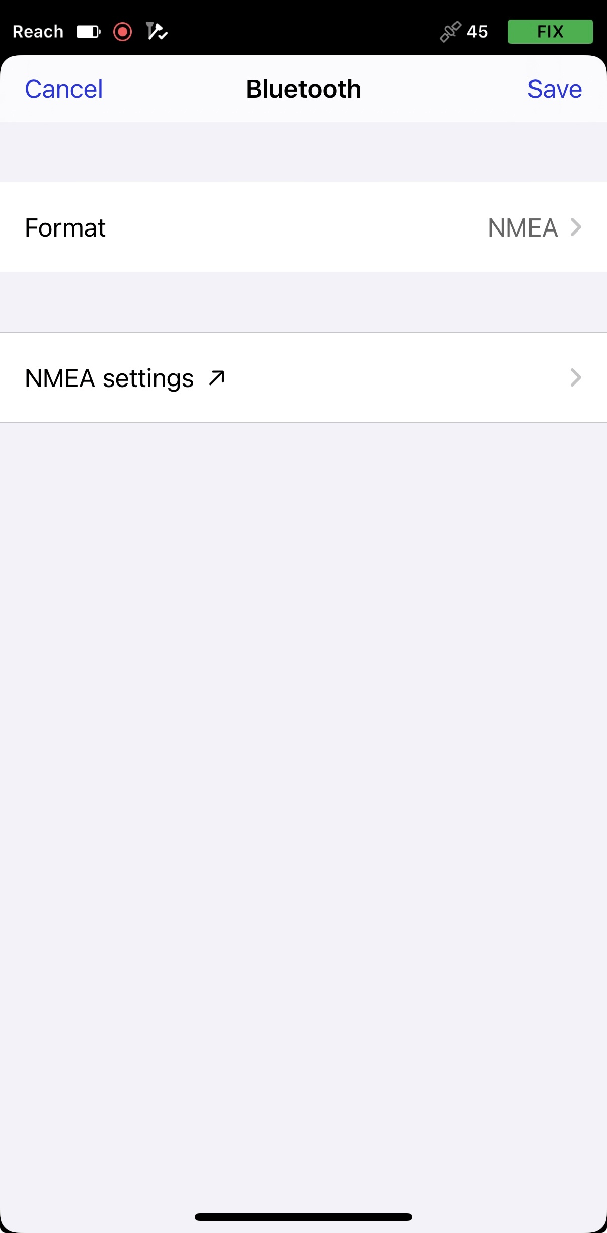

Set up NMEA stream in Emlid Flow
To send position data to external applications, configure position streaming in NMEA format as follows:

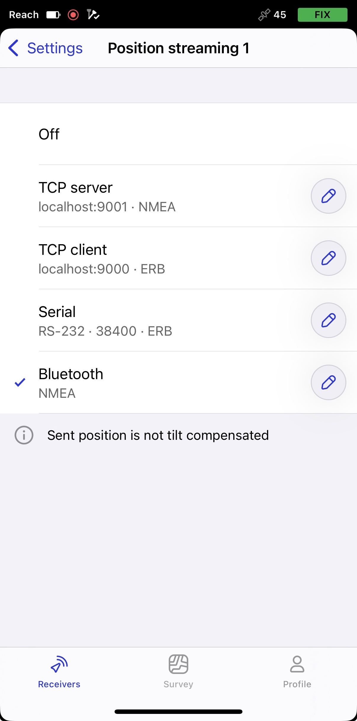

In Emlid Flow, go to Settings.
Tap Position streaming 1 and select Bluetooth.
To configure position streaming, tap the Edit button in the Bluetooth cell.
noteWhen connected to your Reach via Bluetooth, Emlid Flow will prompt you to connect to the Reach hotspot to access the streaming configuration settings.

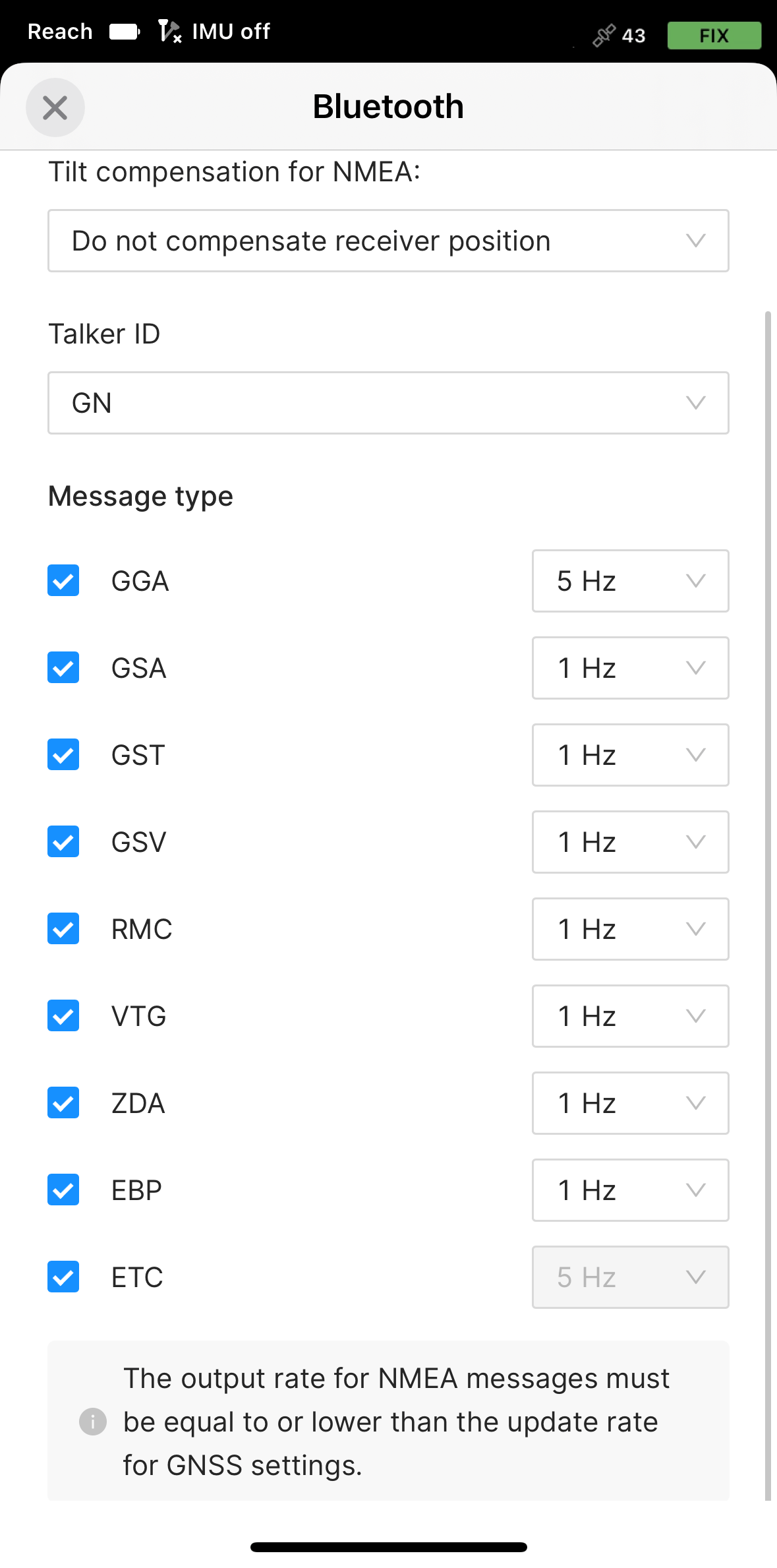

Tap Format and choose NMEA.
Apply the necessary changes.

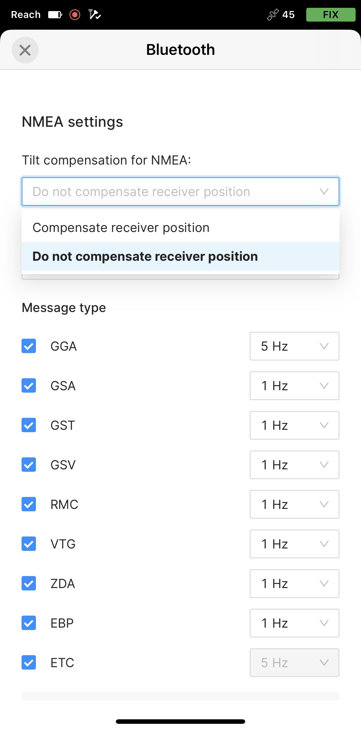

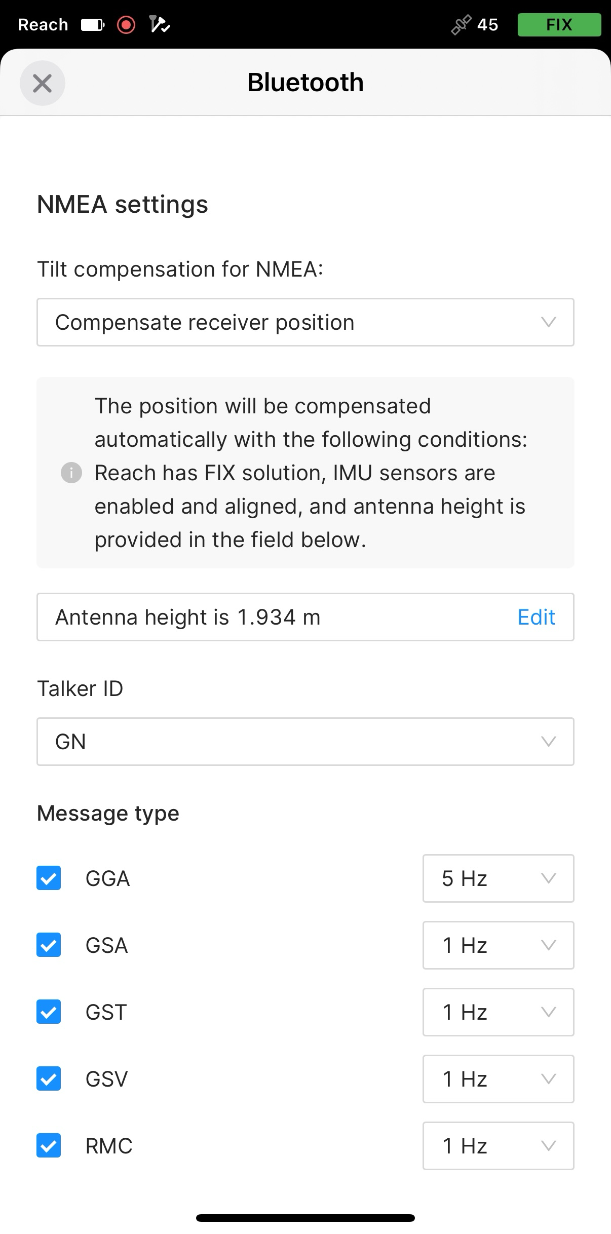

To send compensated NMEA messages, you need to enable it in Emlid Flow.

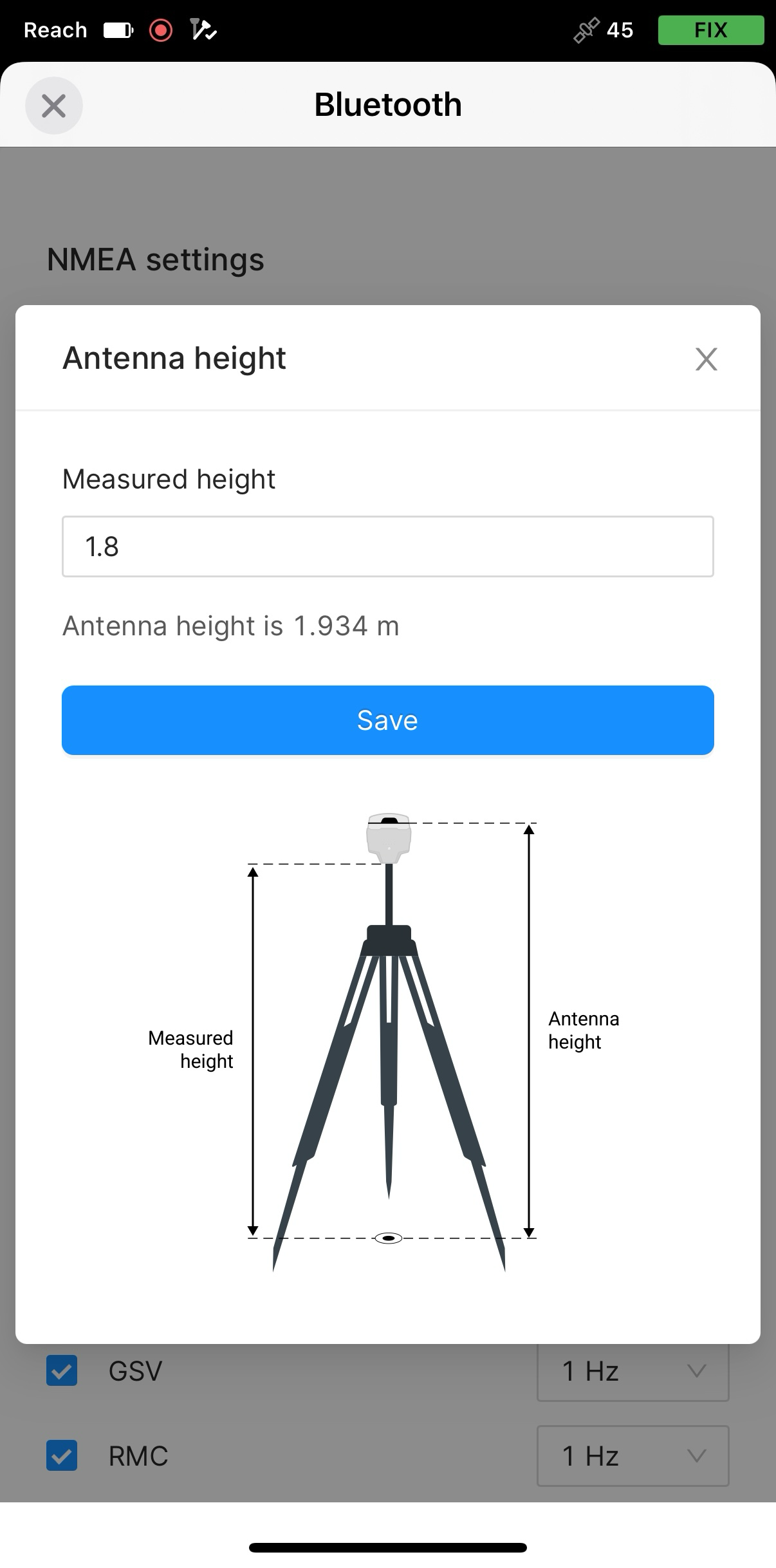

Set the antenna height. You only need to enter the pole height. Emlid Flow automatically applies the antenna phase center offset and adjusts the measurements accordingly.
cautionWhen sending compensated NMEA messages, set the antenna height only in Emlid Flow. Setting it in third-party apps as well may cause discrepancies.
