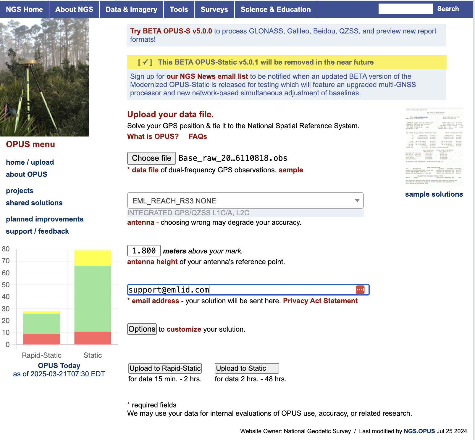

  1. Go to the NOAA's OPUS site submission page.
  2. Click on the Choose file button and browse for the observation file (.**O).
  3. Choose EML_REACH_RS3 NONE in the Antenna field.
  4. Type a pole height in the Antenna Height field.
  5. In the email address field, enter your email address to get the results.
  6. Click on the Upload to Static button.
OPUS will send the file with the solution to your email address.
