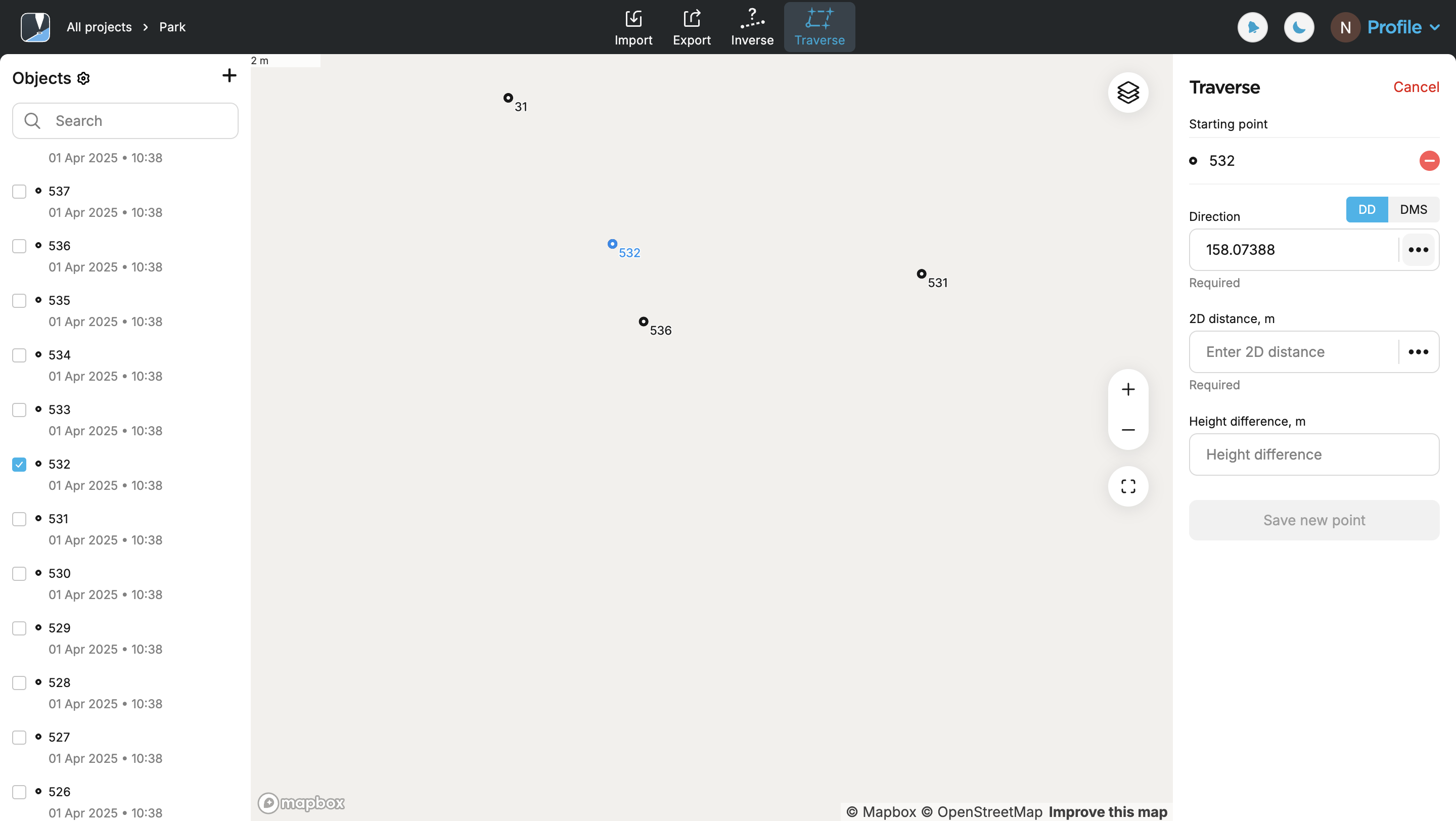

To apply the Traverse tool in the Emlid Flow 360 app, follow these steps:
Access Emlid Flow 360 and either create a new project or access an existing one.
Click Traverse at the top of the screen.

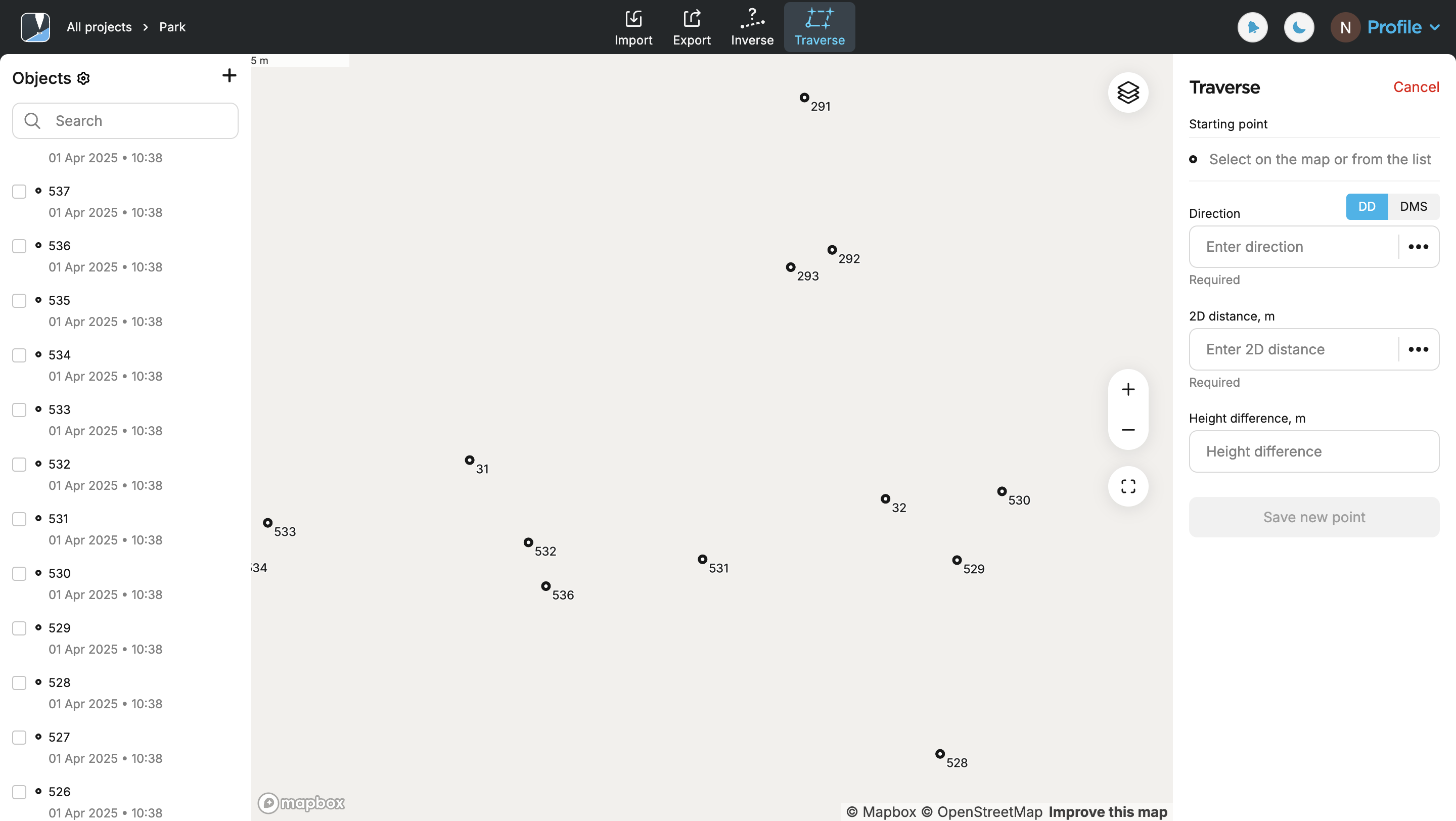

Select a starting point from the map or the list.

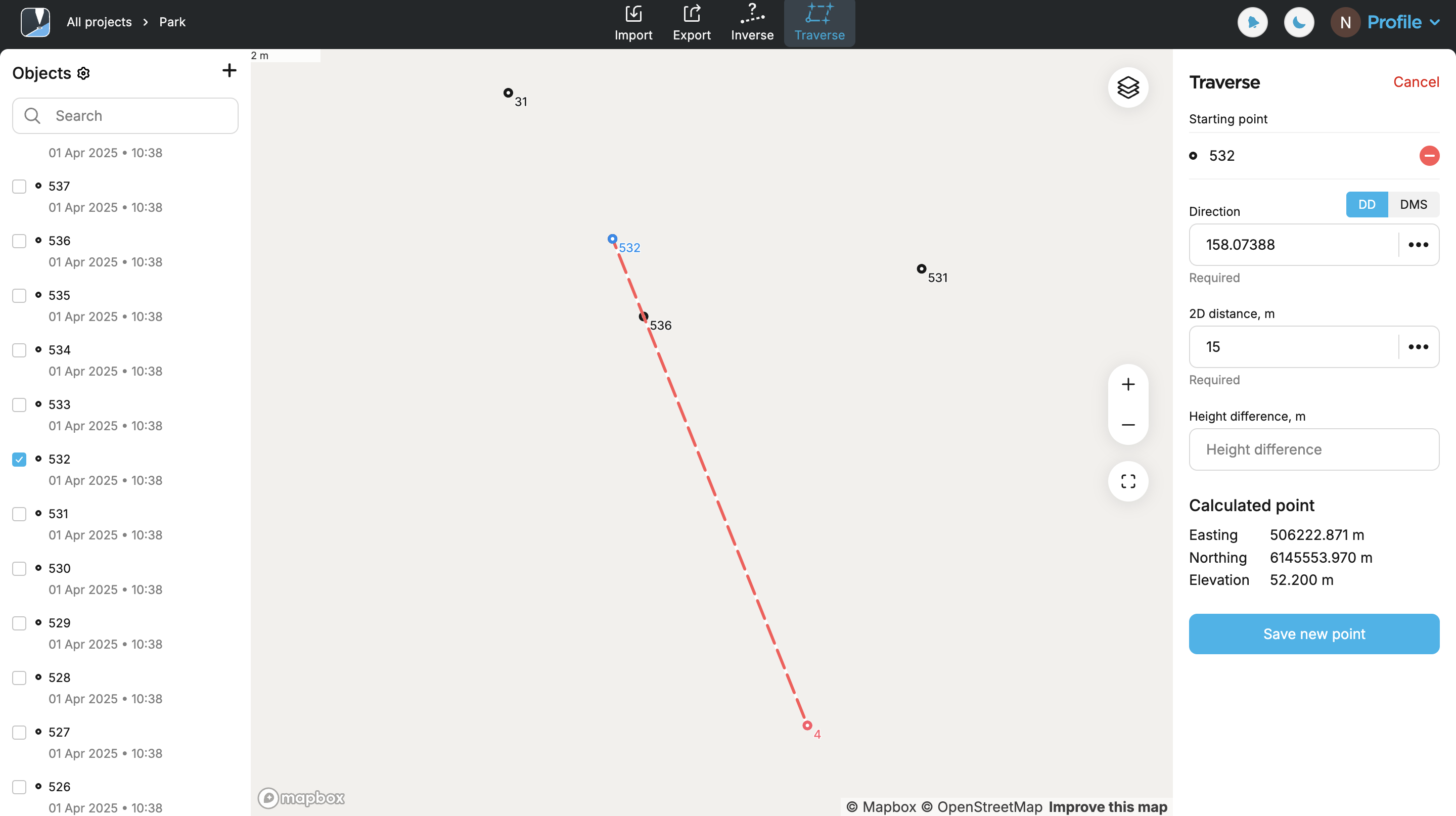

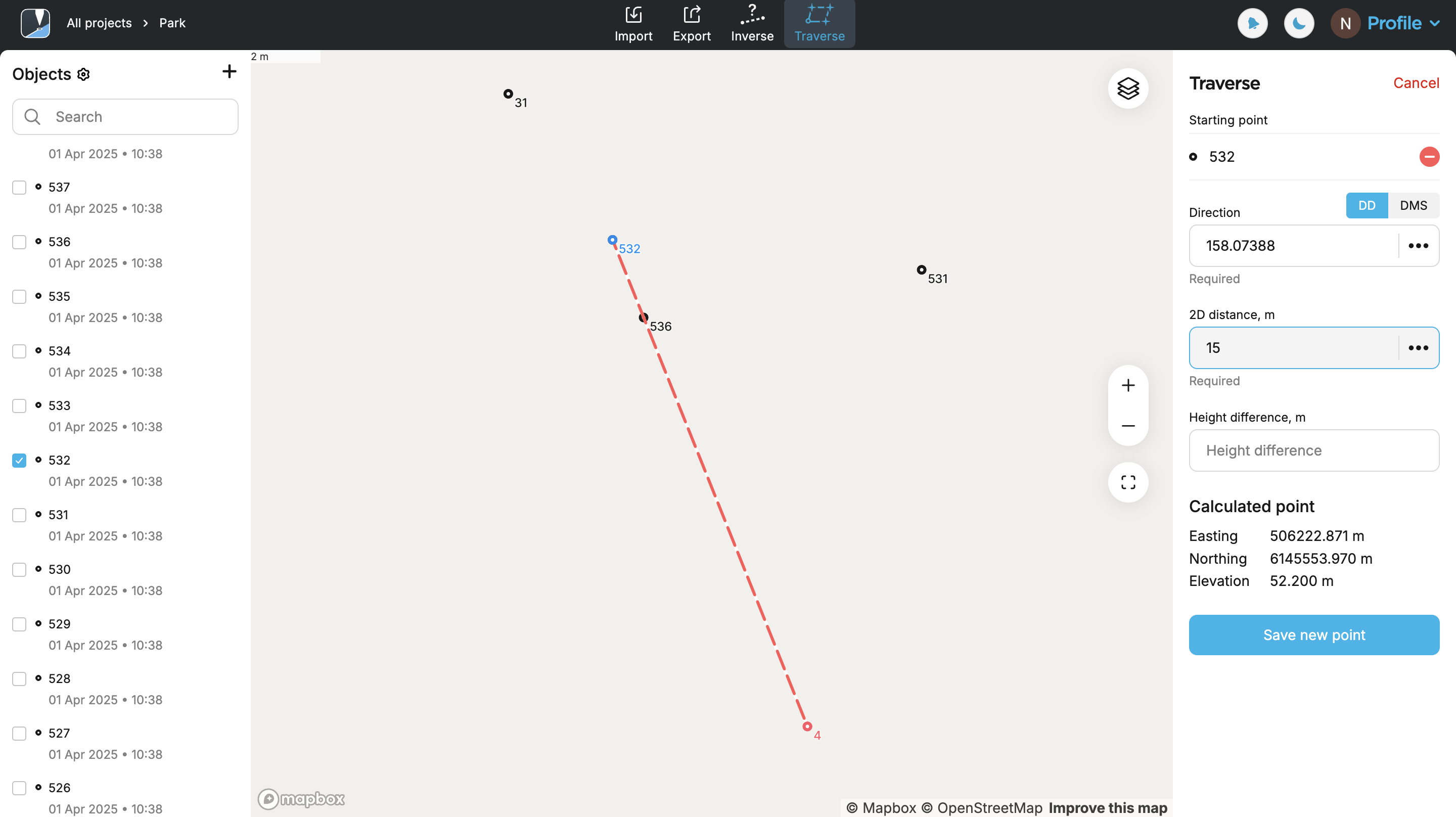

Enter the distance,
direction (azimuth), and height difference from this point to create a new point. Click Save new point.Direction (azimuth) of a line AB, or from point A to B, is a horizontal angle in degrees, measured at point A clockwise between the direction to the north and the direction to point B.
noteDistance must start from 0.
Direction (azimuth)must be in the range 0-360 and can be in the DD or DMS format.Direction (azimuth) of a line AB, or from point A to B, is a horizontal angle in degrees, measured at point A clockwise between the direction to the north and the direction to point B.

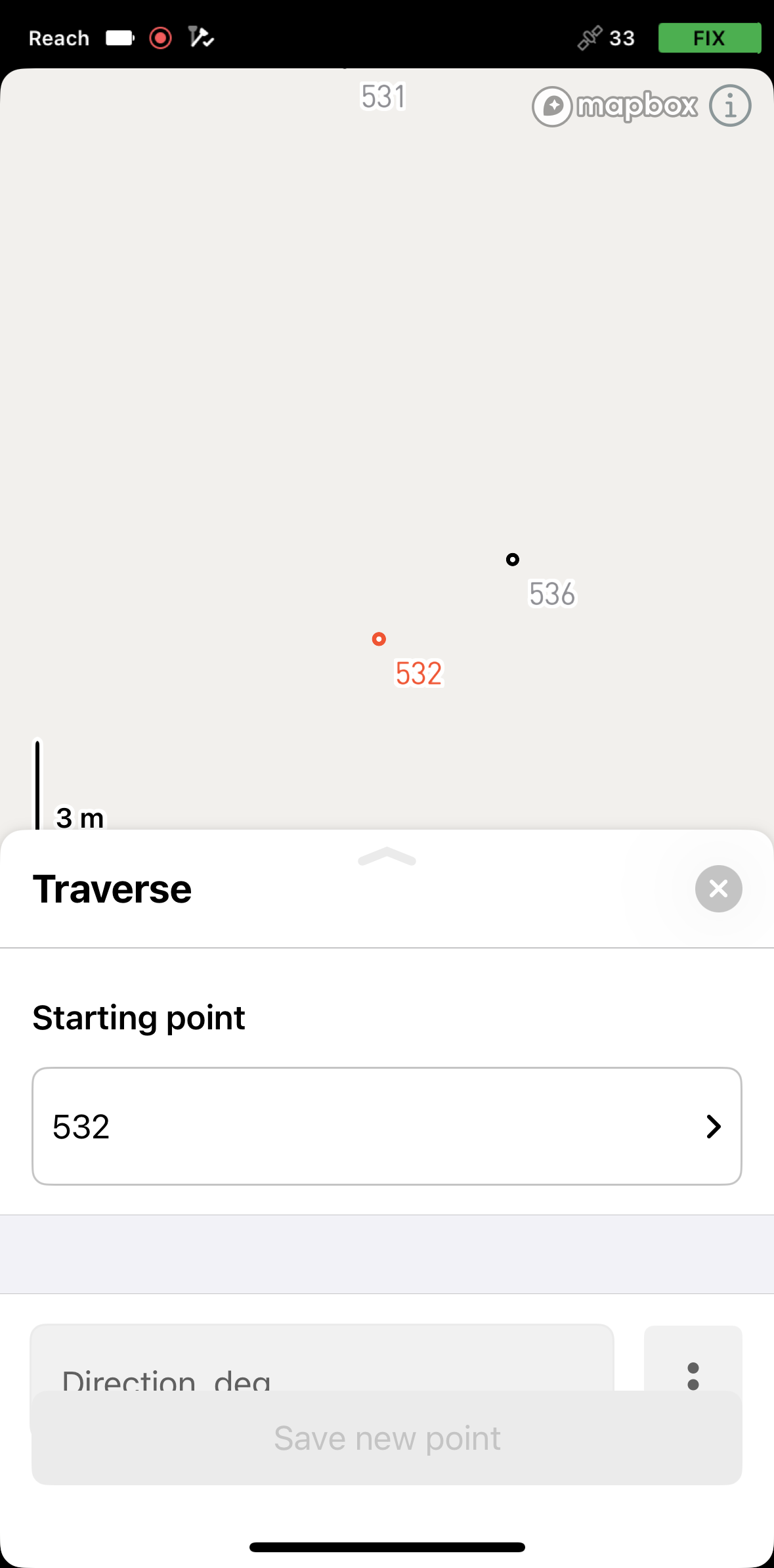

To apply the Traverse tool in the Emlid Flow app, follow these steps:
Open Emlid Flow and either create a new project or access an existing one.
Tap the tools button at the bottom left corner of the screen.
Tap Traverse.
Select a start point from the map or the list.
Swipe the drawer up to enter the data for a new point.
Enter the distance, direction (azimuth), and height difference from this point to create a new point.

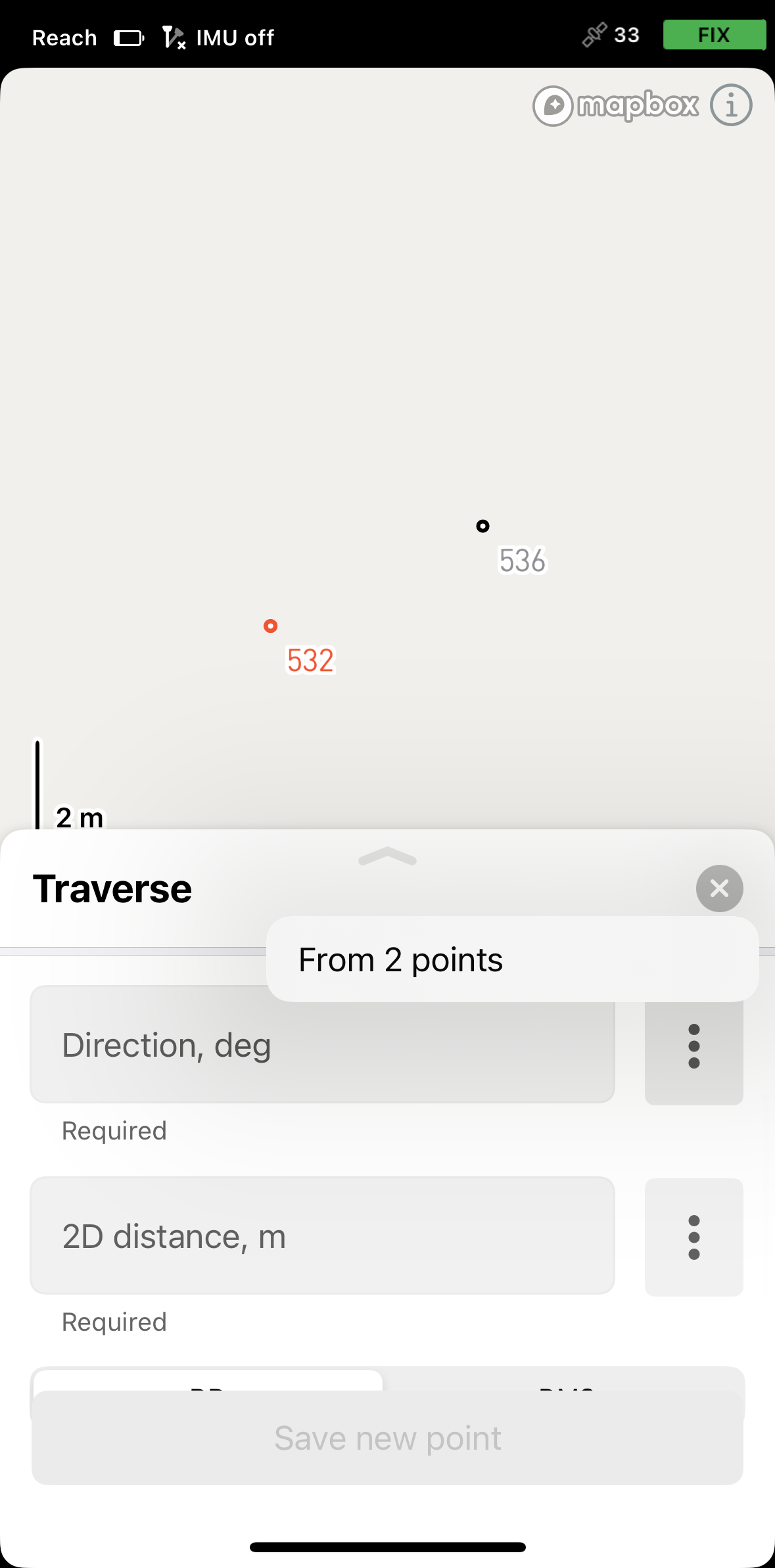

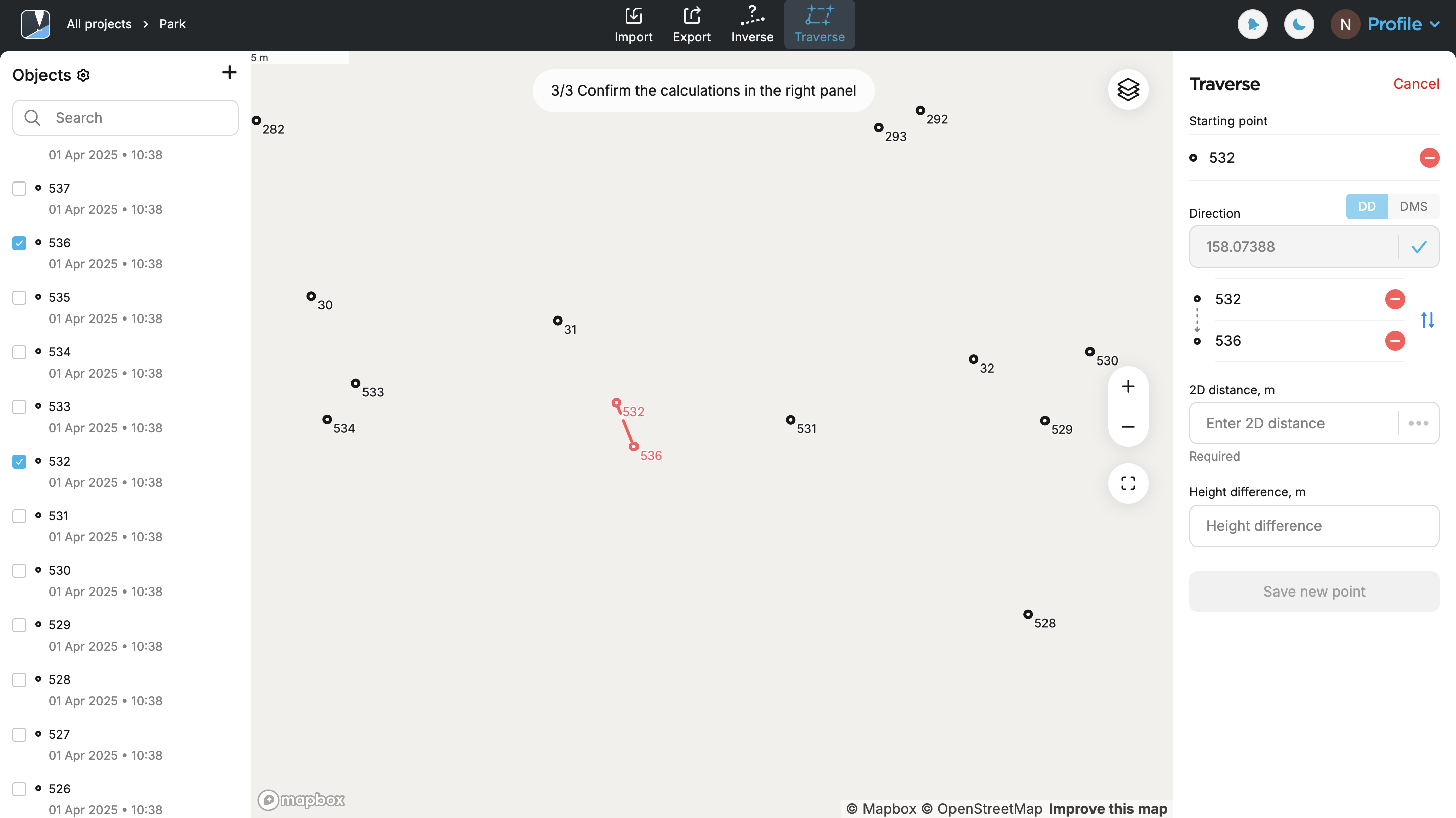

Calculating direction from two points
The Traverse tool allows you to calculate direction using two auxiliary points that are collected or added in advance and positioned on the same straight line as the calculated point. Follow the steps below:
- Emlid Flow 360
- Emlid Flow
Access Emlid Flow 360 and open a project.
Select Traverse at the top of the screen.

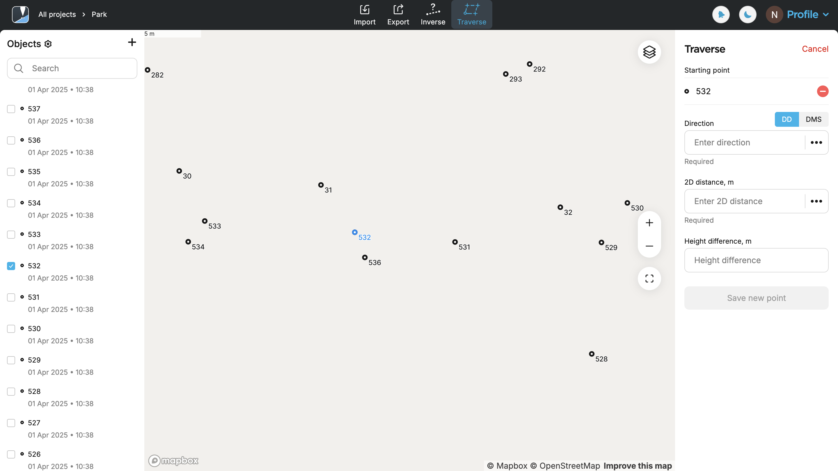

Select the starting point. You can choose it from the map or the list.

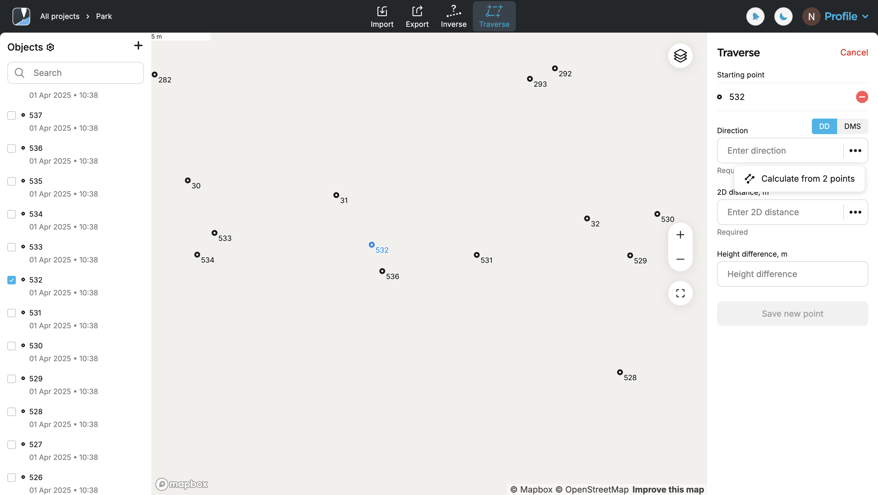

To set the direction, click on the three dots and select From two points.
Select two points which must be exactly on the same line with the calculated point.
Confirm the calculation of the direction.
Specify the distance measured between the auxiliary points.
Save the new point.

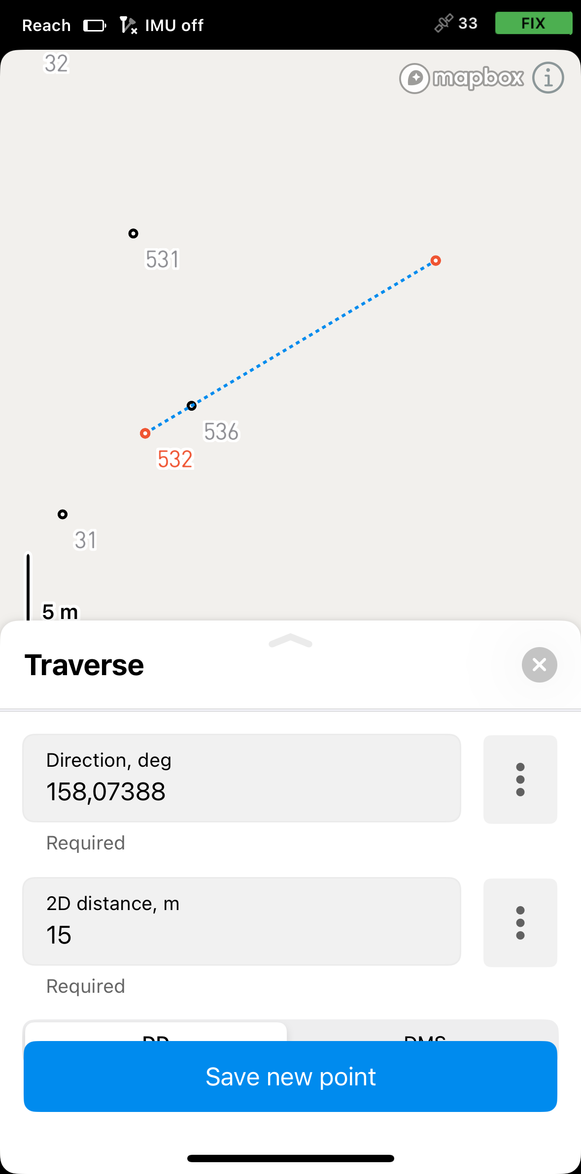

Tap Tools, then select Traverse.

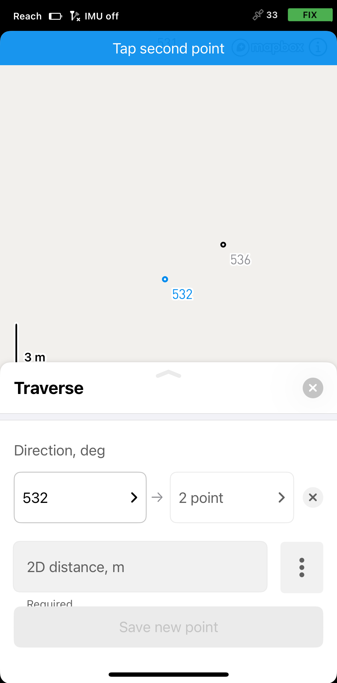

To set the direction, swipe the drawer up, tap the three dots, and select From two points.
Select two auxiliary points positioned on the same line as the calculated point.
Specify the distance between the auxiliary points and enter the value in the corresponding field.
Save the new point.
