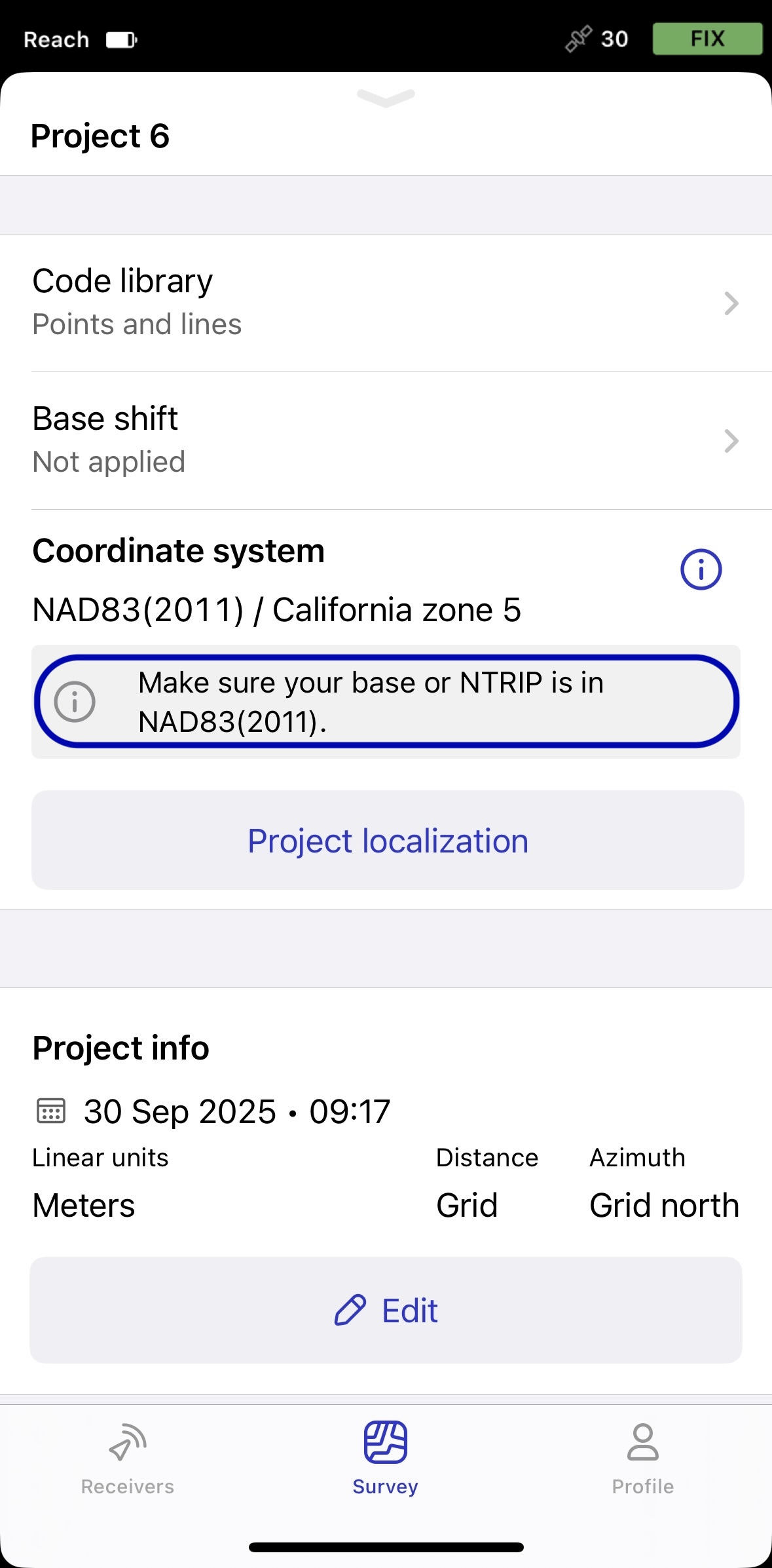

Emlid Corrections automatically selects the appropriate datum, realization, and epoch for the receiver's location. To avoid coordinate offsets, configure your project on rover in Emlid Flow to use a coordinate system based on the same datum.
When setting up a project, check the datum note in the Coordinate system settings. It indicates which datum your RTK corrections source must use. If the project's coordinate system and the RTK corrections use different datums, the measured coordinates may not align with the expected positions.
For example:
  • United States: NAD83 (2011)
