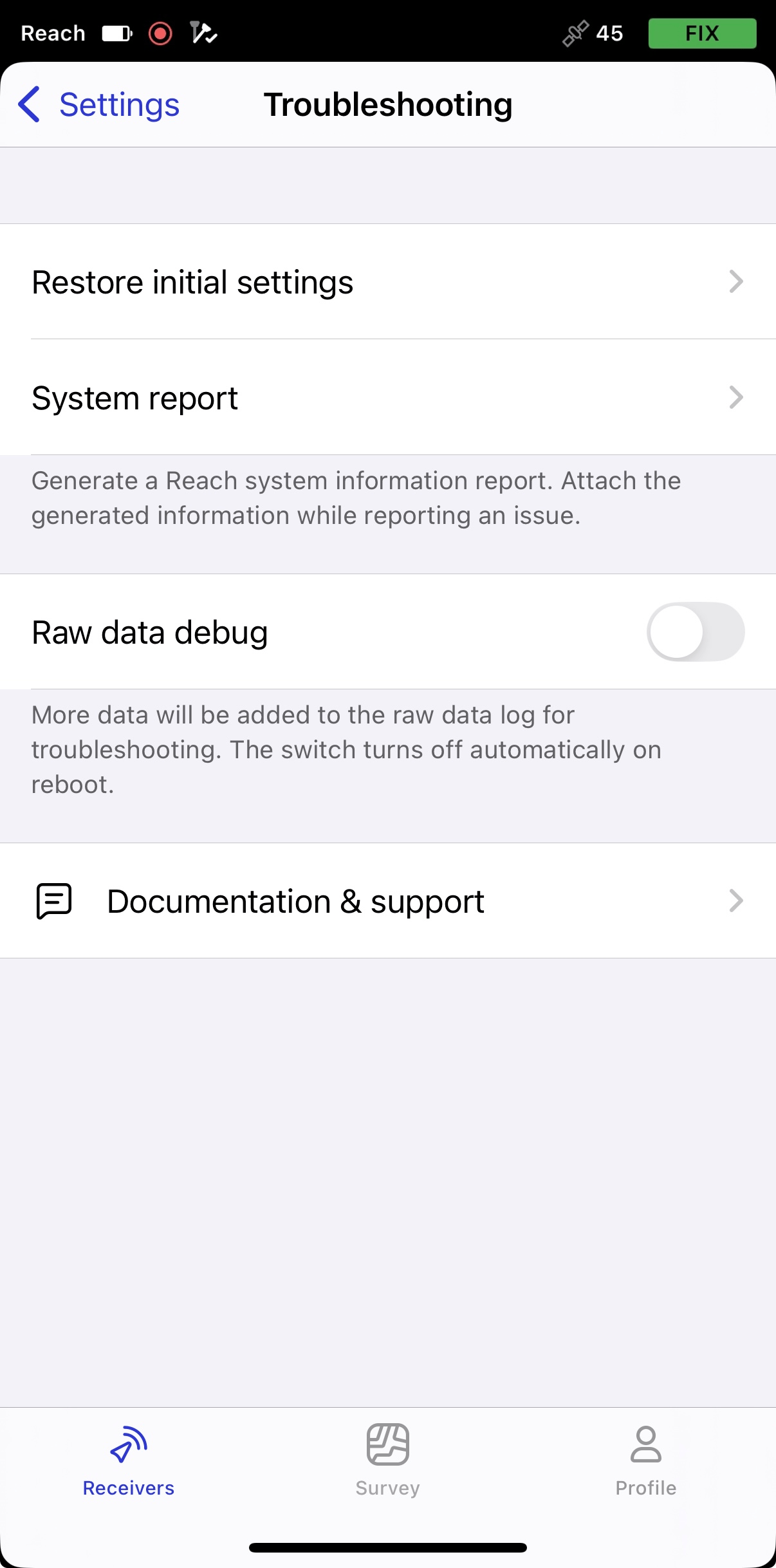

  1. Connect to your Reach via Emlid Flow.
  2. Tap Settings and go to the Troubleshooting section.
  3. Tap Restore initial settings.
  4. Tap the Restore settings button.
    Once it’s done, you will see that the button becomes gray and its name changes to Done.
