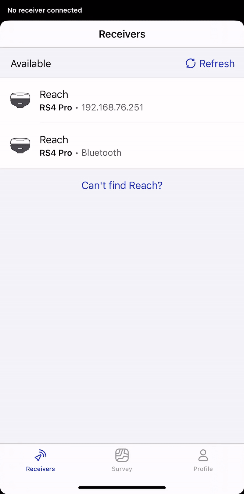

Open the Emlid Flow app.

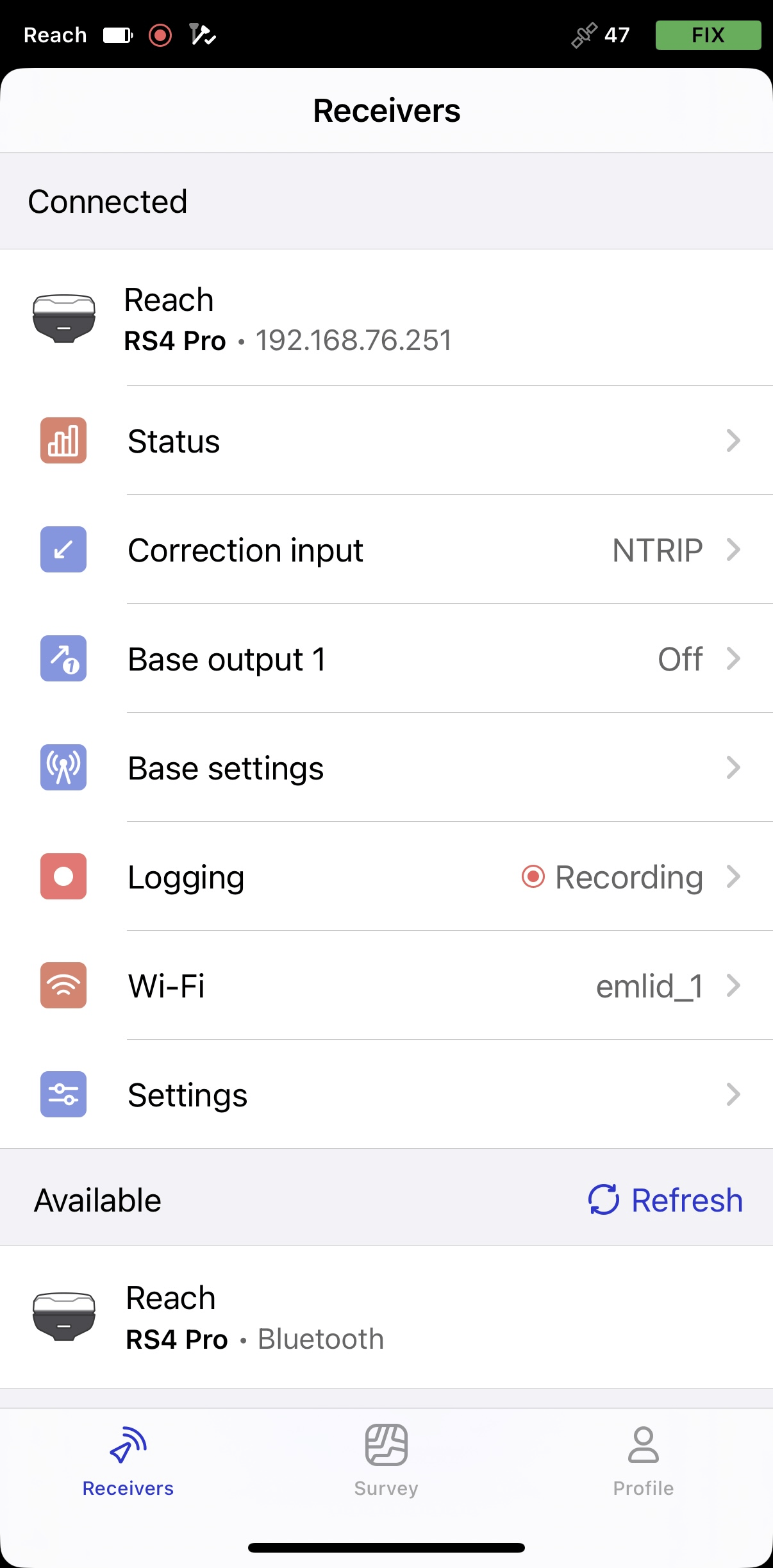

Find your Reach in the list of available devices and connect to it. If there is only one available device, Emlid Flow will automatically connect to it.
Find an IP address under the name of your Reach. Type this IP address in the address bar of your browser to open Reach Panel.
You can open Reach Panel from your phone's browser. To do this, tap the name of your Reach to open a menu, then go to Reach Panel.
