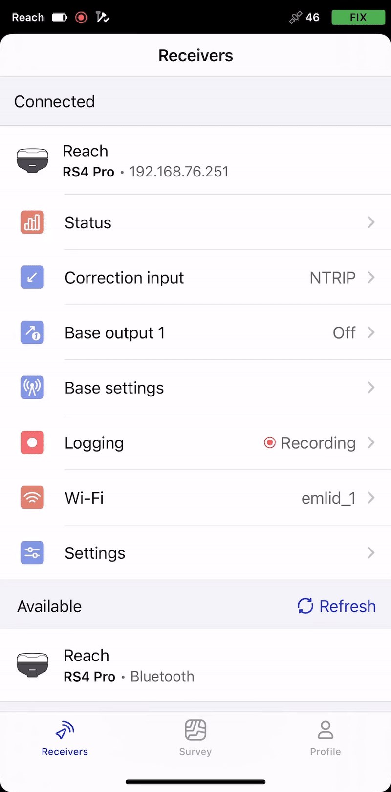

Open the Emlid Flow app and connect to your Reach.
Go to Settings.
In Troubleshooting, tap System report.
In the Full report section, tap Generate.
