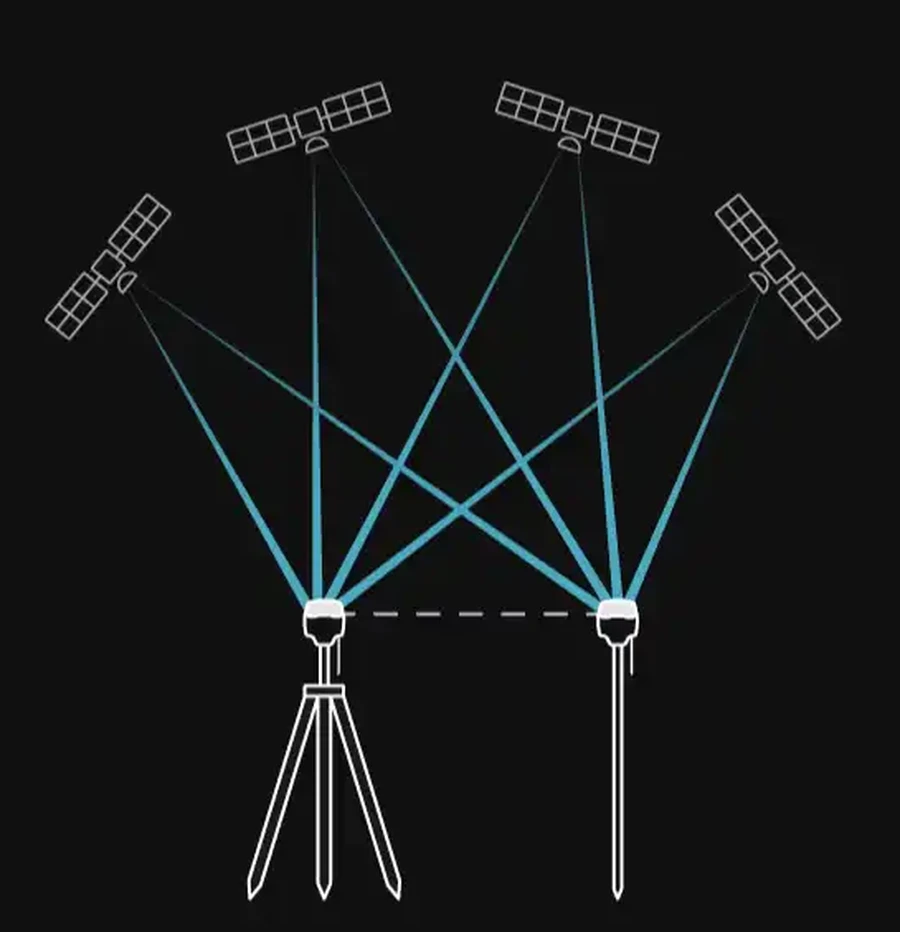

RTK (Real-Time Kinematic) is a satellite positioning technique that improves GNSS receiver accuracy from a few meters to a few centimeters in real time.
RTK works by using two receivers:
  • a stationary base station
  • a moving rover
The base station is placed at a known location and continuously receives satellite signals. It then sends its satellite observations and position data to the rover. Since both receivers observe the same satellites under nearly identical conditions, the rover can compensate for atmospheric and satellite-related errors and calculate its position with centimeter-level accuracy in real time.
