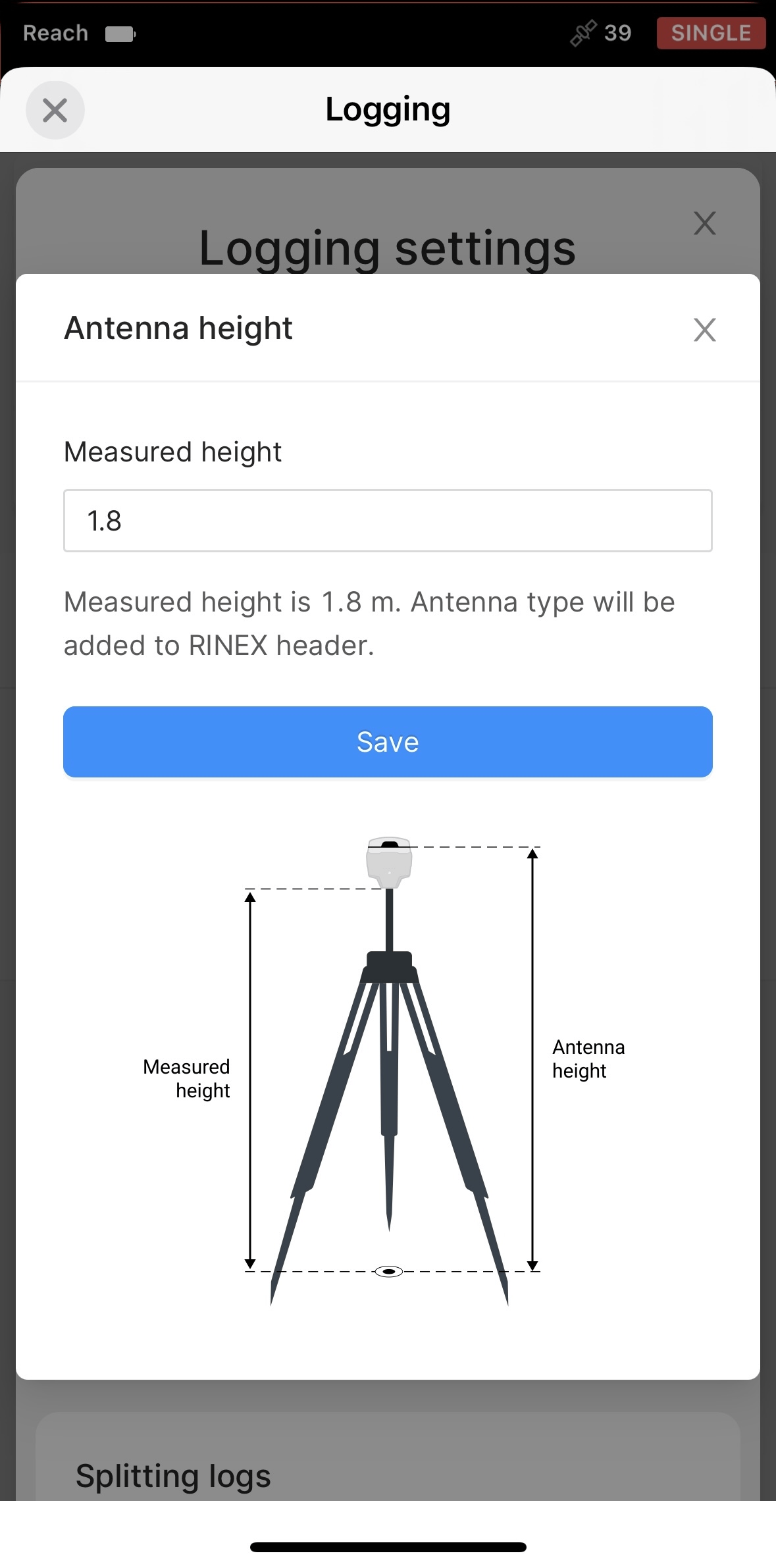

For GNSS receivers, antenna height is the distance from the mark on the ground up to the antenna phase center (APC). This height consists of two elements:
  • the distance between the mark on the ground and the center point on the bottom of the Reach, the antenna reference point (ARP),
  • the antenna offset between the ARP and APC.
In Emlid Flow, you only need to enter the height to the ARP, which is the height to the bottom of the receiver. The app automatically adds the antenna offset, which depends on your Reach model. Also, when you set the antenna height in one app section, it's updated everywhere else. This keeps the values consistent across the workflow.

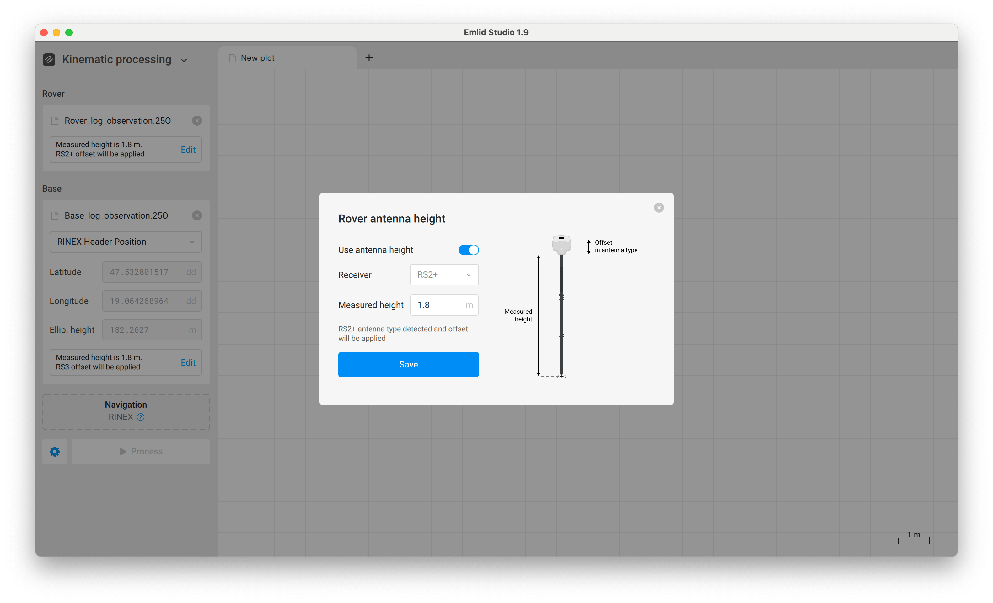

For PPK, your Reach device records logs in the RINEX format, which includes the antenna height in the observation file header. Emlid Studio reads this value during post-processing and uses it to calculate accurate ground positions. If needed, you can review and adjust both the base and the rover antenna height directly in Emlid Studio.

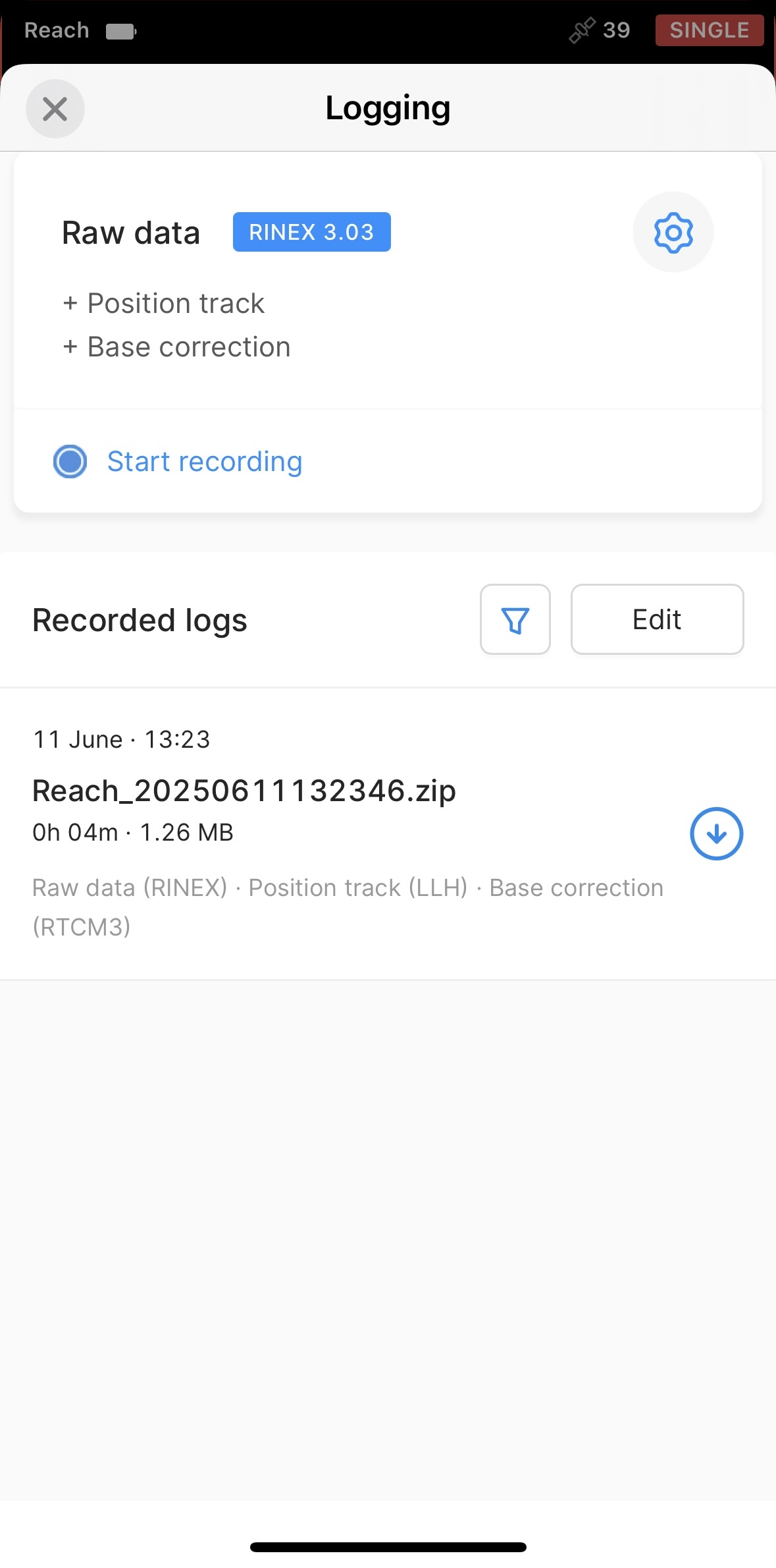

  1. Open the Emlid Flow app and connect to your receiver.
  2. In the Receivers tab, tap Logging.
  3. Go to the Recorded Logs and Settings tab and tap the blue gear button.
  4. Under the Info for RINEX header, tap Edit and set the measured height of your tripod or survey pole.
  5. Tap Save, then Apply, and start Logging.
You can also adjust the antenna height for both the base and rover later during data processing in Emlid Studio if needed.
