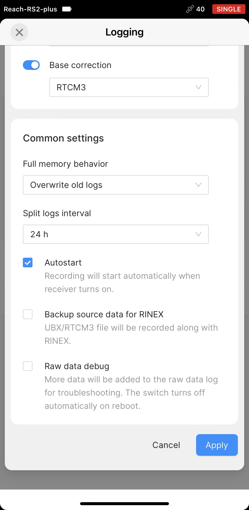

To record logs for NRCan CSRS-PPP, perform the following steps:
  2. Go to the Logging screen.
  3. Tap the Recorded logs and settings button.
  4. To configure logging, tap the blue gear button.
  5. Enter the log name.
  6. Select the CSRS preset.
  7. Choose the required RINEX format in the Raw data section.
  8. Enter the measured height to the bottom of the receiver in the corresponding field.
  9. Fill in the point's name in the Marker name field.
  10. Tap Apply.
  11. Enable log recording by tapping the Start recording button. The red recording icon will appear in the status bar.
