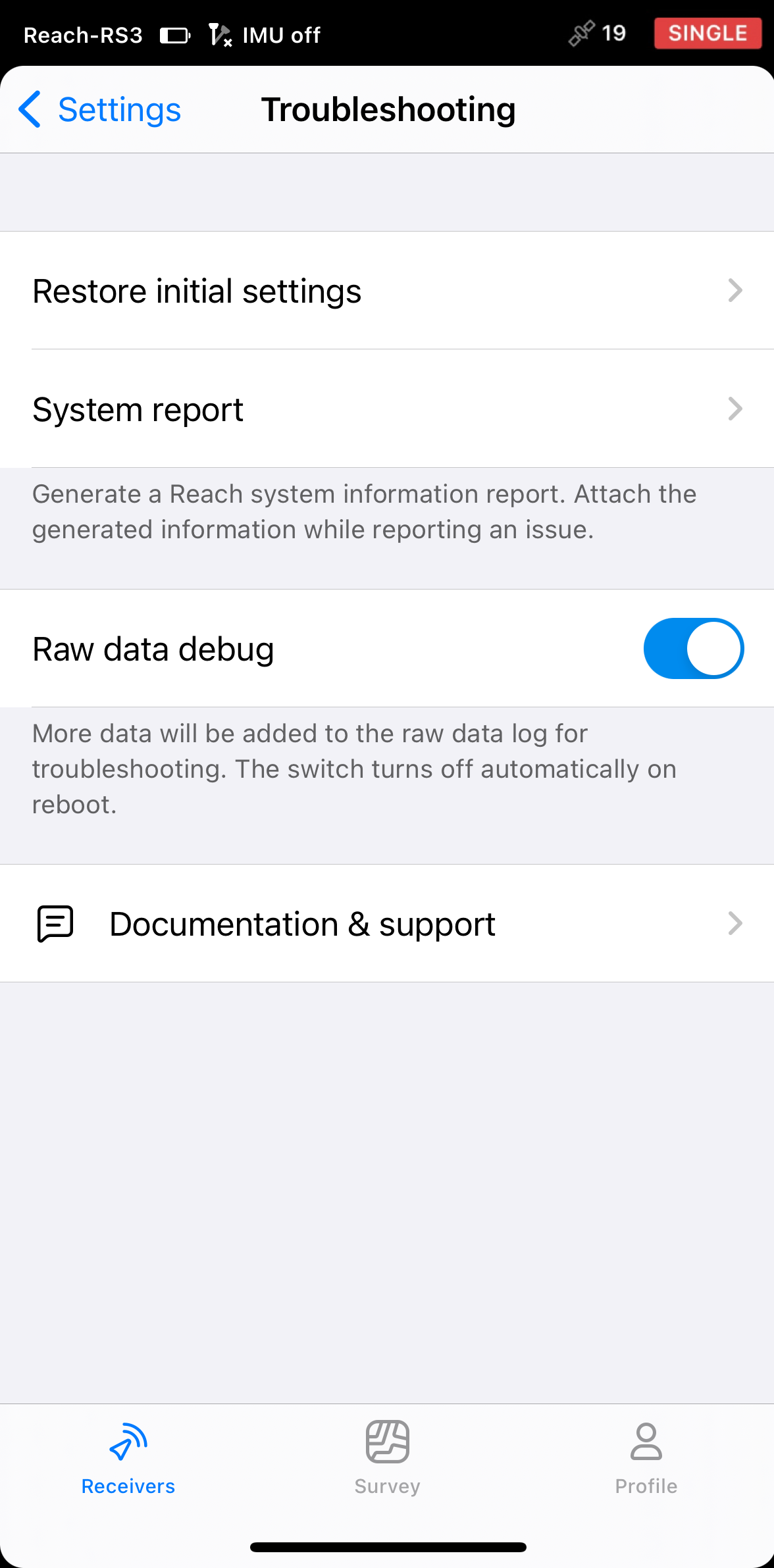

  2. Go to Settings, navigate to Troubleshooting, and enable Raw data debug.

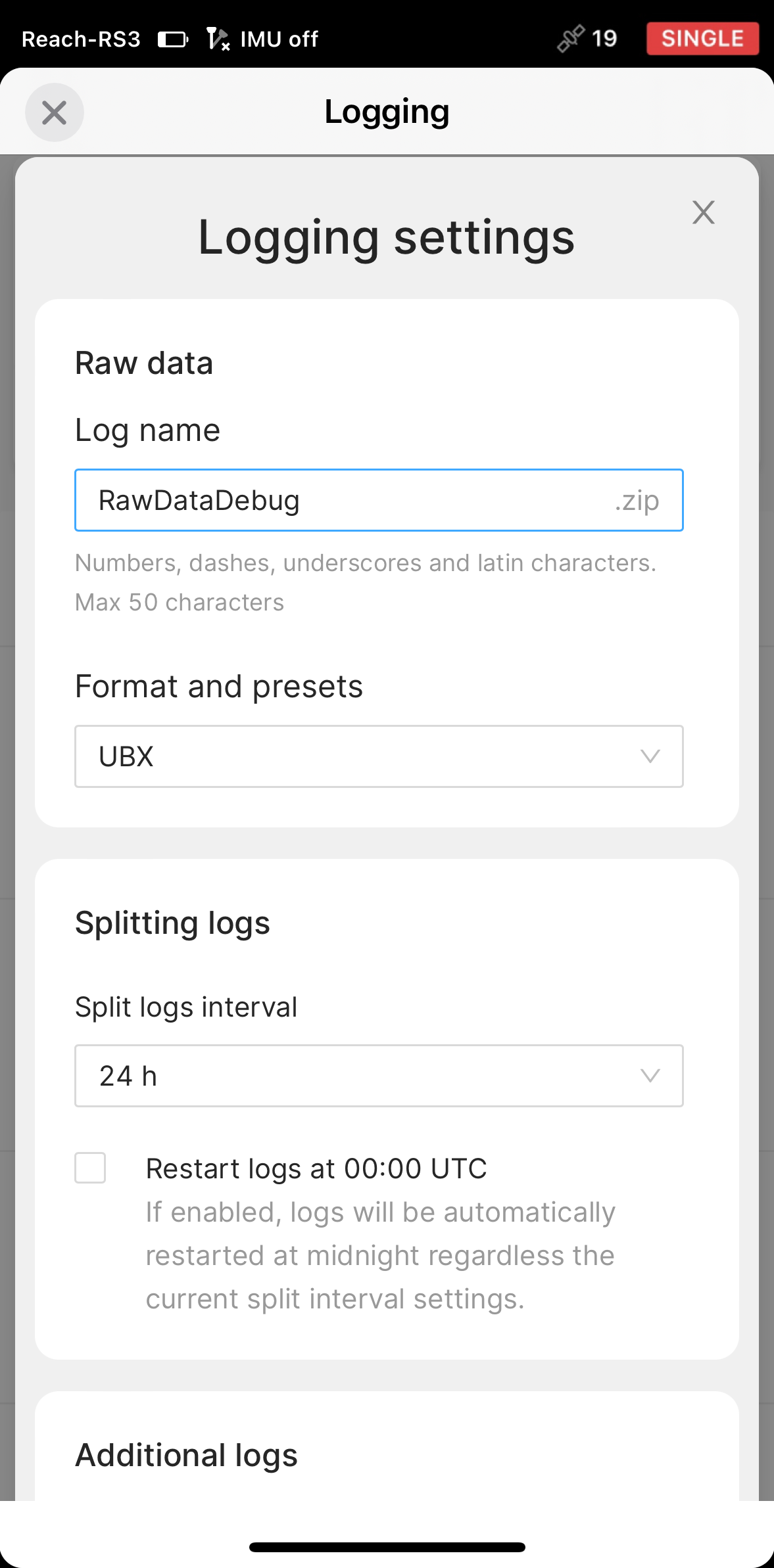

  3. In Logging, tap Recorded logs and settings, then tap the gear icon to configure raw data logging.
  4. Select the UBX format and record raw data logs as usual.

  6. Go back to Troubleshooting and turn the Raw data debug option off.
    The raw data debug option turns off automatically on a reboot of your Reach.
