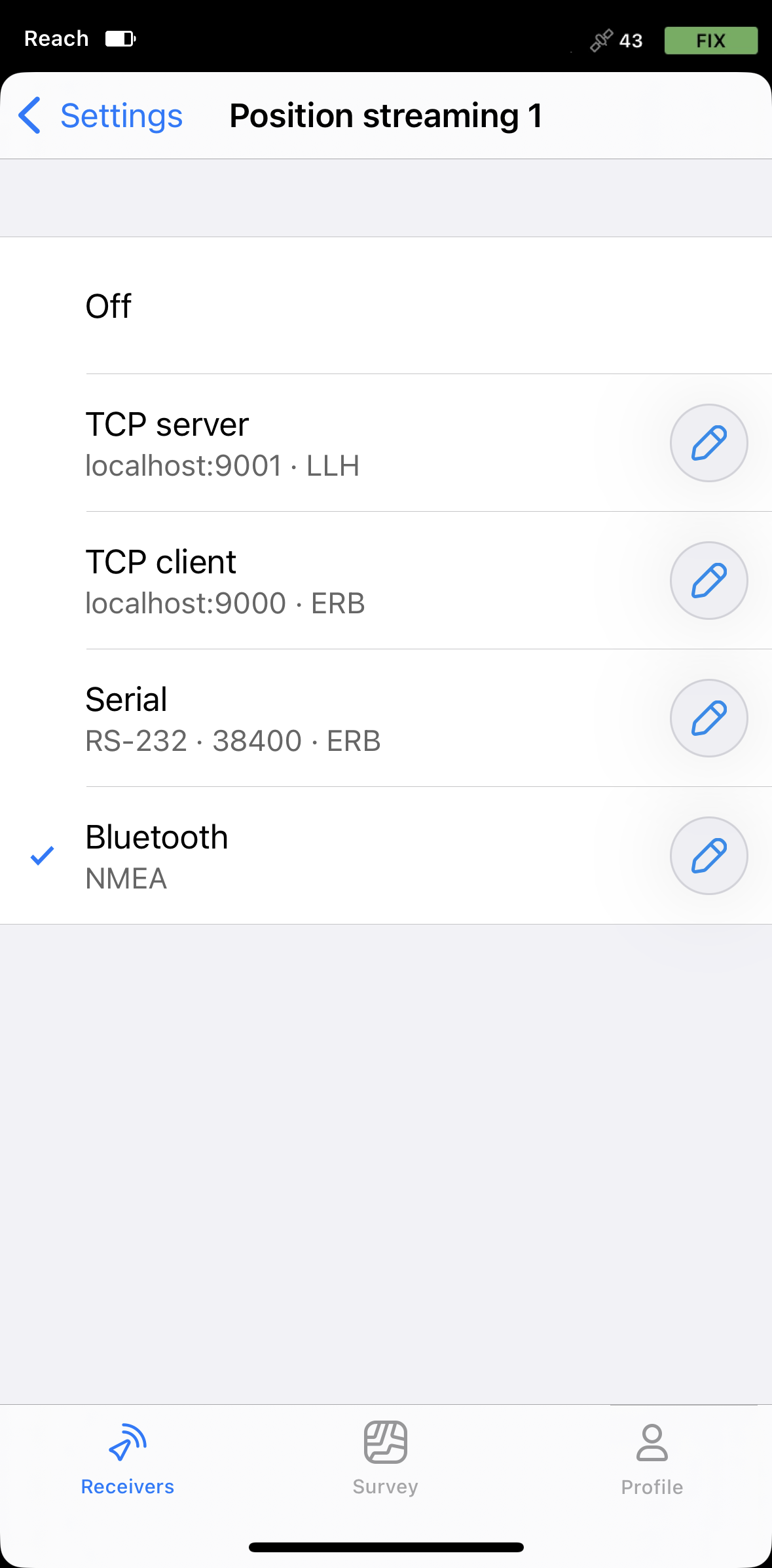

Stream position from Reach to Android
In Emlid Flow, go to Settings.
Tap Position streaming 1 and select Bluetooth.

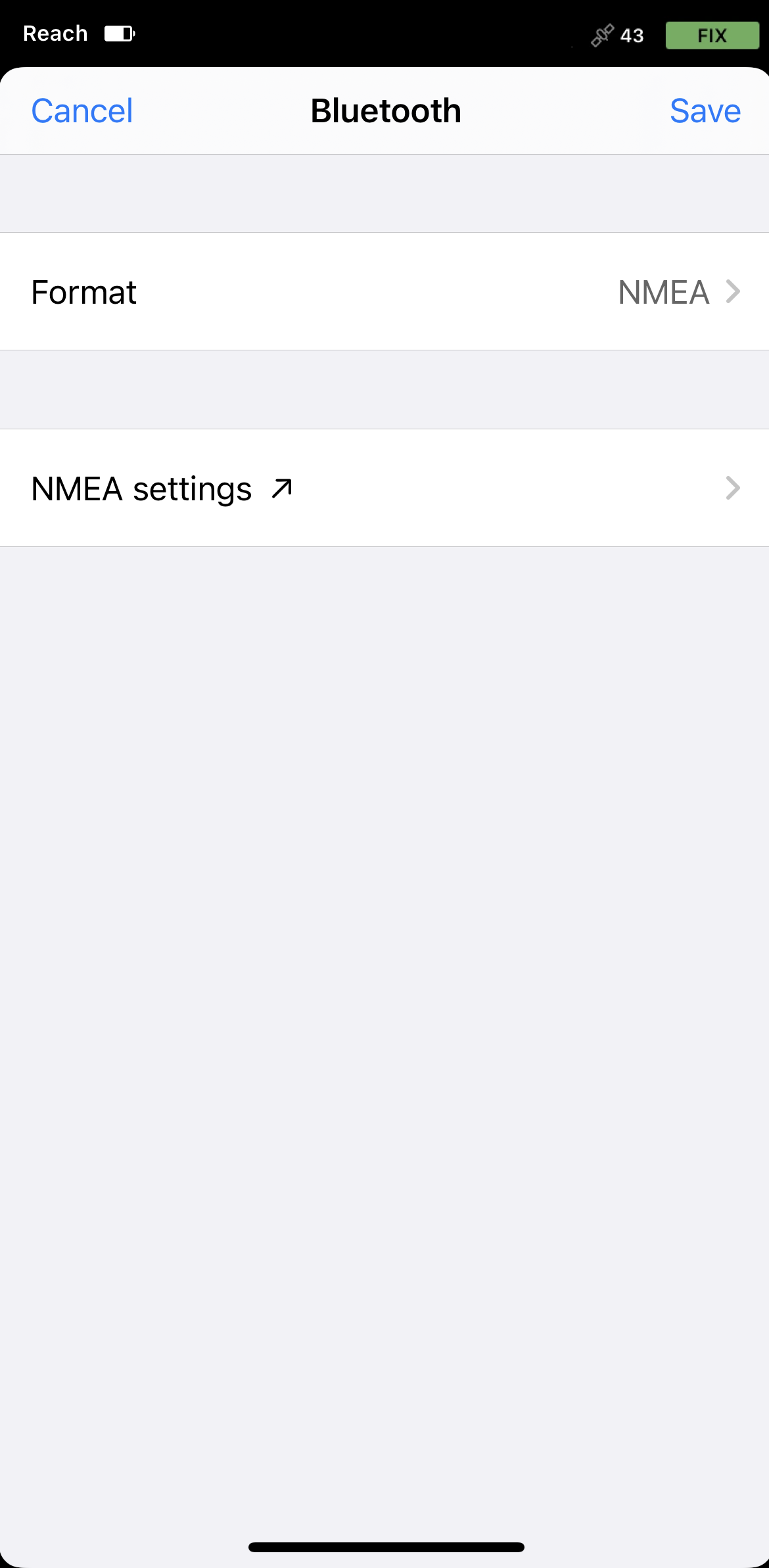

To configure position streaming, tap the Edit button in the Bluetooth cell.
noteWhen connected to your Reach via Bluetooth, Emlid Flow will prompt you to connect to the Reach hotspot to access the streaming configuration settings.
Tap Format and choose NMEA.
Apply the necessary changes.
