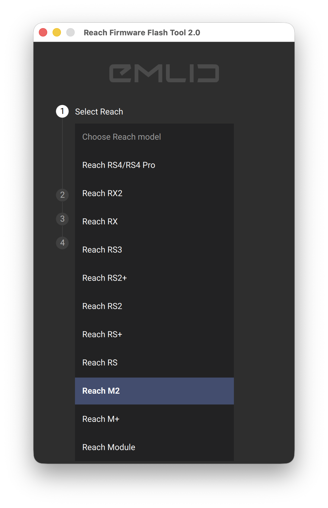

  1. Open Reach Firmware Flash Tool and choose Reach M+ or Reach M2.
    You can also press the Return/Enter button to proceed to the next step.

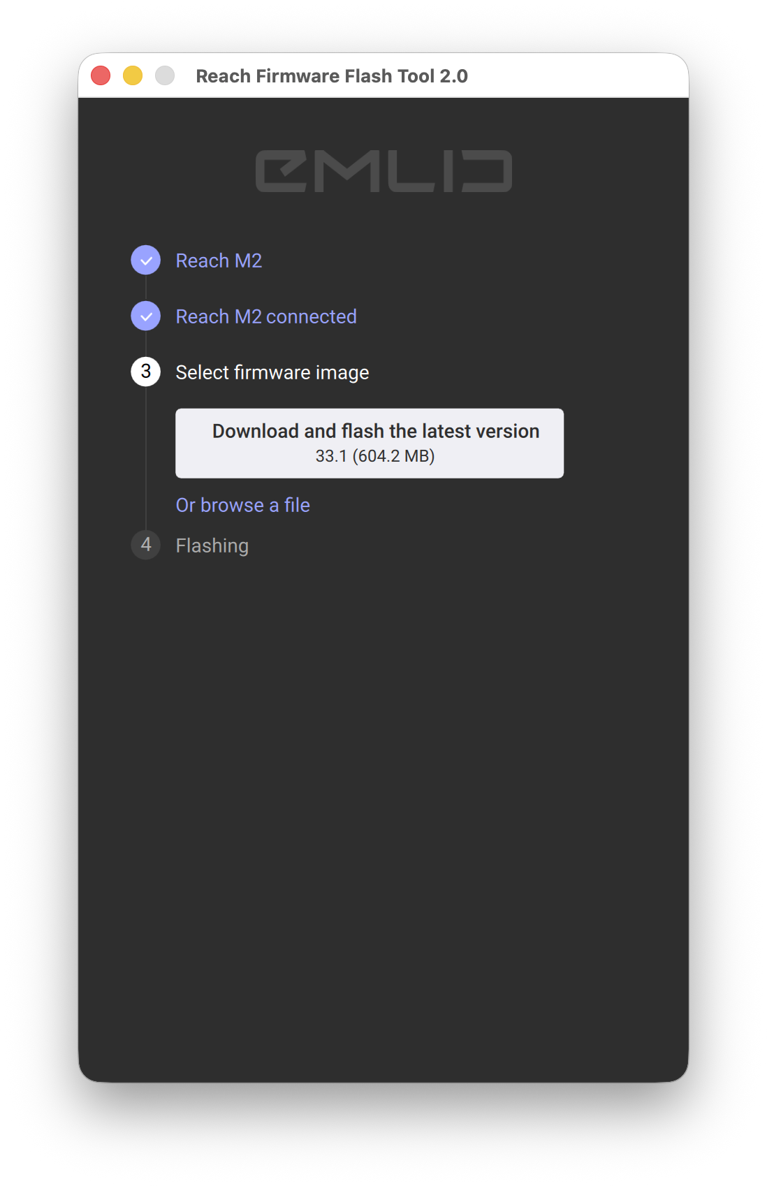

  3. Click Download and flash the latest version. The tool will download the latest firmware image and begin the flashing process.
    Make sure you have enough disk space. Reach Firmware Flash Tool creates 2 folders: one to download the image and another one to unpack it. Once you close the Flasher tool, the folder with the unpacked image will be deleted.

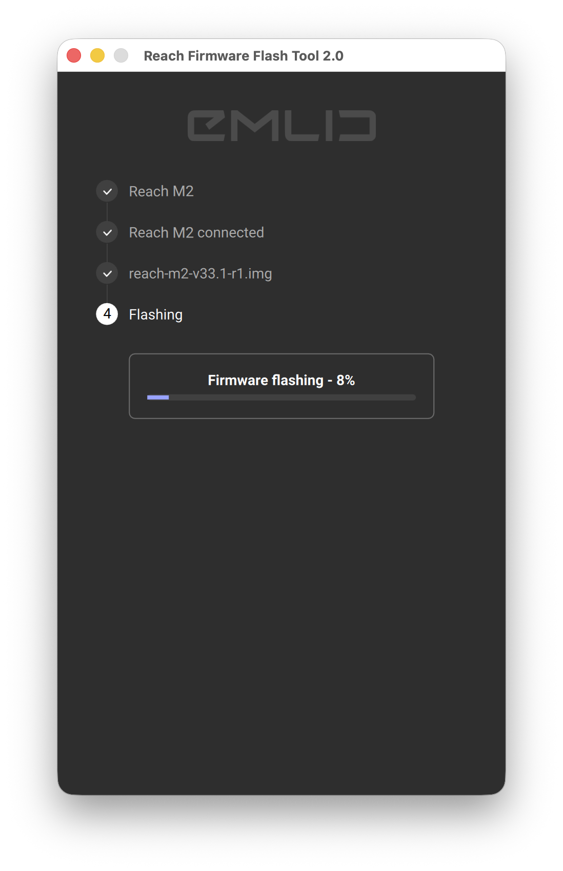

  4. Wait until the end of the flashing process.

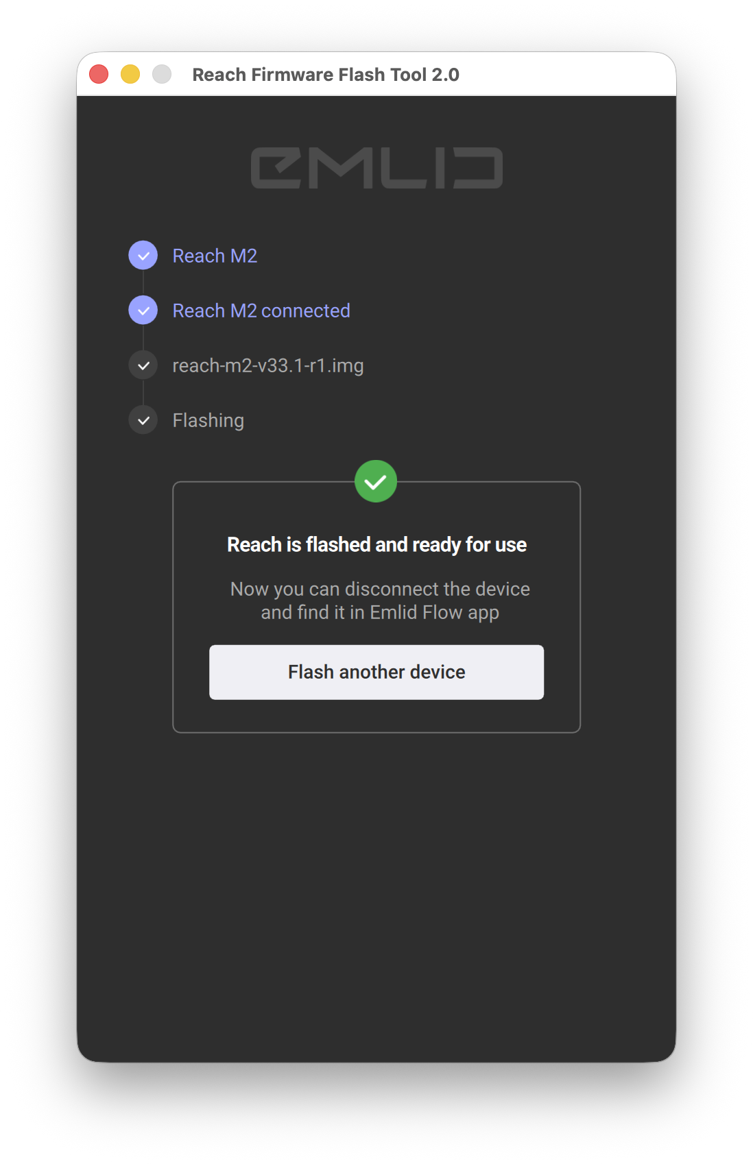

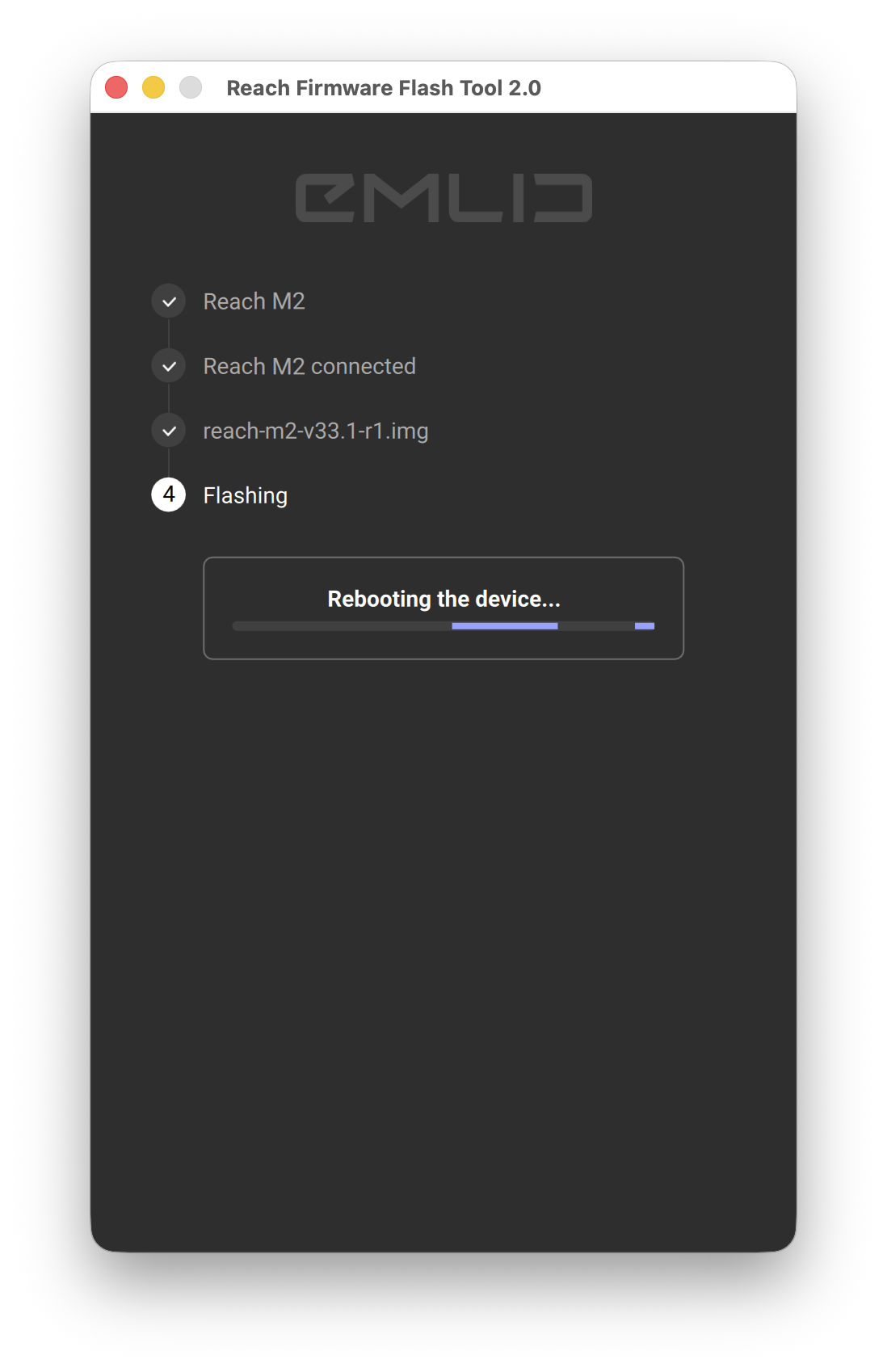

  5. Wait until Reach reboots after reflashing. When Reach successfully reboots, you will see the "Reach is flashed and ready to use" message.
    Do not unplug your unit on this step.
