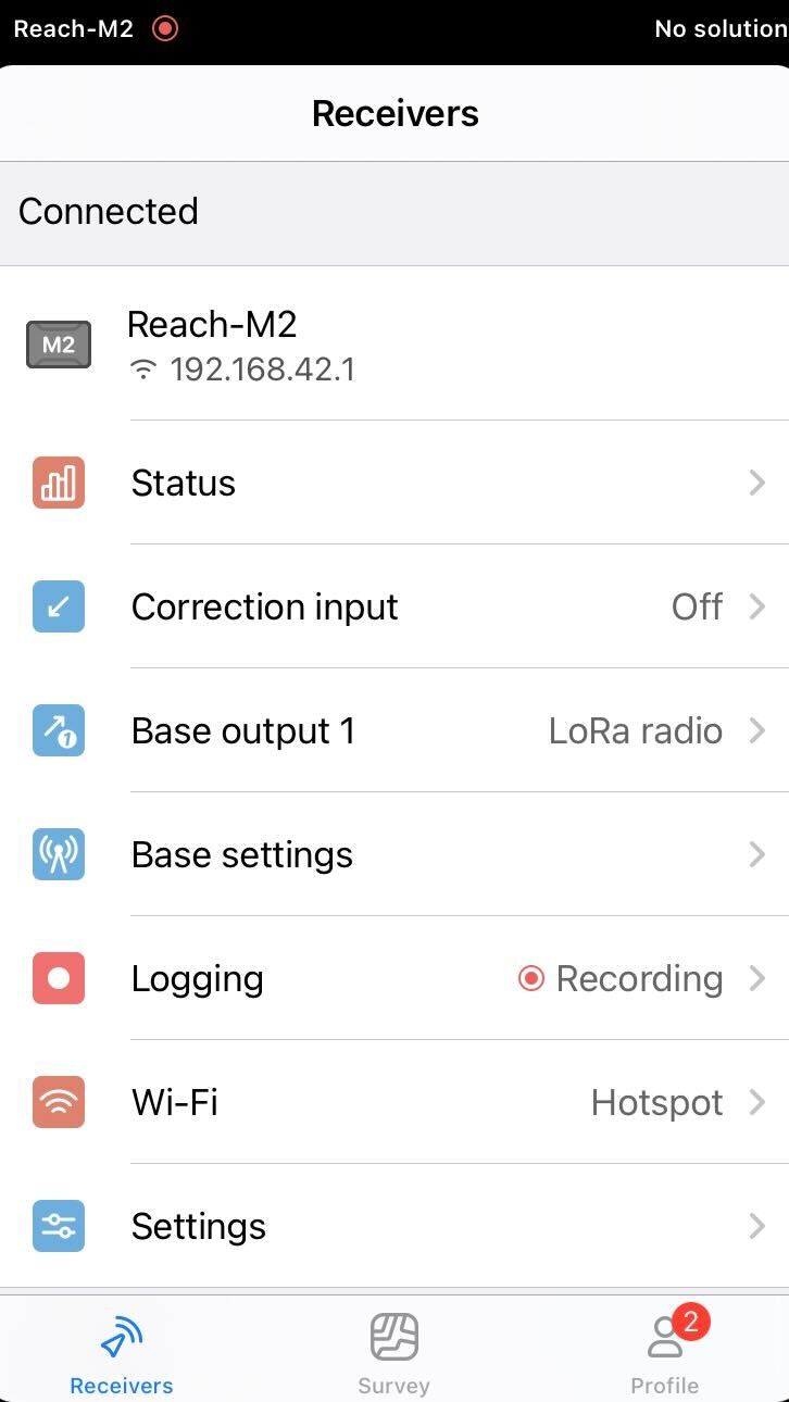

  2. Go to the Logging screen.
  3. Tap the Recorded logs and settings button.

  10. Enable log recording by tapping the Start recording button. The red recording icon will appear in the status bar.

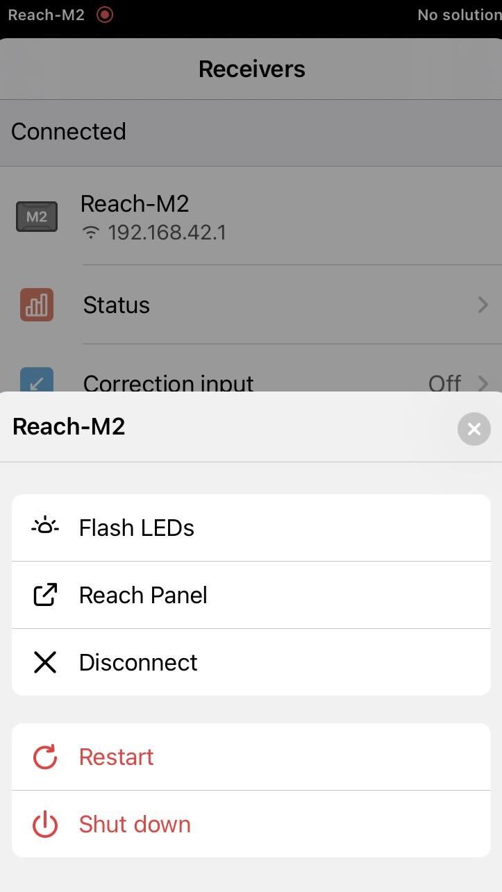

  1. Go back to the Receivers tab, tap the receiver icon and shut it down.
    Before pulling out the cable from a power source, wait for at least 15 seconds for the system to shut down properly.
