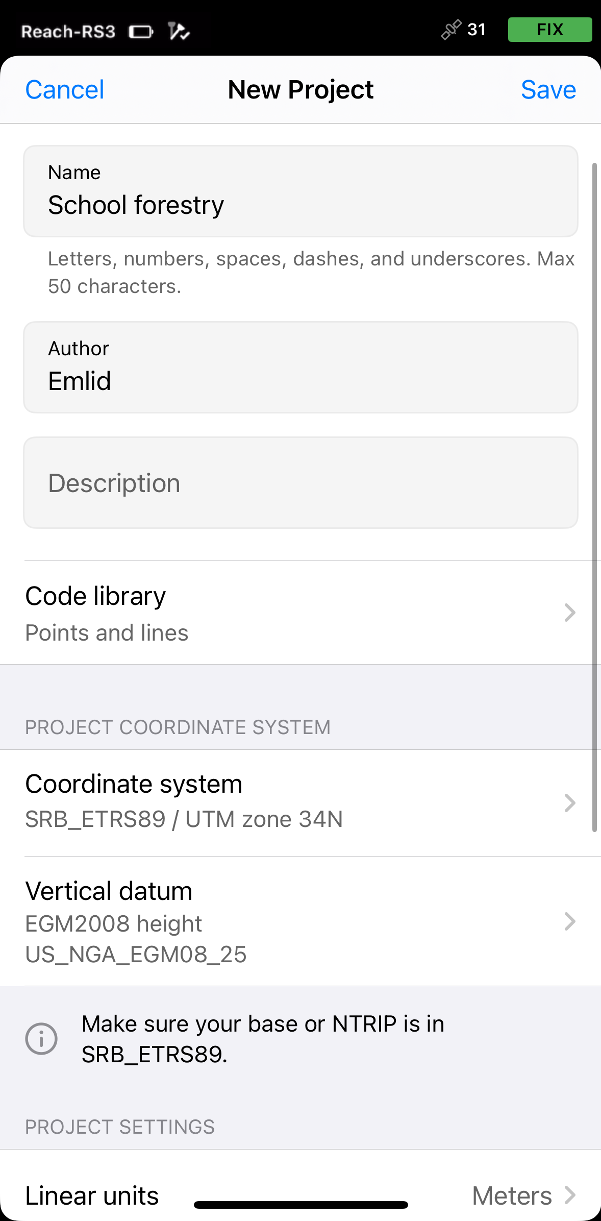

  3. Create a survey project or open the existing one in Emlid Flow. We will create a new one.

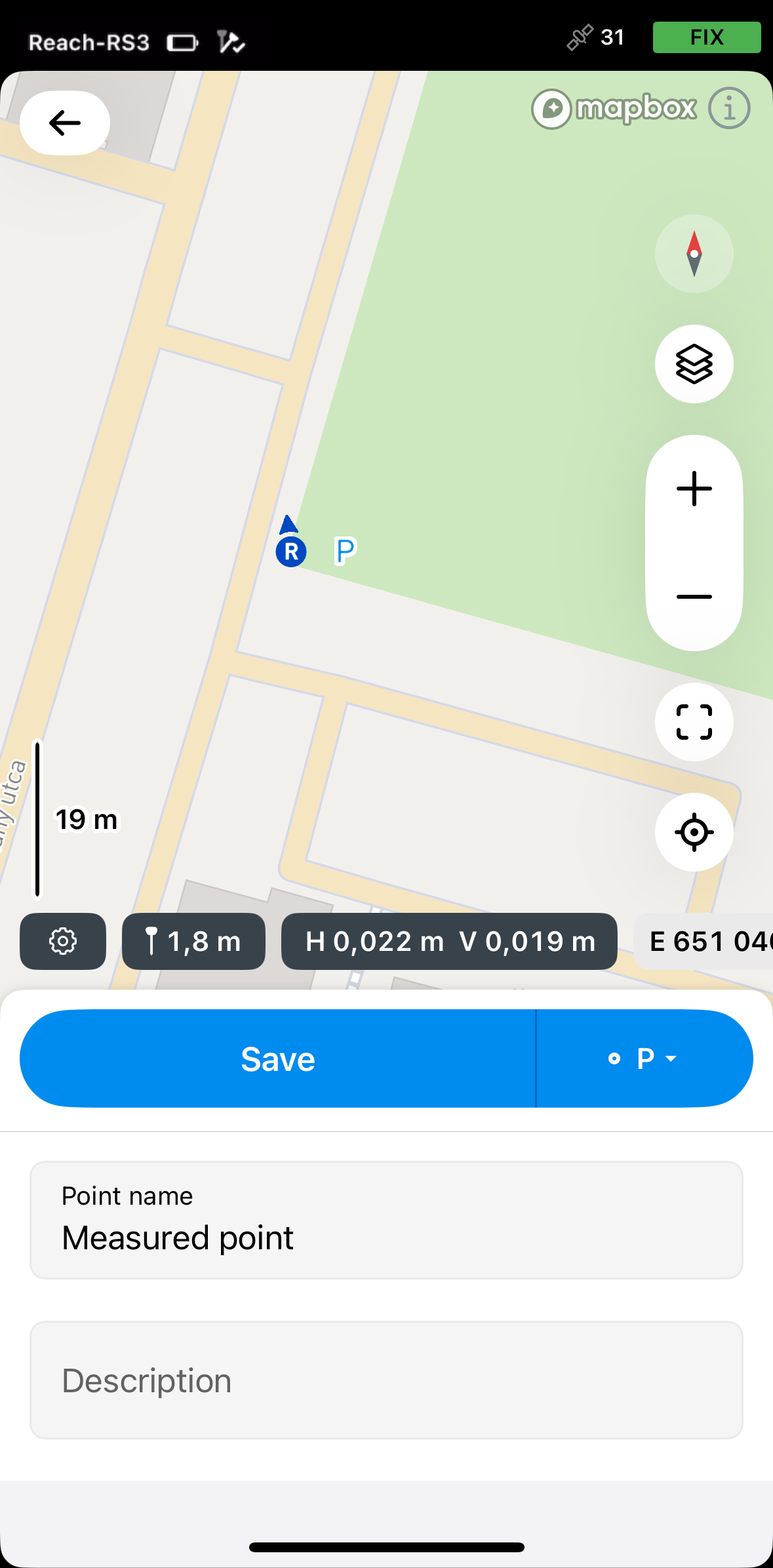

  4. Place the rover over the permanent survey mark and collect it. Tap Save. This will be a measured point.

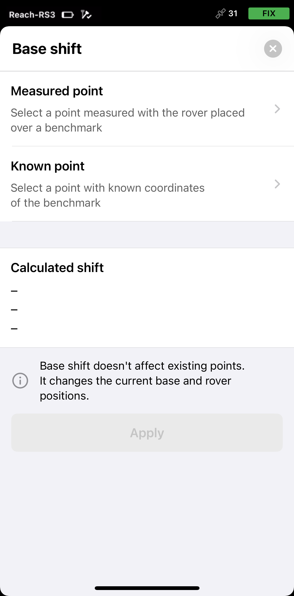

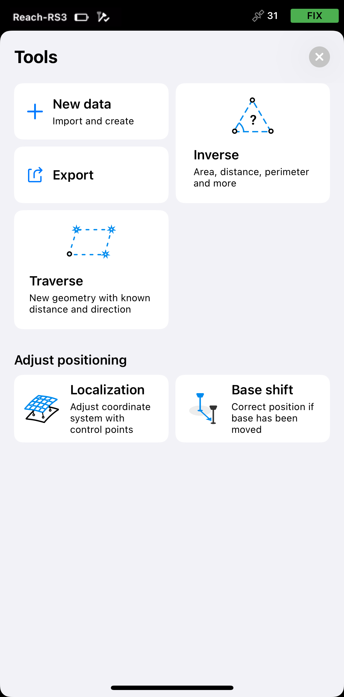

  5. Go back to the map, tap the Tools icon and select Base shift.

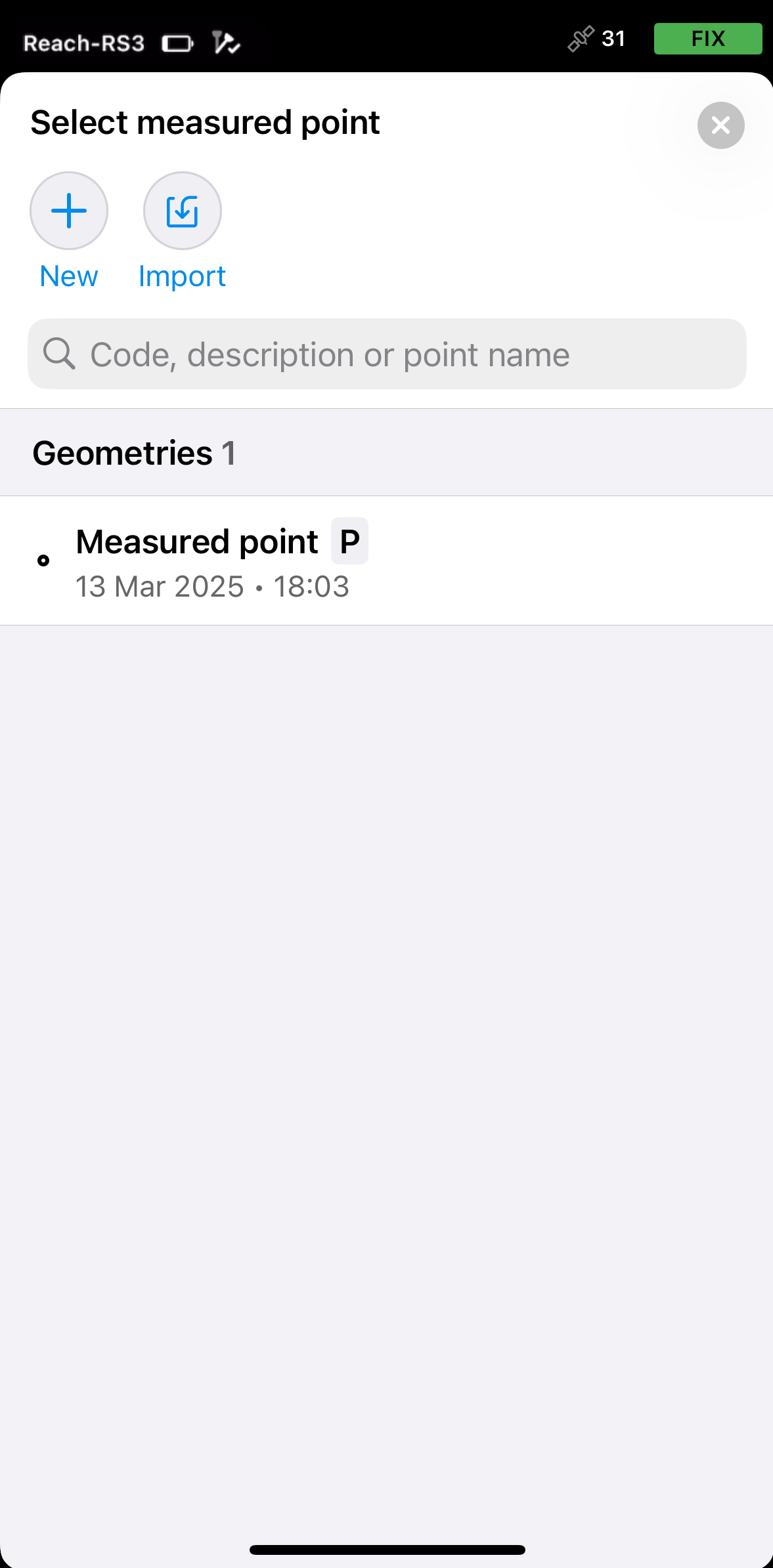

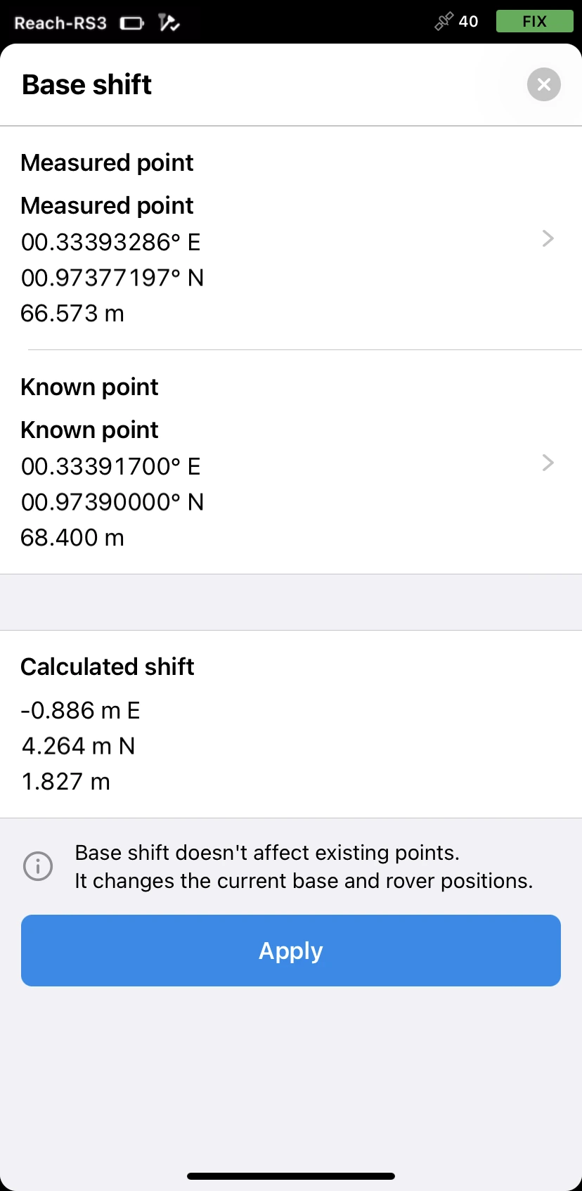

  6. On the opened screen, tap Measured point and select the point that you collected.

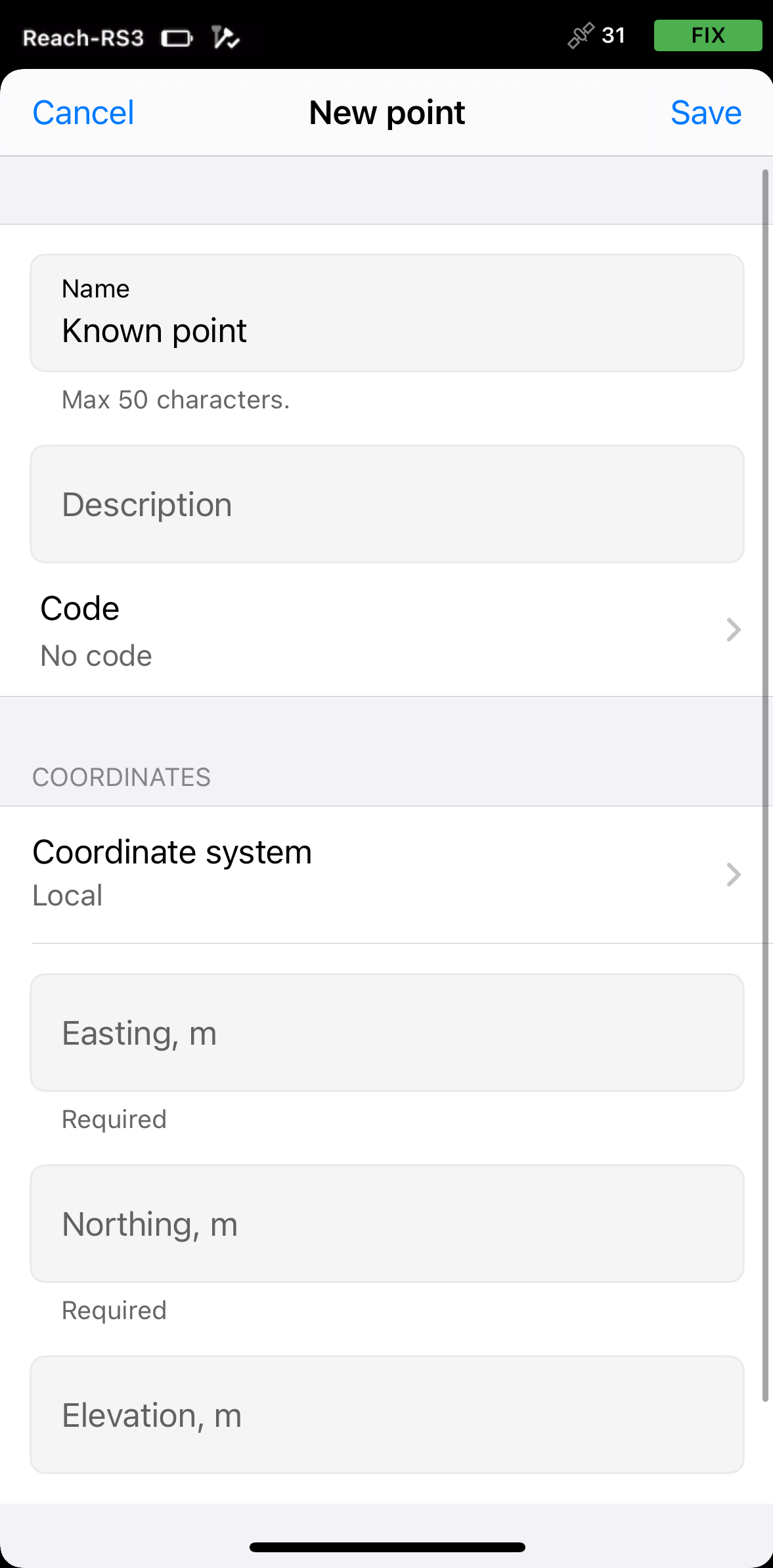

  7. On the Base shift screen, tap Known point, then enter the PSM coordinates or select it from the list if it's already in the project.
  8. Tap the Apply button to activate the shift.

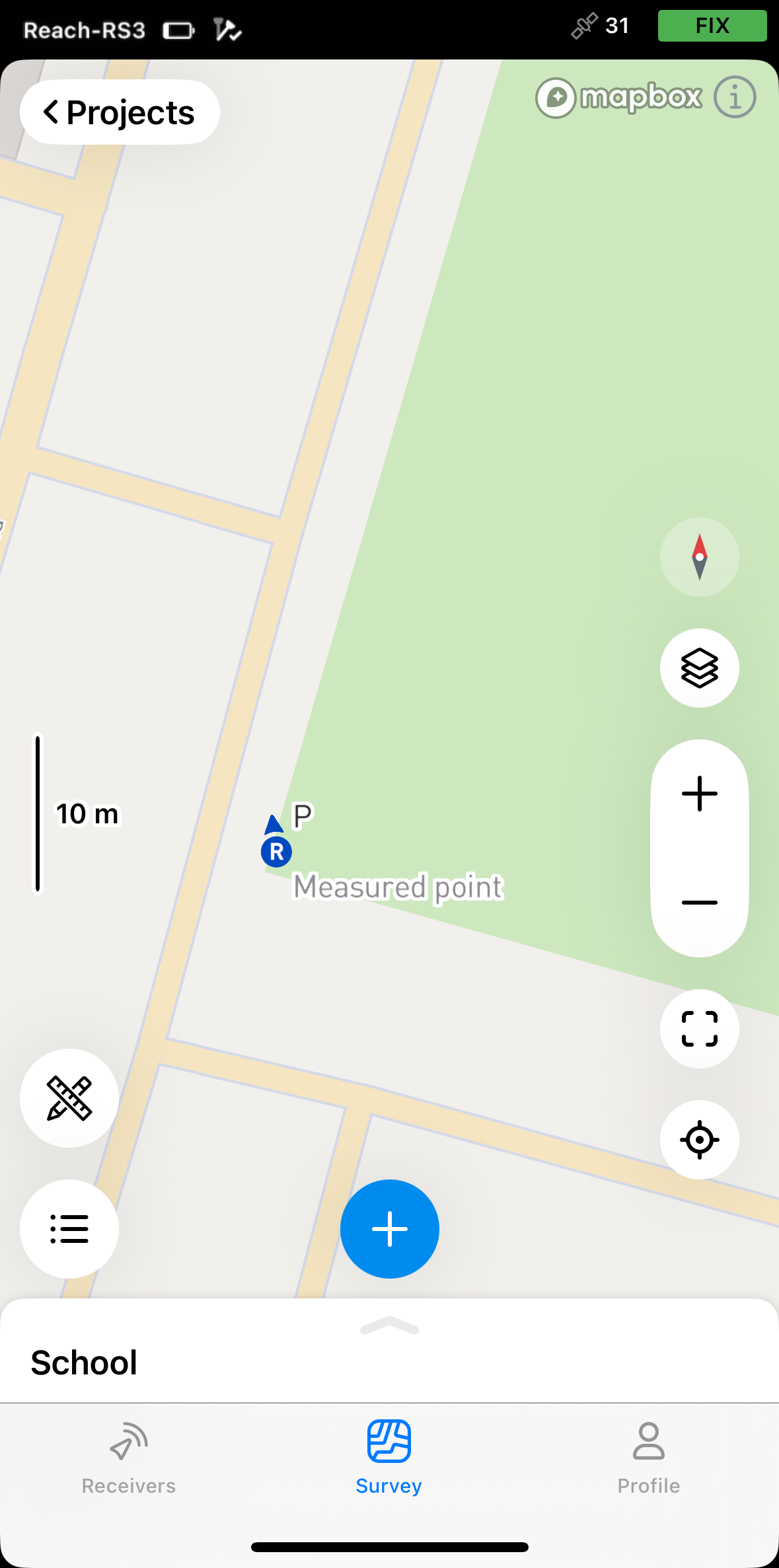

When the shift is applied, you’ll see that it’s active in the project’s overview, and the rover icon on the map appears shifted.
Right from this moment, Emlid Flow starts applying base shift to all the points you collect further. In our case, it means that all points collected after base shift will be positioned exactly relative to the permanent survey mark.
