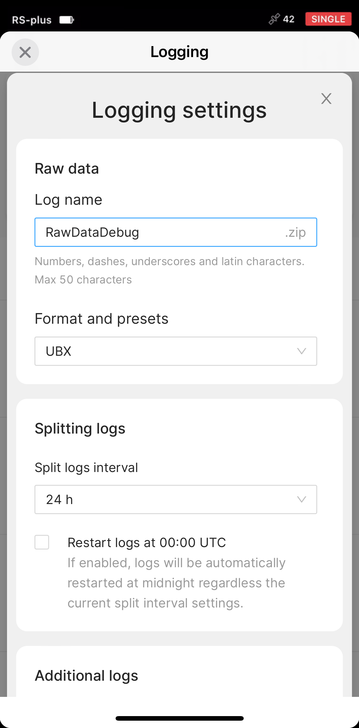

The raw data debug option works only for the raw data logs in the UBX format. You can enable logging in the UBX format in the logging settings in the ReachView 3 app.

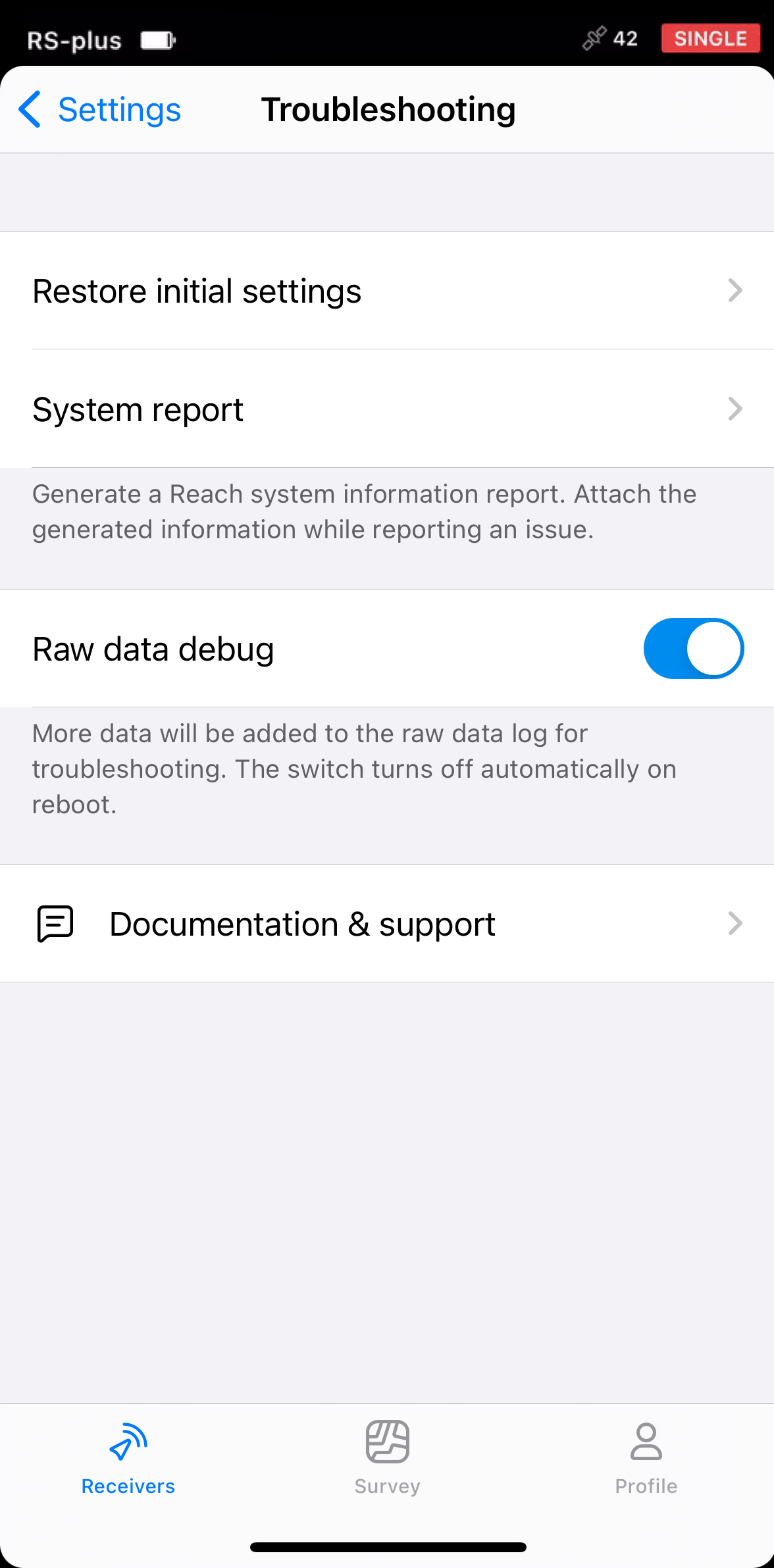

  1. Open the ReachView 3 app and connect to your Reach.
  2. Go to Settings.
  3. Tap General.
  4. In Troubleshooting, turn the Raw data debug option on.

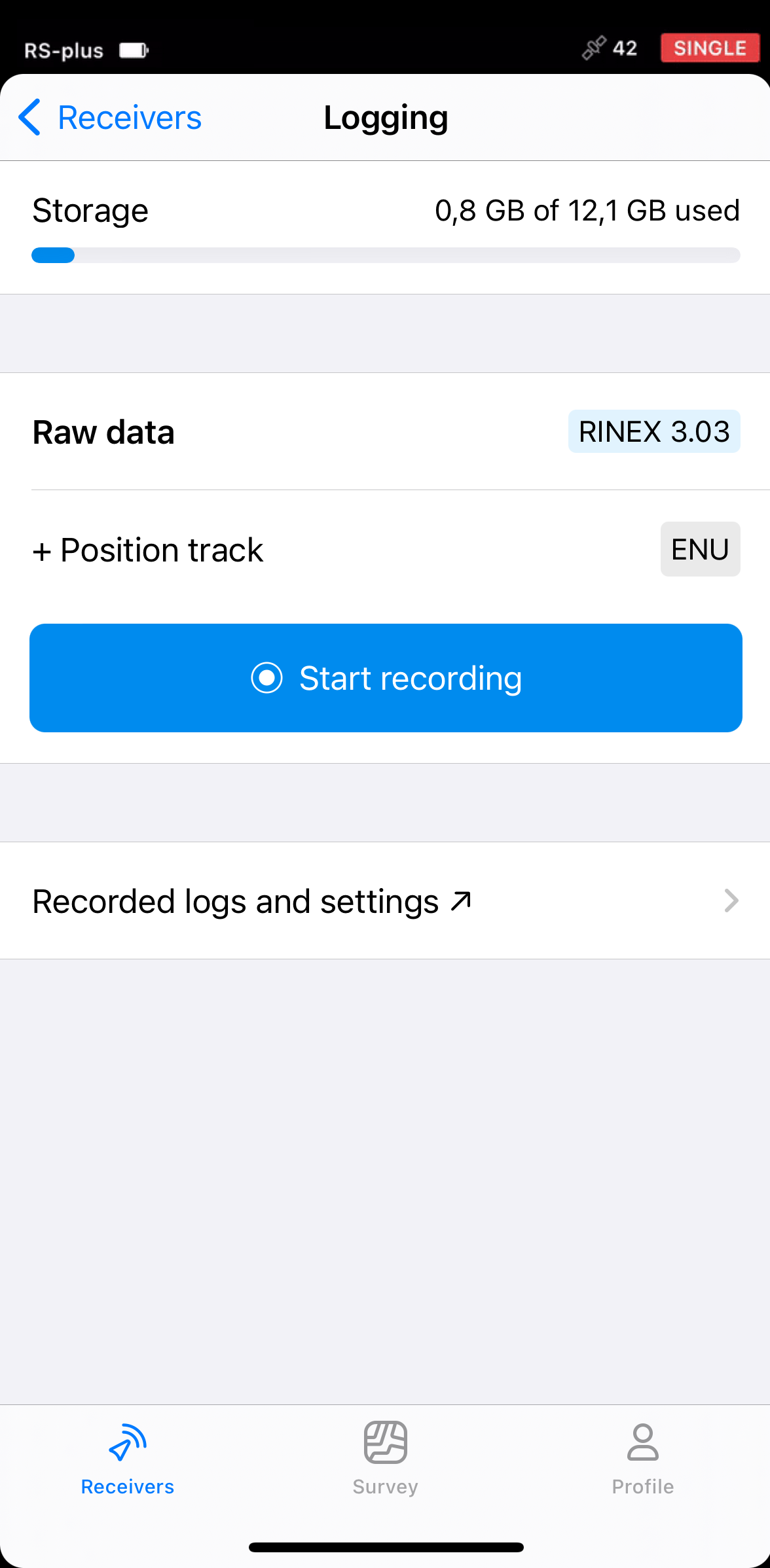

  1. Record raw data logs as usual.
    You can read how to record logs here.

  3. Go back to Troubleshooting and turn the Raw data debug option off.
    The raw data debug option turns off automatically on a reboot of your Reach.
