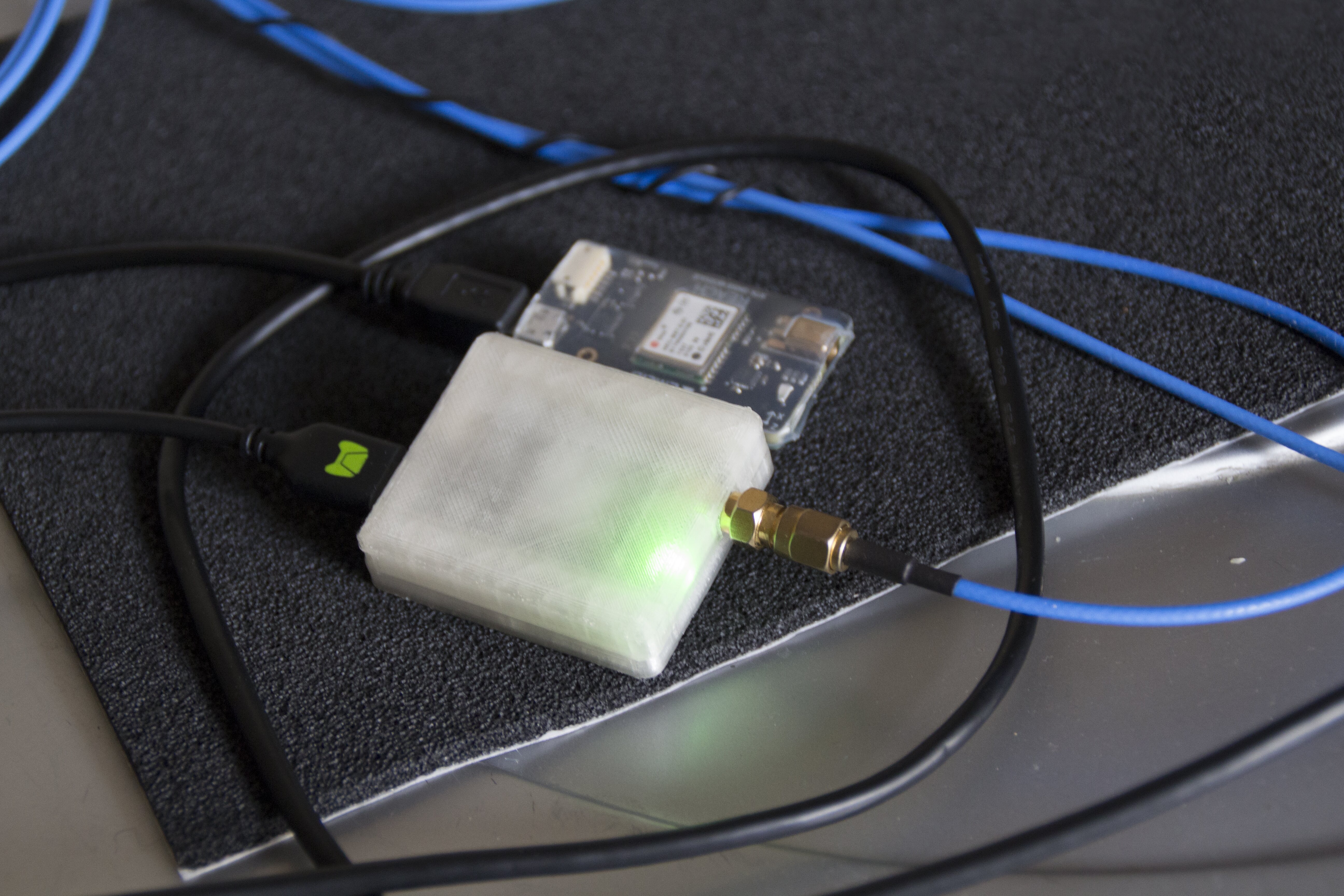

3D cases​
Depending on your hardware setup, you can choose the case model from the following printable 3D cases available for Reach Module users:
Reach Module case model C:
Download top and bottom halves of the case to print it.
Reach Module case model D:
Reach Module case model E:
remarque
For assembly cases D and E, use DIN-7981 screw (thread size 2.2 mm, length either 6.5 or 9.5 mm). Model C can be assembled using scotch tape.

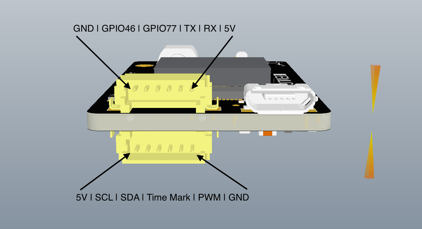

Connectors pinout​
  • GPIO46, GPIO77, PWM, SCL, SDA, TX, RX are connected to Intel Edison via buffers and are 3.3 V logic level, 5V tolerant
  • TX and RX belong to UART1 on Intel Edison
  • SCL and SDA belong to I2C1 on Intel Edison, I2C1 also could be used to communicate with internal magnetometer in MPU9250
  • PWM belongs to PWM3 GPIO183 on Intel Edison
  • Time Mark input is connected directly to U-blox chip for low latency, it includes an over-voltage clamp, pull up and current limiting resistor
