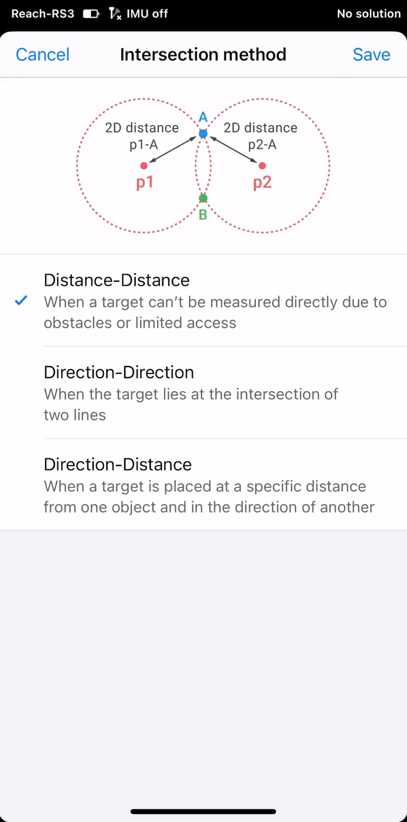

  4. Tap Method and select the required calculation type. By default, the tool uses the Distance–Distance method.

Applying Distance-Distance method
Use the Distance–Distance method to define a new point based on its distance from two known reference points. The app generates two circles—each centered on a reference point with a radius equal to the entered distance. The intersection of these circles produces one or two possible locations. Select the appropriate one based on the site context.
There are specific cases based on the entered distance values where no intersection can be calculated:
  • If the distance between the two reference points is greater than the sum of the entered distances.
  • If the distance between the two reference points is less than the absolute difference of the two entered distances, i.e one circle is completely inside the other.
The apps apply 2D grid distance.
  1. Select the first point on the map or from the list. It will be displayed in red.
  2. Specify the distance. You’ll see a red circle, the radius of which corresponds to the specified distance.
  3. Select the second point on the map or from the list. It will be displayed in red.
  4. Specify the distance. You’ll see the second circle, the radius of which corresponds to the specified distance. The app will simultaneously display the intersection of the two circles, resulting in two possible point locations named A and B. It will provide the coordinates for both options—select and save the one your project requires.
