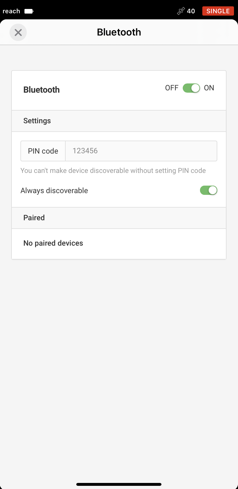

- In the Emlid Flow app, go to the Bluetooth screen. Turn on Bluetooth and make Reach always discoverable

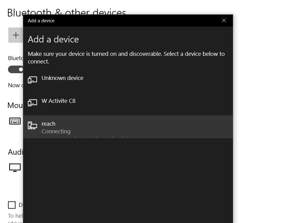

- On the data collector, go to the Bluetooth settings and select Add a Bluetooth Device. Select Reach from the list of discovered devices and confirm the connection
- When pairing is completed, you will see the data collector is listed in Emlid Flow

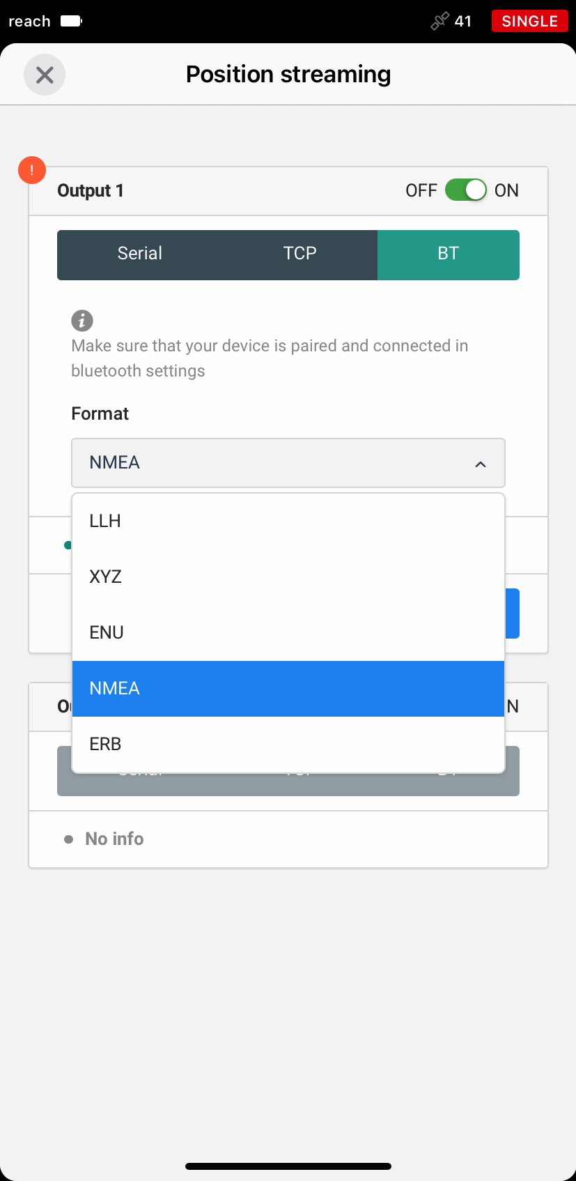

Position Streaming
- Go to Position streaming in Emlid Flow and select Bluetooth. Select NMEA format and click Apply

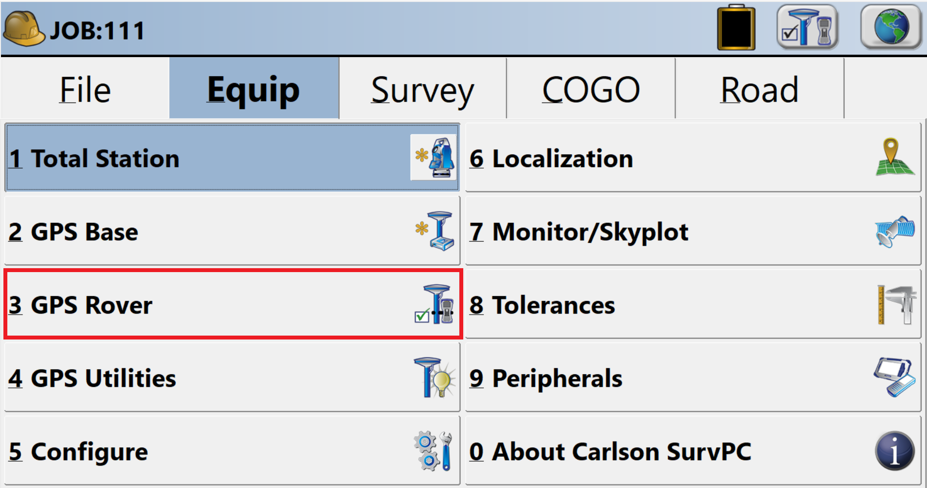

- After launching SurvCE and creating a new project, go to the Equip tab and select GPS Rover

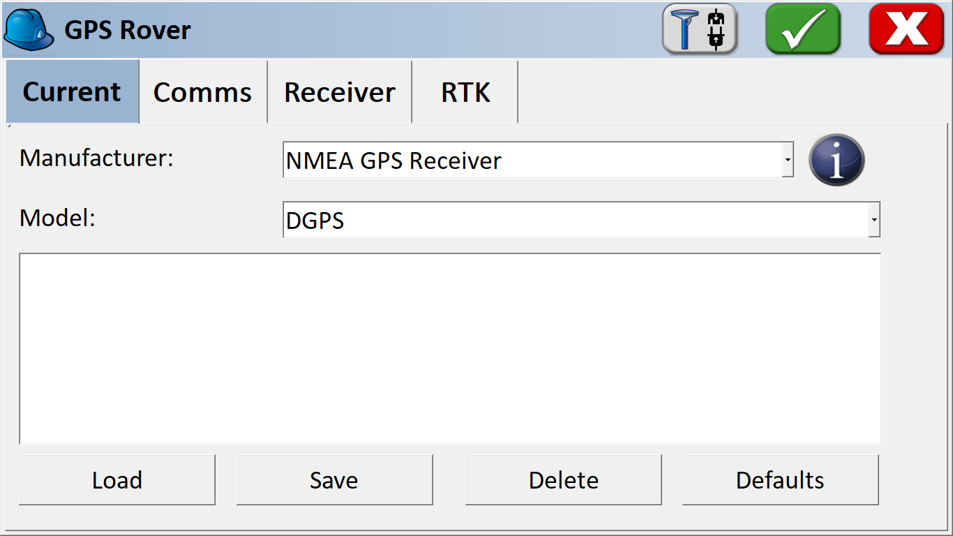

- Select NMEA GPS Receiver as Manufacturer and DGPS as Model

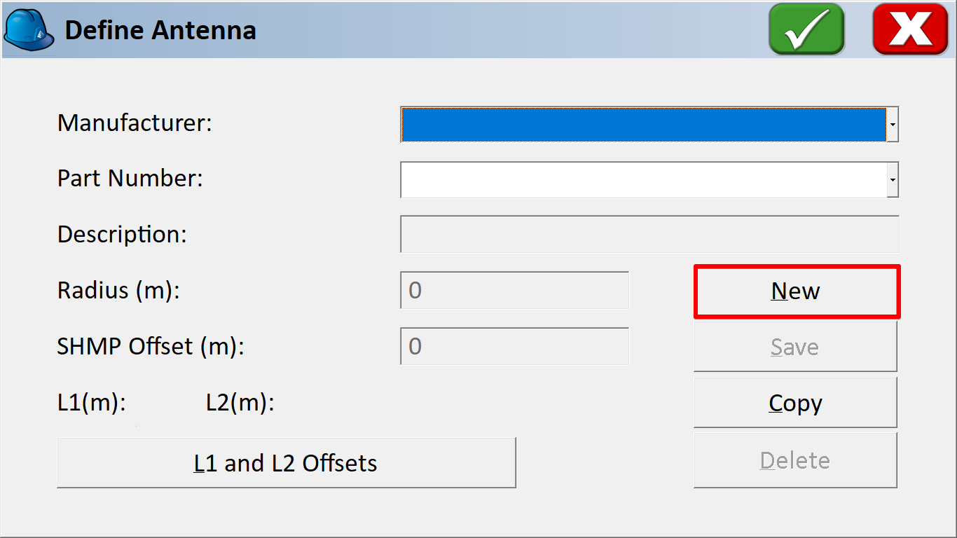

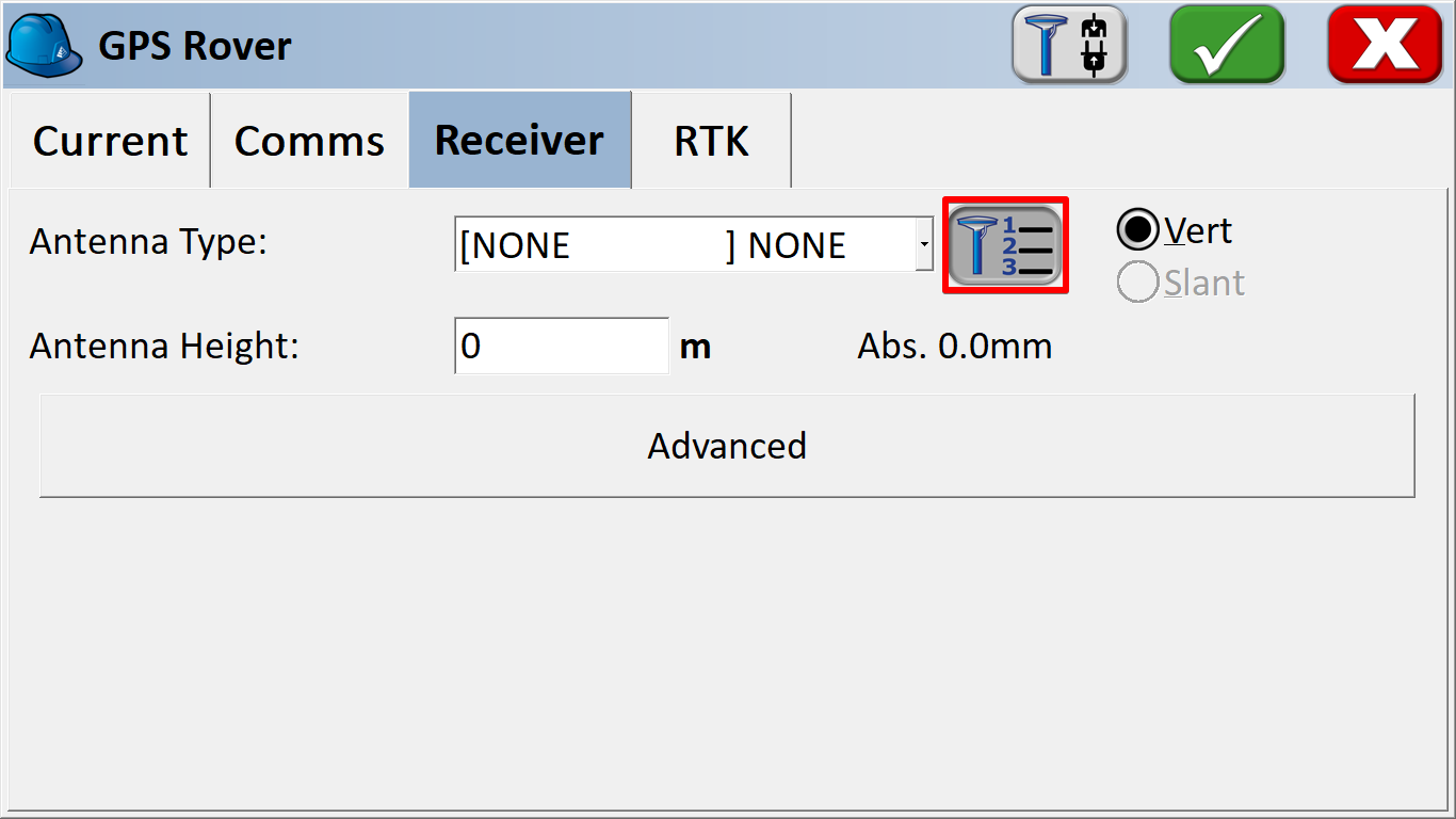

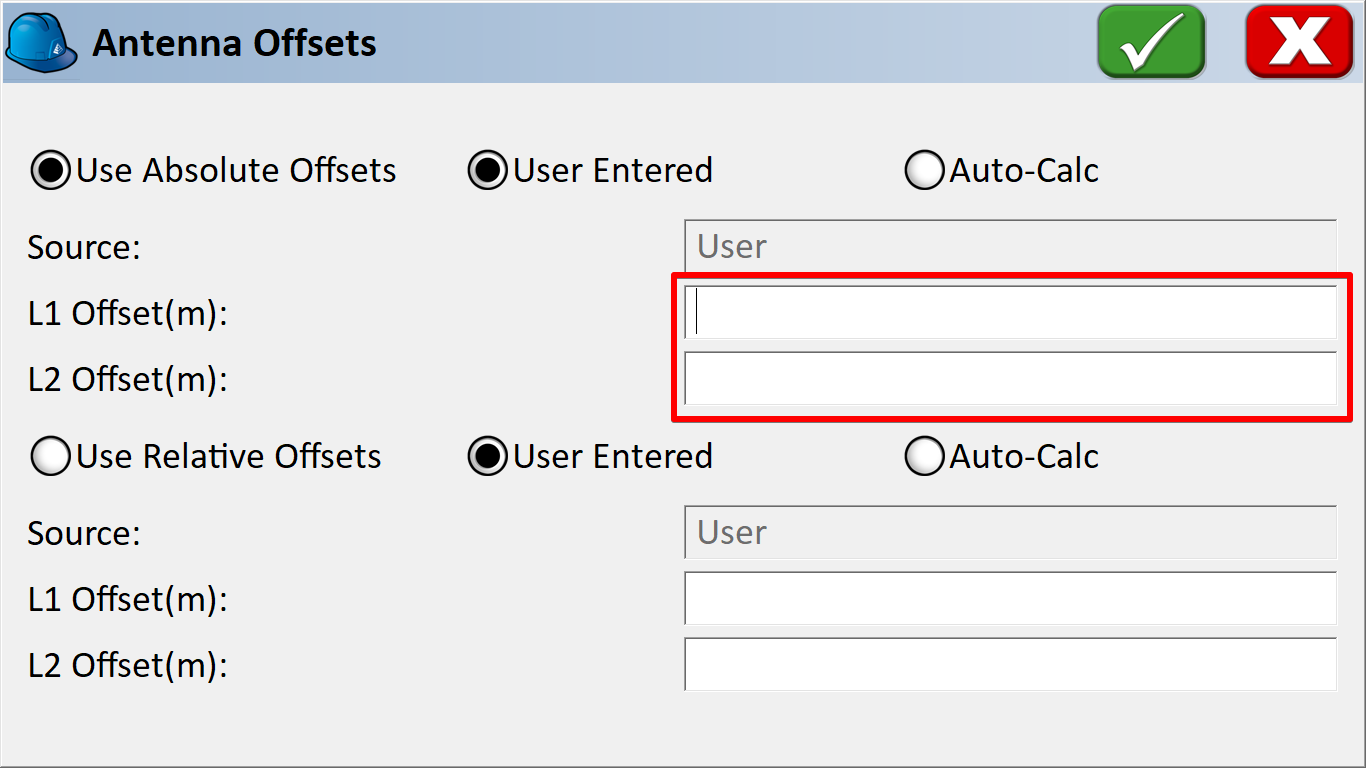

- Then go to Receiver and click on the Antenna type icon.
- Click New in the opened window
- Specify the antenna offset in both L1 and L2 tabs. Antenna offset for Reach RS/RS+ is 0.065m and for Reach RS2/RS2+ is 0.134m.

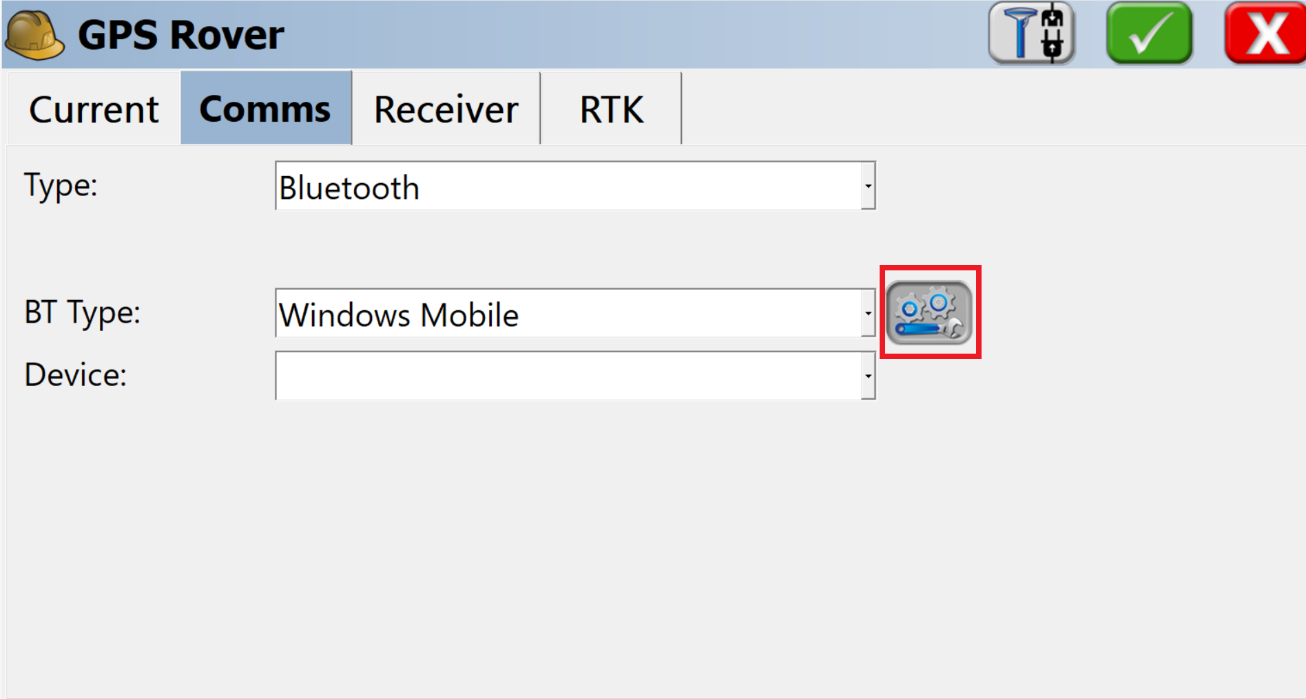

Configuring the communication between SurvCE and Reach

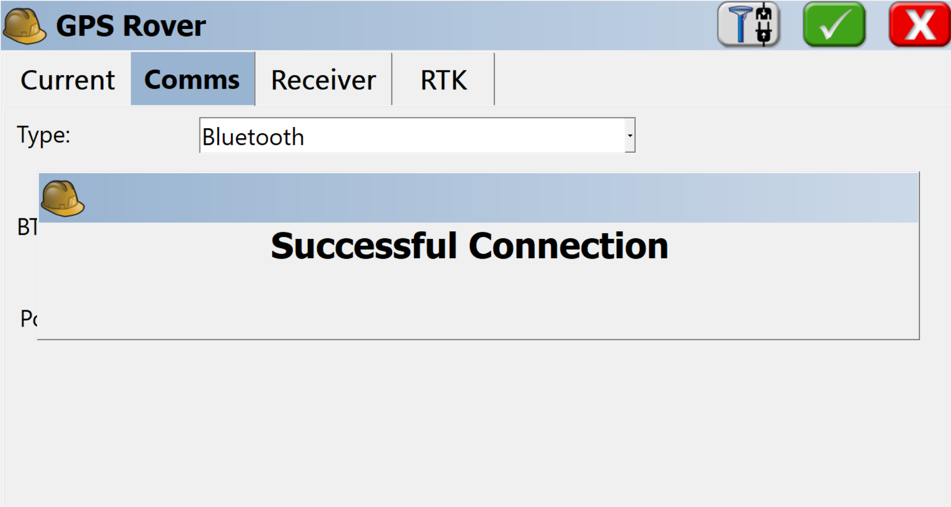

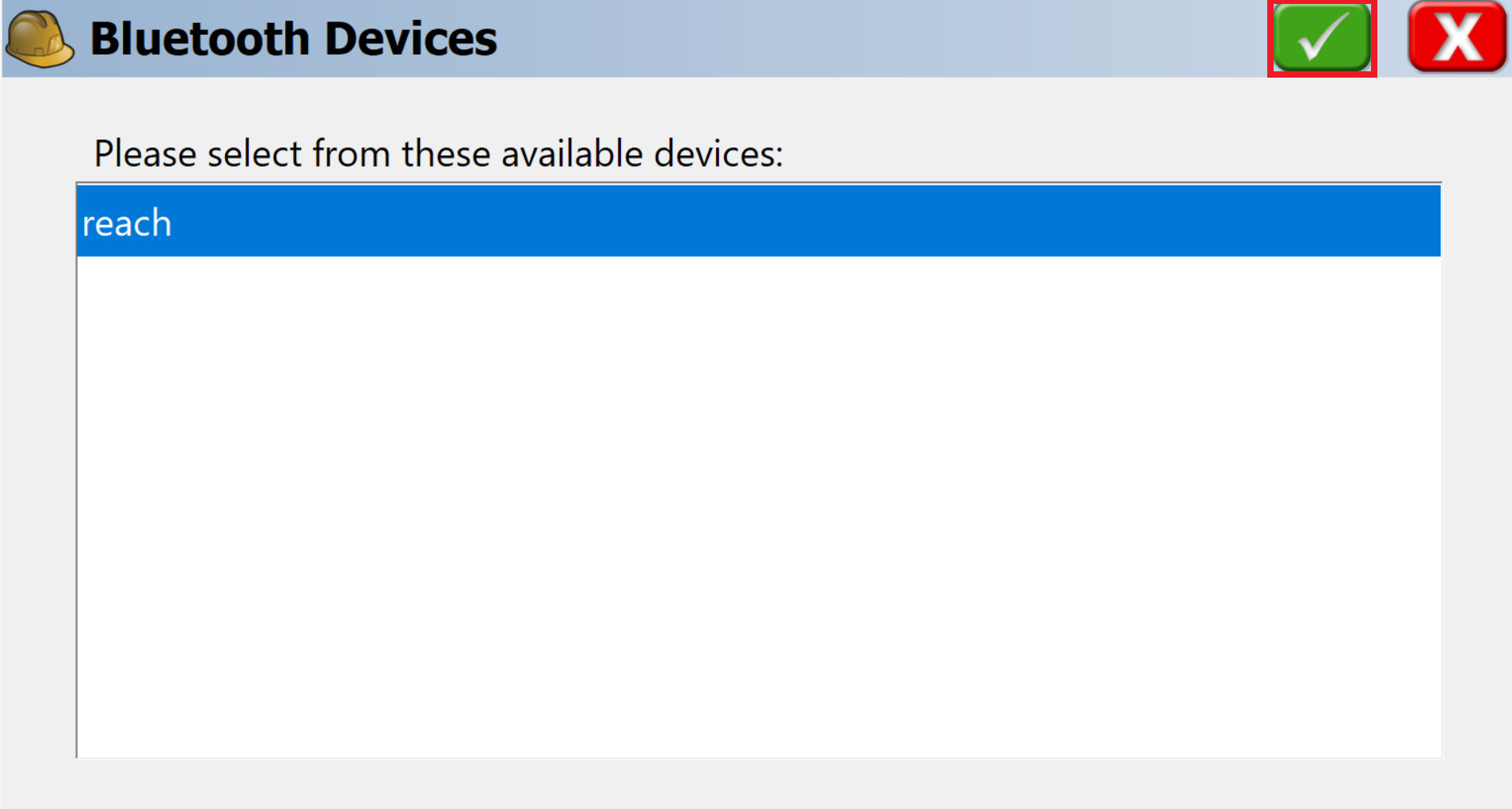

- Proceed to the Comms tab and pick the Bluetooth settings
If you are using SurvPC on Windows system with built-in Bluetooth adapter, you just need to choose Generic BT Type*and select COM port assigned to the BT device:
- In the dialog window, click Find Device
- Once Reach is detected, select it
- Connect Reach and SurvCE
- You will see the confirmation of connection

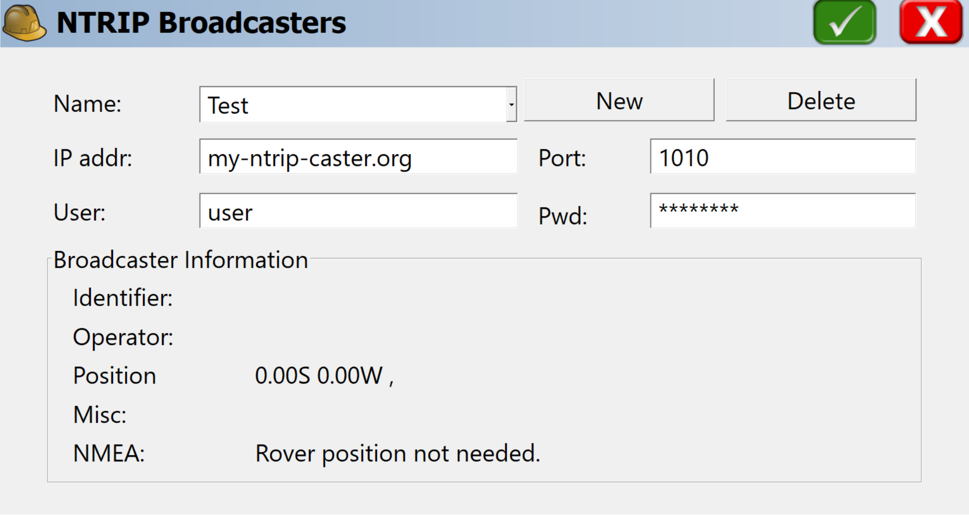

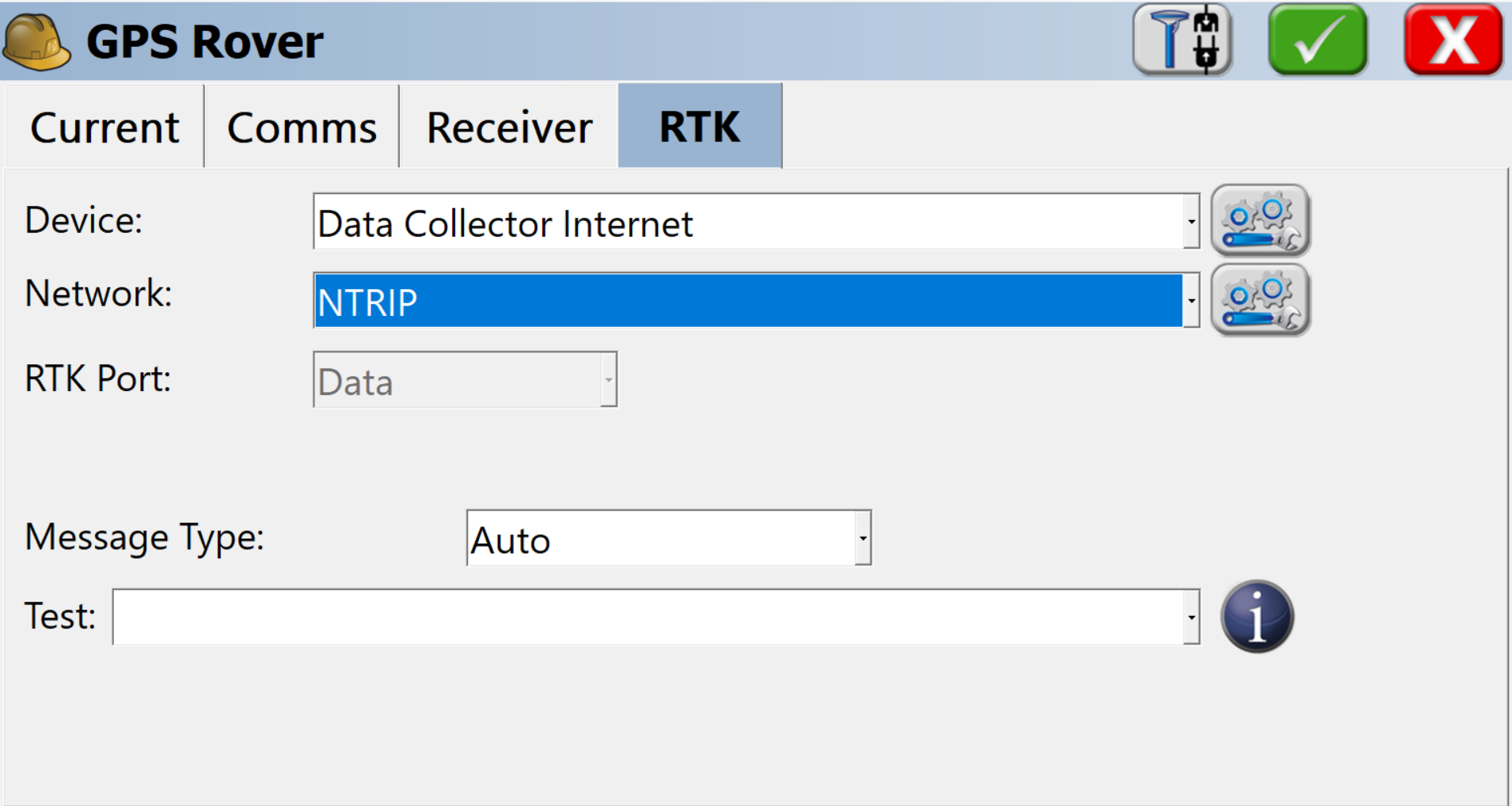

Configure SurvCE to receive RTK corrections from NTRIP caster
- In GPS Rover dialog select the RTK tab. Select Data Collector Internet as a device and NTRIP as a network
- Go to the Network settings and fill in the NTRIP caster details
- After this, select the mountpoint and click on the green tick
