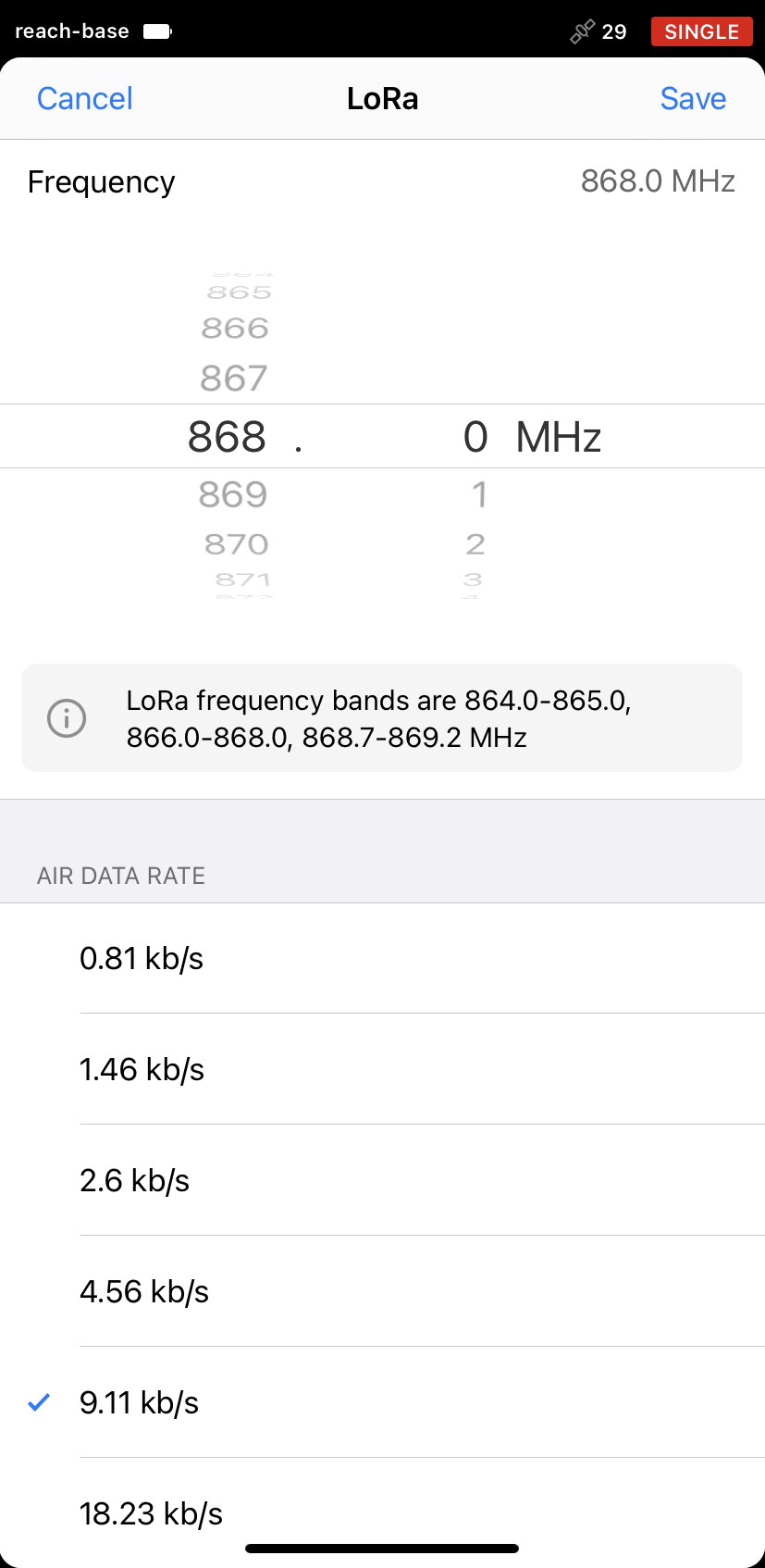

  • Make sure you specified the same LoRa settings in the Correction output tab on the base unit and in Correction Input on the rover
The recommended settings are the following:
  • Frequency is set by default in the app
  • 20 dBm output power
  • 9.11 kb/s air data rate

Air data rate​
High air data rate provides a more stable correction stream that allows transmitting a larger number of RTCM3 messages. Choosing lower values of air data rate on the contrary limits the RTCM3 messages number but may significantly increase the baseline.
The lower the air data rate is, the longer the working distance will be.
  • Check your RTCM3 messages selection in the Base mode tab on the base unit. In case you use GPS and GLONASS in RTK Settings, then the following messages should be enabled:
Reach RS+ base
  • 1002 (GPS L1 Observations), 1 Hz
  • 1006 (ARP station coordinate), 0.1 Hz
  • 1010 (GLONASS L1 observation), 0.5 Hz
  • Test the setup with lower air data rate values: 4.56 kb/s and then 2.6 kb/s
Make sure you changed the air data rate on both base and rover devices:
  • In the Base mode tab on the base
  • In the Correction input tab on the rover
Frequency​
Sometimes allowed frequency range in your working area can be affected by some local factors. That is why it is important to find a frequency that works efficiently for your environmental conditions.
  • Check that you set up the default settings for LoRa mentioned above
  • Double check which frequency ranges can be used in your area
Some frequency bands might not be allowed in your region. These limitations are currently applied automatically in ReachView for some countries.
  • Set up frequency at the highest allowed value
Make sure you set up the same frequency on both base and rover devices:
  • Check the maximum LoRa range you can get with that frequency. If the range is not sufficient, go down with the 1-2 MHz step until you find the frequency that works best for your area
