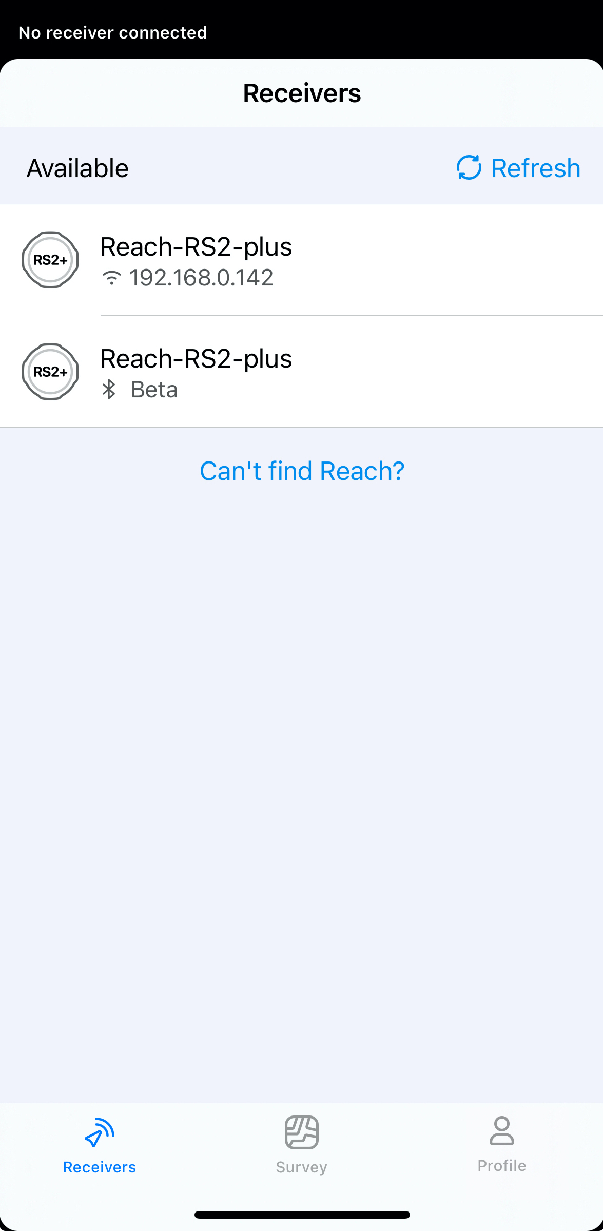

  1. Open Emlid Flow and find your receiver in the list of receivers.
  2. Select the receiver with the Bluetooth icon under its name and wait for the app to connect to Reach.

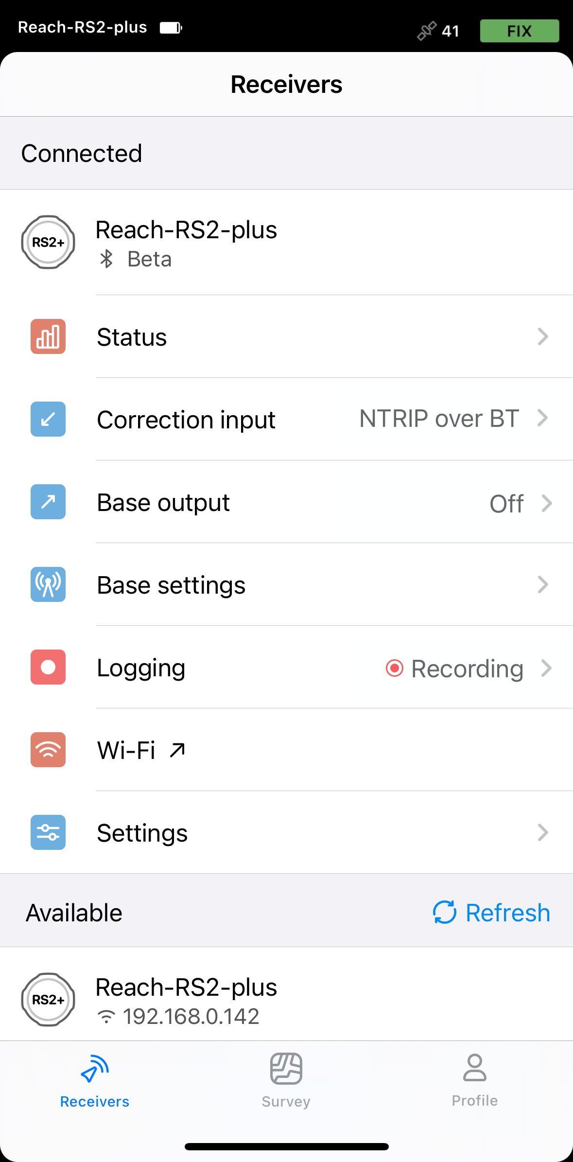

With Emlid Flow you can easily configure your Reach to receive corrections from an NTRIP service over Bluetooth. The app uses your phone or tablet's internet connection to access network corrections and send them to your Reach via Bluetooth.

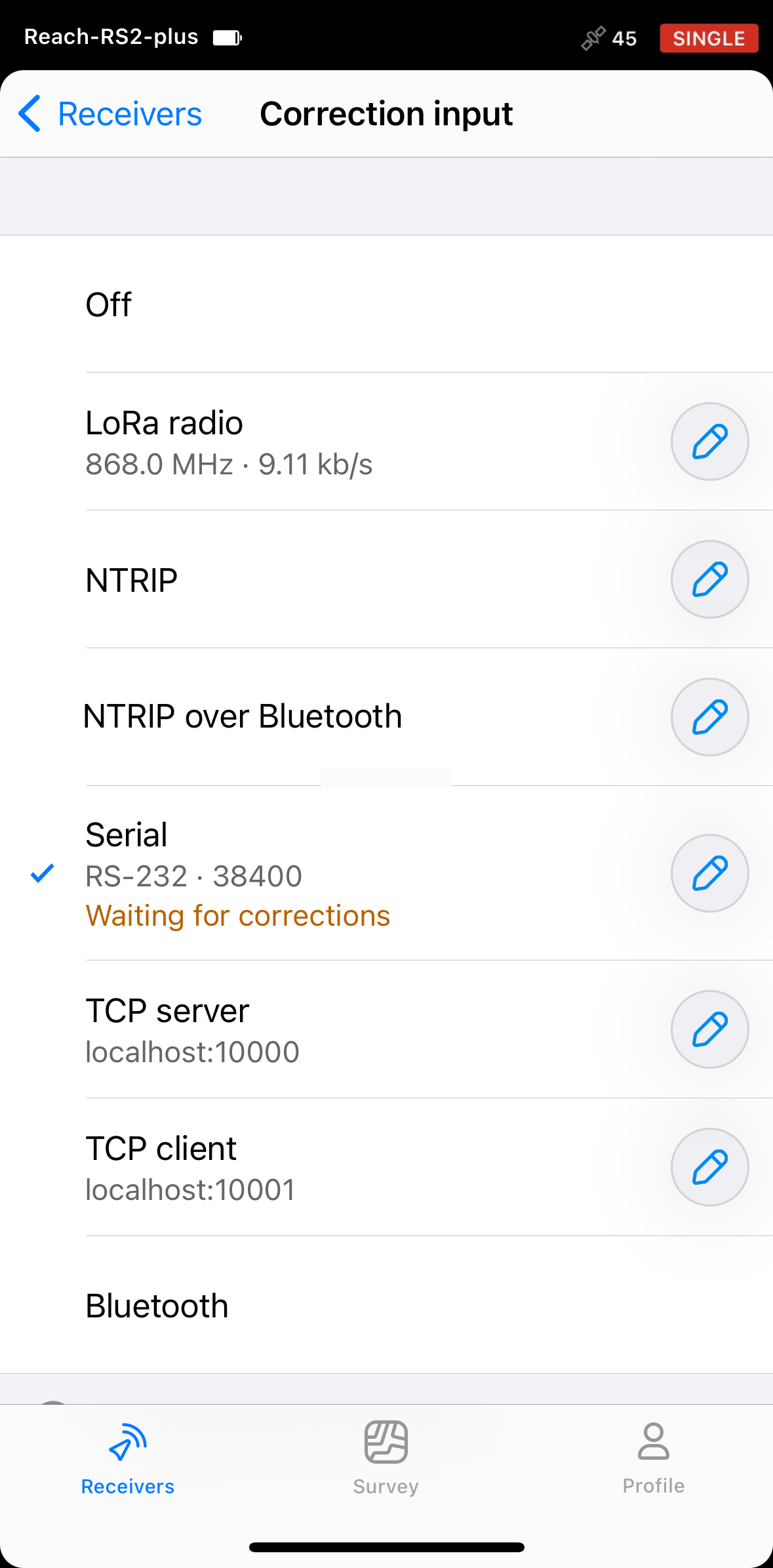

  1. Go to Correction input.
  2. There select NTRIP over Bluetooth instead of the serial input set by default.

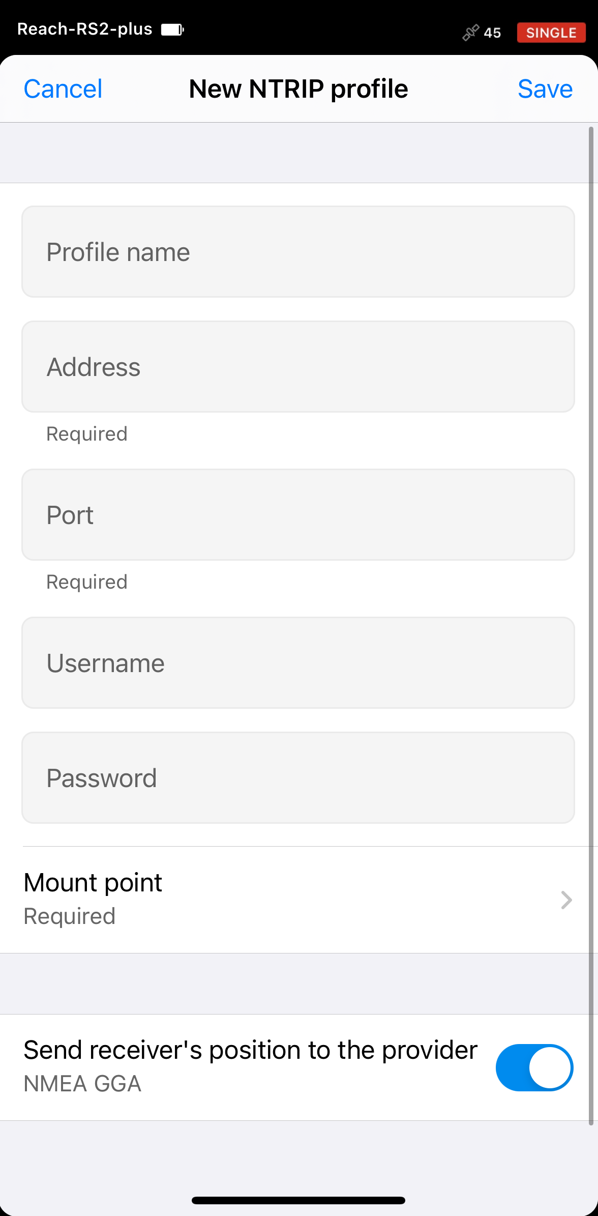

  3. Fill in the credentials of your NTRIP service.
  4. Provide your receiver with an open sky view to start receiving corrections.
